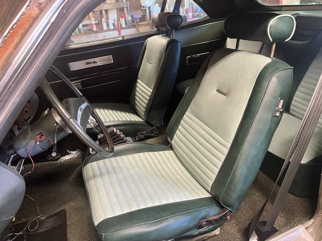

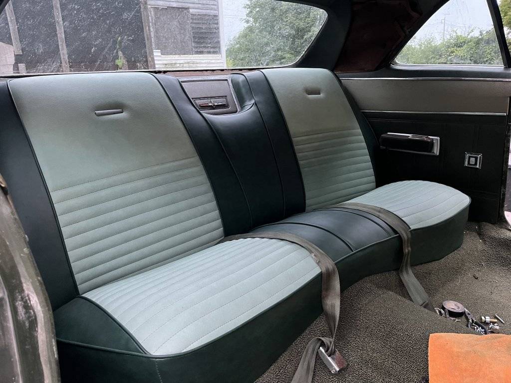

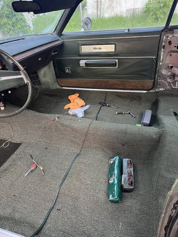

So I got the rear side panels and back seat in. The buckets should be in tomorrow. The panels must have been from a non rear seatbelt car because they were not notched for the seat belt mount so I had to cut them a bit. Then after I got them installed the passenger side window didn’t work so I had to pull it back off and get the window working. All in all a 45 minute job turned into 4 hours.
Well today didn't go as planned, I wanted to get the buckets in and the seat belts. I did get the pass side bucket in and seat belts. The heat and humidity in Michigan today was horrible. So after taking a brake for lunch and drinking a gallon of water I thought I could get the driver side in no problem but when I went to install the power seat would not work so I spent the next 5 hours taking the assembly apart cleaning and back together. It is working now. So plan on putting it in first thing tomorrow.
Finally the seats are in. I’m really happy with it. I have one seat back to repair and a good used one in the works from a member hear.

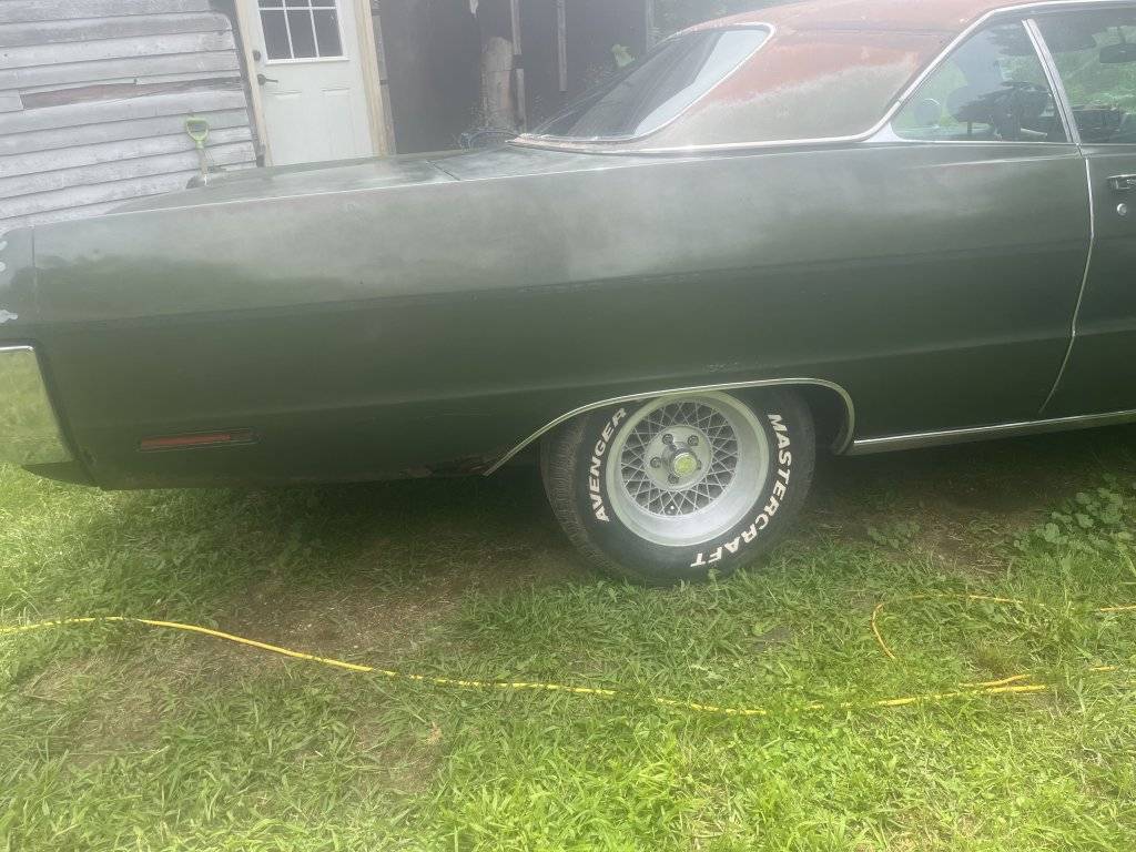

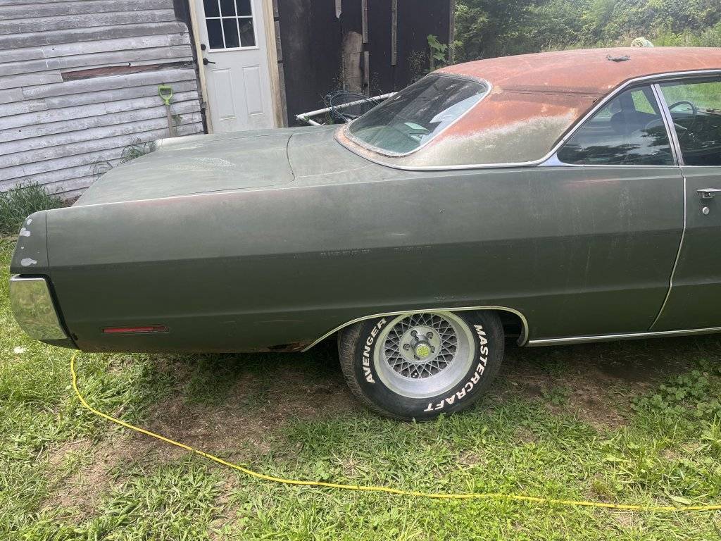

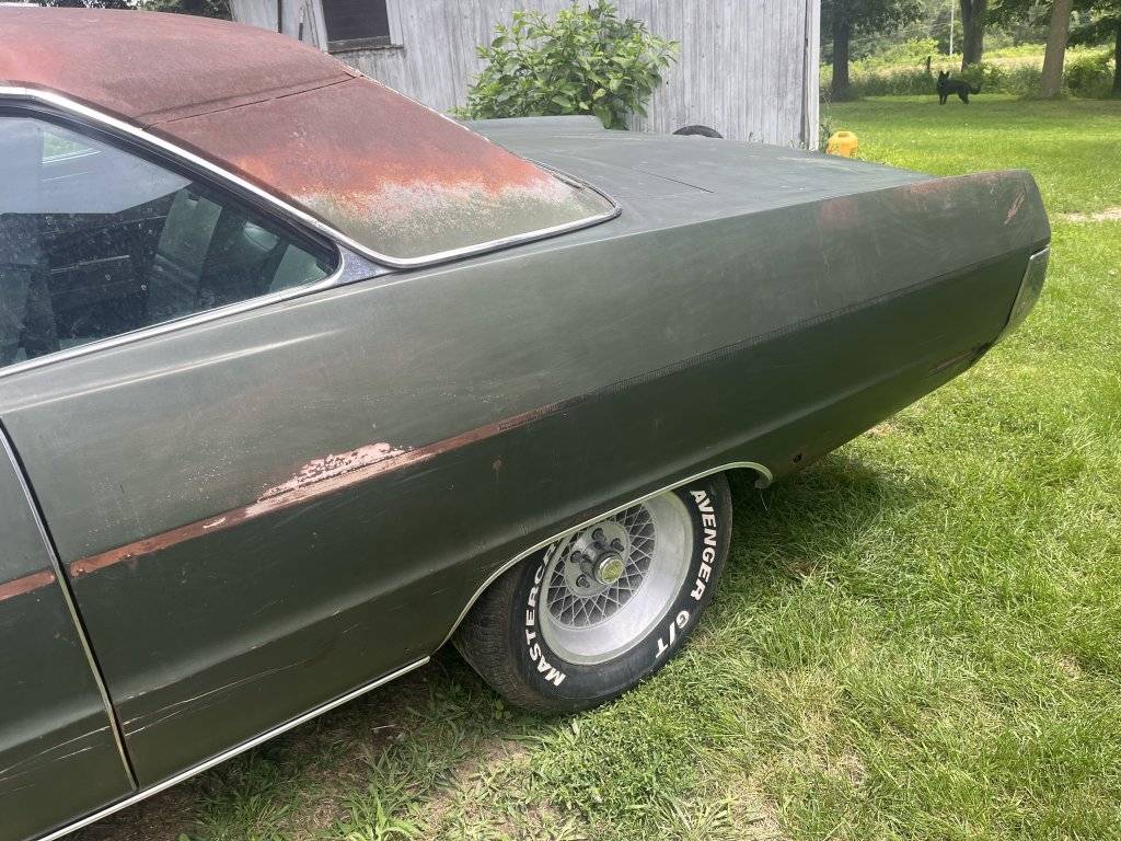

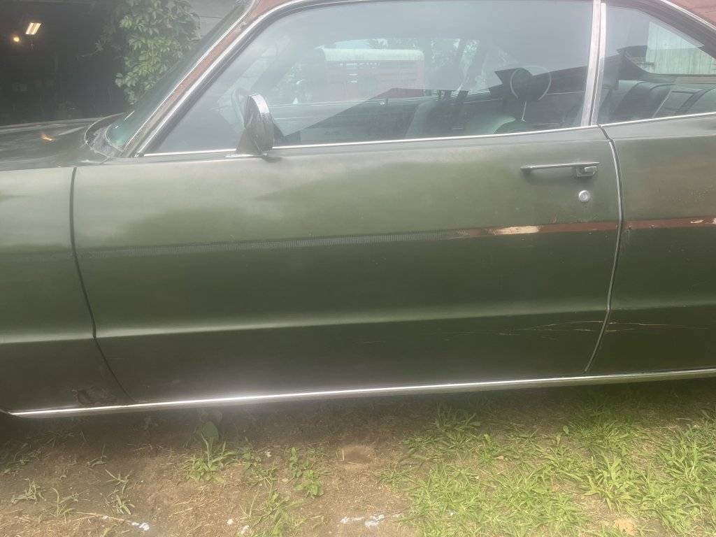

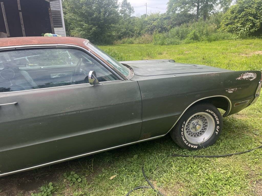

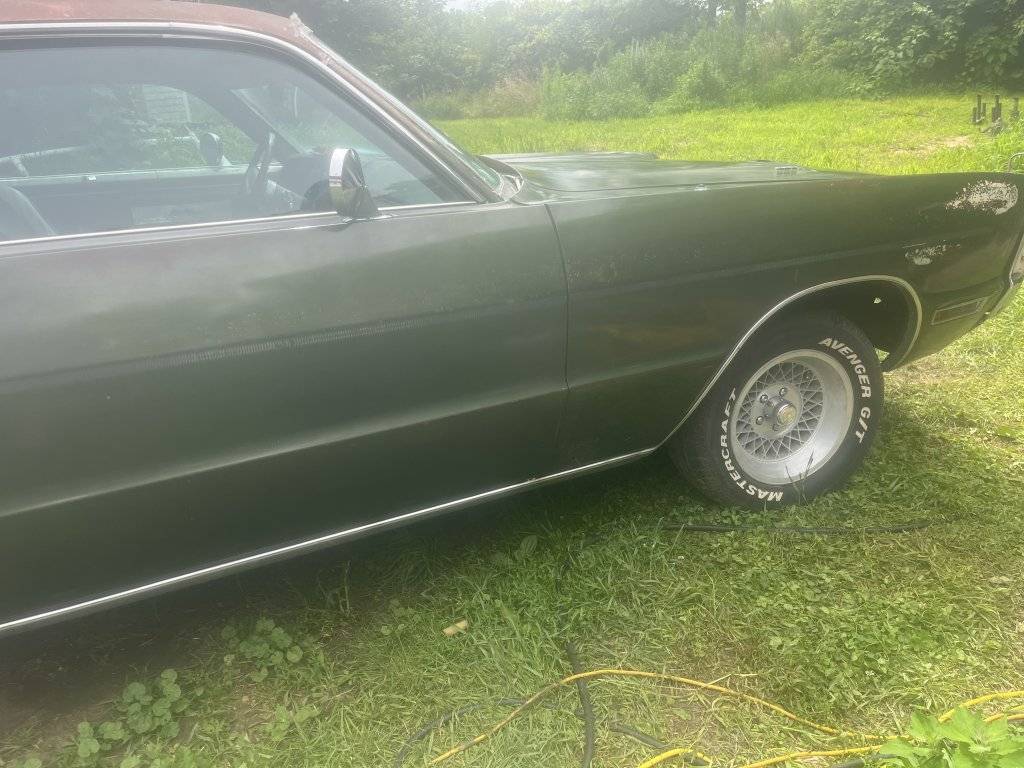

I don’t know if it was worth 5 hours of sanding, buffing and waxing but I do know I don’t feel like I need a tetanus shot after running my hand down the side. Check out the before and after pics below. Lol

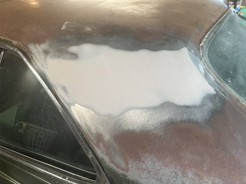

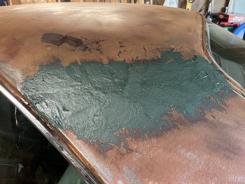

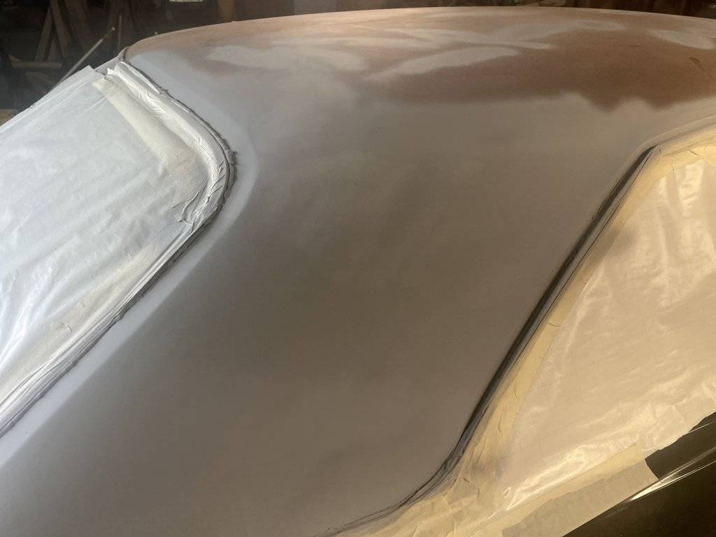

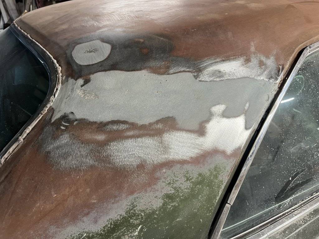

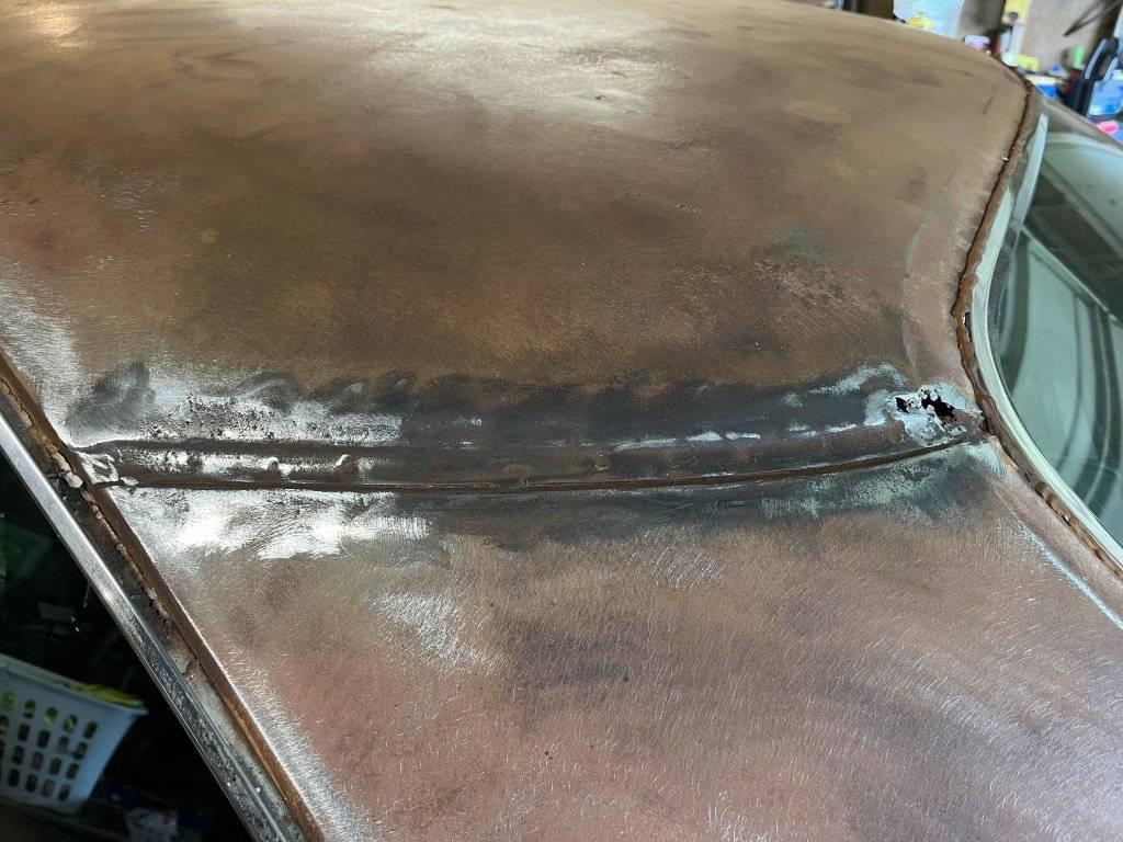

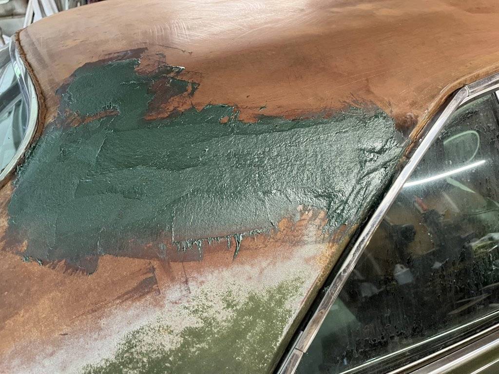

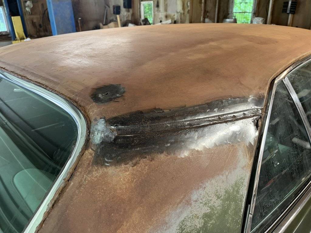

So the rust on the roof was really bugging me because a few spots were close to rusting through and one spot was. I also hated the look of the roof seams. So I sanded the roof down and started filling the roof seams. I first used fiberglass and if it needs it I will skim coat with some mud. I’m going to prime and paint it for now and it will eventually get a white vinyl top after the bodywork and paint is done.

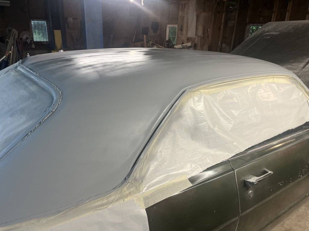

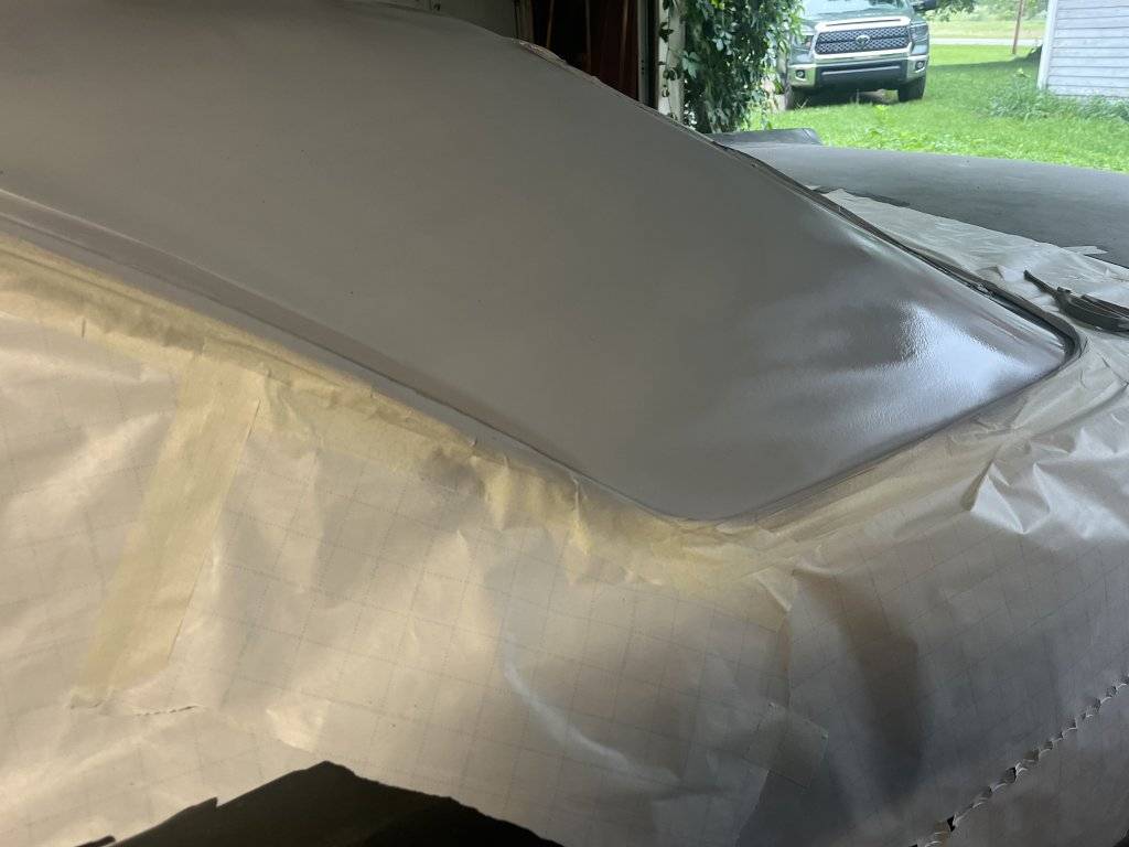

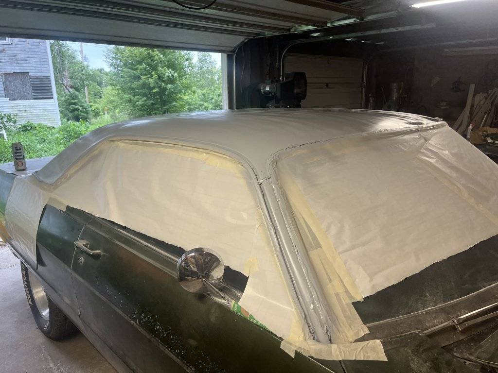

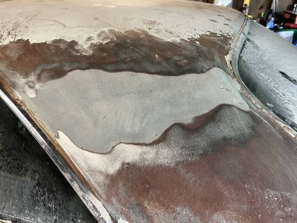

Got some more work done on the top. I tell you I will never again complain that my wife buys to much wrapping paper at Christmas. Lol
A little bit of sanding tomorrow and I should be able to paint the top white.
