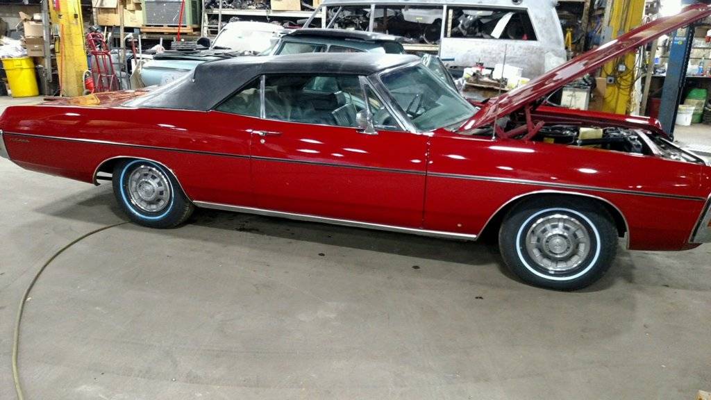

Teaser shot taken Friday night -- picking it up first thing this Sunday. It's getting its final buffing as I write this.
The turquoise car in the background is a 1964 Dodge 880 being parted out.
Those old paint jobs really take to shining up! Urethane base/clear coats just don't do that it seems.
