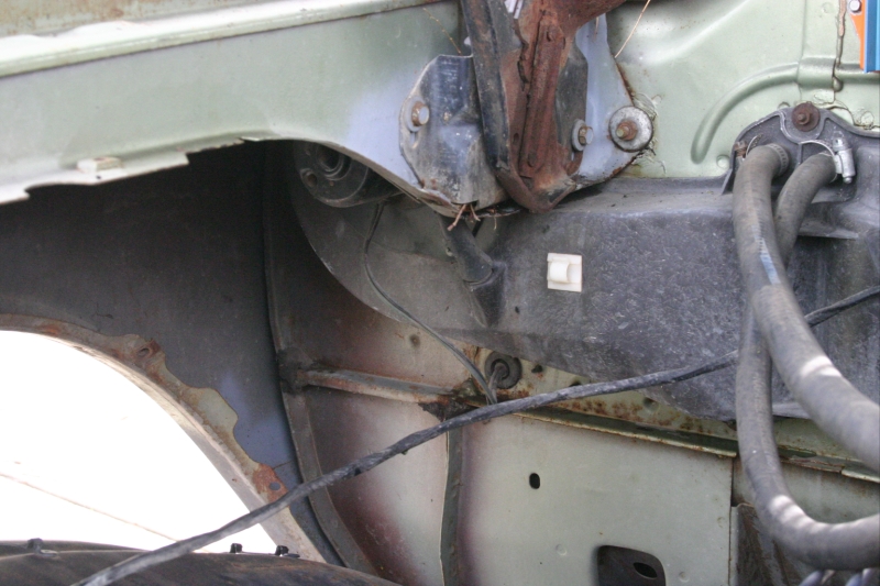

This shows the fan, to take the cover off you need to pull the wheel liner (don't bother).

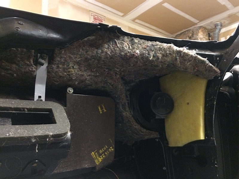

Although this is an AC unit the heater one is probably similar. This shows the strap to the top of the box.
