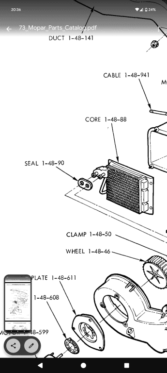

This is a formidable document, lol. But I think I found the core. Thank you!
Don't depend on that pic to be correct. It might be, but they used a lot of generic pictures. What I'm sure @CBODY67 meant is for you to compare part numbers between the models.
So, go to section 1-48-88 and take a look at the part numbers. Once you find that part number, google it with the word "Mopar". That may give you some info too.
