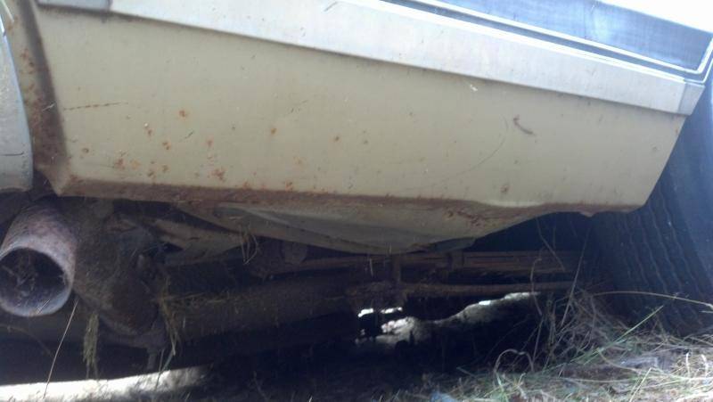

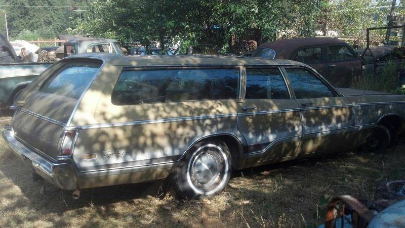

Thanks all... truly a great site for those who appreciate the need for sheet metal. So... went weed wackin, sprayed wasp nest(large) and aired the two rear tires that would hold. Got the moss off, pass rear door still will not open. I was wrong, jambs are not like new, but close as you can get for where it has been. Tore up carpet, no holes... but really soggy. I spent three hours on it today... have yet to talk $. Damn tweakers cut wiring harnesses in engine bay, other parts wagons in yards... I know I will buy, then find a better one. But again, have seen only a few '71s around on the sites and no 440. That is what is driving me...must be saved! It is really a got to be dedicated deal, lotsa work...
View attachment 15655View attachment 15656View attachment 15657
Hey Welcome to the board. Sweet car. And I hope you get it out of there...and back on the street.
I kind of like it with the roof rack missing. Make up a couple delete plates and leave the roof rack off.
I first messed it up with the white, former blue 72; good a couple more wagons come into play.
I pretty much botched editing the pictures. Actually found crushed single snorkel air cleaner base inside the car and what was left of the carb(turned into white powder). Next trip will see if 440 turns over. If the $ is right will change out front tires and take the mess home. :icon_biggrin:
I doesn't look like such a mess. I'm astonished at the condition of the sheetmetal...the spare tire well is nearly always holed with rust. I've restored way worse.
The sheet metal is really nice on the wagon, considering... underneath would be even better if it weren't for the grass. The mess comes after removing trash from the cargo area to find thousands of ants. The wiring harnesses will be replaced with originals. Removing the seats, carpet and a good dose of the garden hose will be a big improvement.

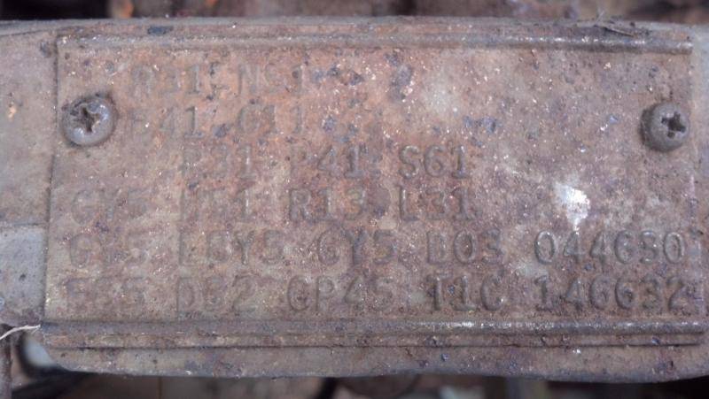

Beautiful original Chrysler station wagon car for restoration. I want to show factory broadcast. Some can not read from the backing plate.
R31 N51
B41 G11
P31 P41 S61
GY5 H51 R13 L31
GY5 L8Y5 GY5 B03 044630
E85 D32 CP45 T1C 146632
R31- REAR SEAT SPEAKER (EXTRA COST - 27,55$)
N51-
B41 - POWER BRAKES (STANDARD EQUIPMENT)
G11 - ALL WINDOWS - TINTED (EXTRA COST - 44,80$)
P31 - POWER WINDOWS (EXTRA COST - 111,55$)
P41 - POWER DOOR LOCKS - 4 DOORS (EXTRA COST - 69,50$)
S61 - TILT AND TELESCOPE WITH RIM BLOW (EXTRA COST- 90,50$)
GY5 – UPEER BODY COLOR (CRYSTAL DAWN METALLIC)
H51 – AIR CONDITIONING - SINGLE (EXTRA COST - 421,05$)
R13 - AM RADIO (EXTRA COST - 92,35$)
L31 - FENDER MOUNTED TURN INDICATORS (STANDARD EQUIPMENT)
GY5 - BODY PAINT COLOR (CRYSTAL DAWN METALLIC)
L8Y5 - TRIM CODE (GOLD) - (OPTIONAL IN EQUIPMENT)
GY5 - INTERIOR PAINT COLOR (CRYSTAL DAWN METALLIC)
B03 - MONTH DAY 10. 11. 1970-71? DOOOR PLATE
044630 - VEHICLE ORDER NUMBER
E85 - ENGINE 440 cu. in. 4-bbl. SINGLE EXHAUST
D32 - TRANSMISSION TORQUEFLITE A727
CP45 - C- CAR LINE - CHRYSLER, P- PRICE CLASS PREMIUM , 45 - 6 PASSENGER WAGONS
T1C- T - ENGINE V8 440 cu. in. 4-bbl., 1 - 1971, C - PLANT Jefferson Ave., Detroit, Michigen, USA
146632 - SEQUENCE NUMBER
