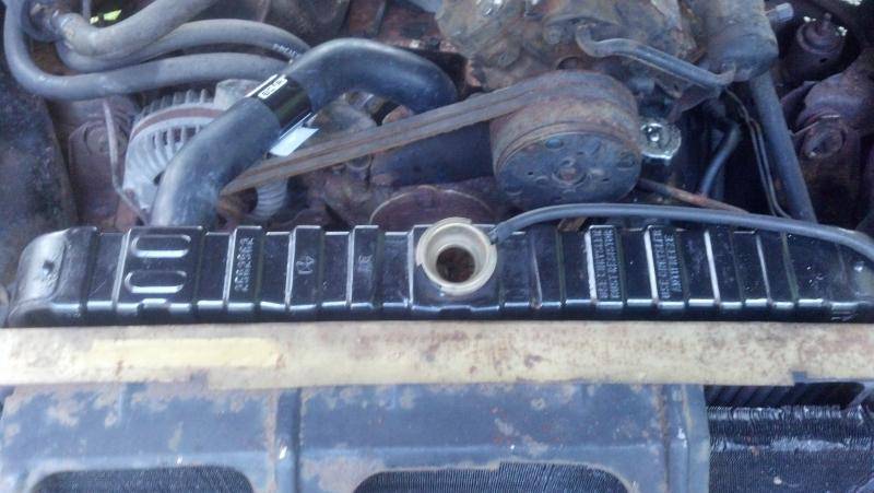

So... with rocker shafts in place, cylinders freed up, two valves unstuck and a $3 pushrod, am liking how she turns over. Got the radiator and hoses lined up, but no shroud. More importantly, wiring harnesses need to be addressed... from headlamps back and from the starter forward. I am going the make another run back to the yard for needed parts. More than likely, will be posting laundry list for wagon under parts wanted...
