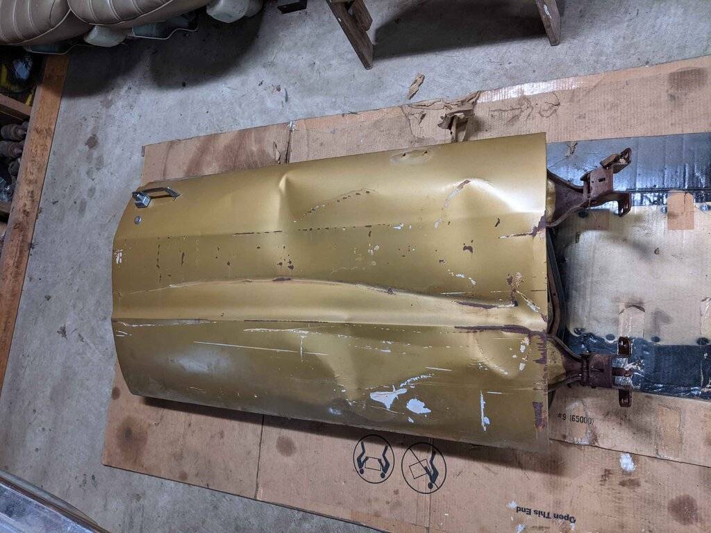

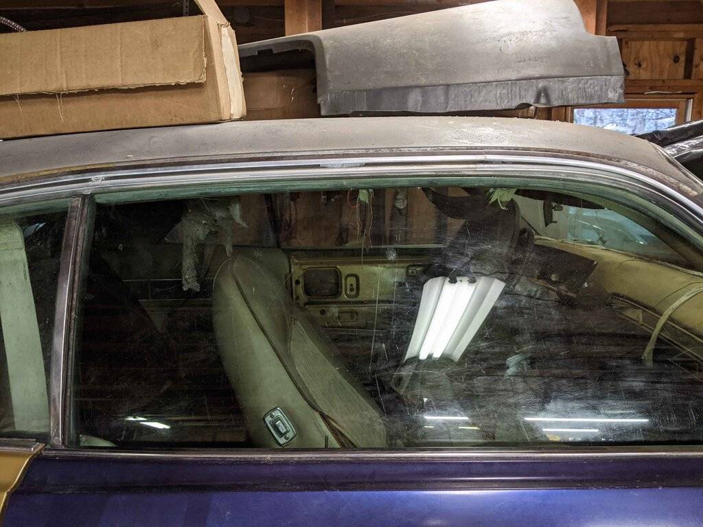

Right Side Door
Why does it have to be replaced?

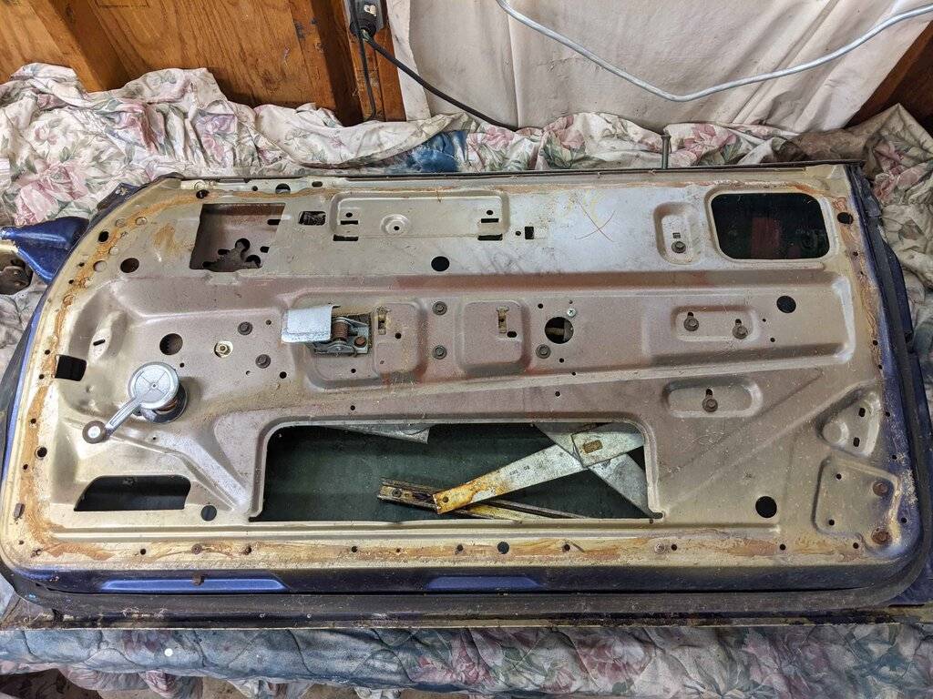

Hollander has different #s for the 1969-70 doors vs 1971, although exteriors are same. I have a rust free 1970 door, so let's see if it will work.
1971
1970 Hand crank window door, no vent window, no significant difference here. (BTW, 1970 vent window 23 body has same Hollander# as non-vent window.) Front channel lower bracket nut visible under door. Rear channel lower bracket is 2 bolts at rear corner.

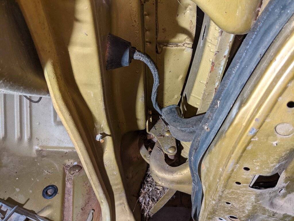

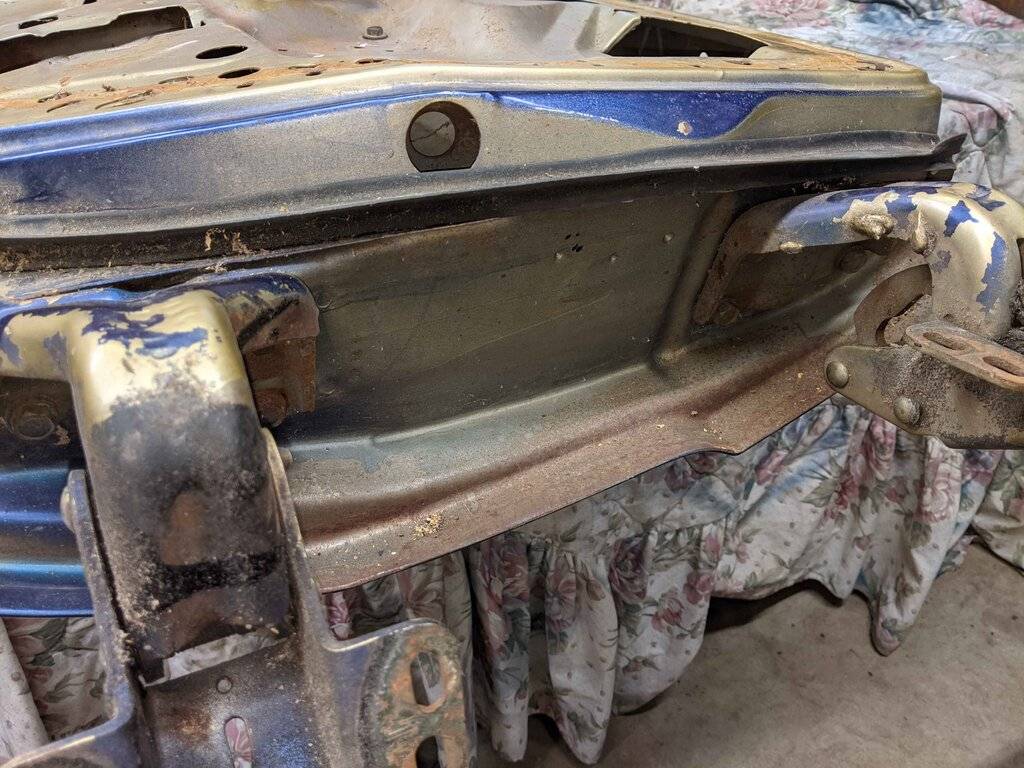

Only difference 1970 to 1971 that I can find: Front of door at hinge mount area

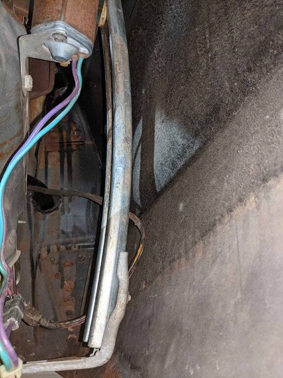

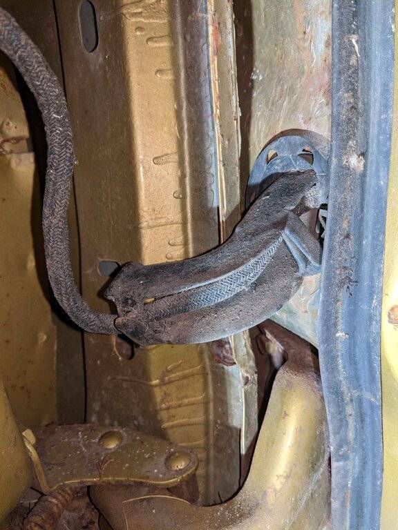

1971 electric window motor wiring

1970

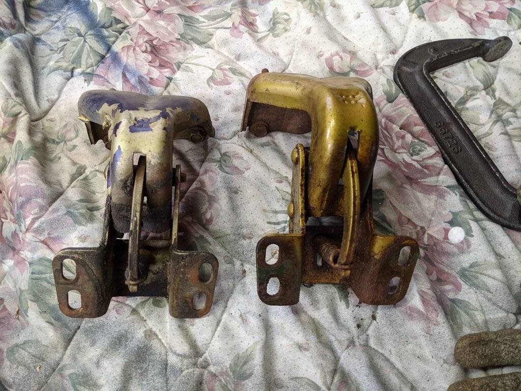

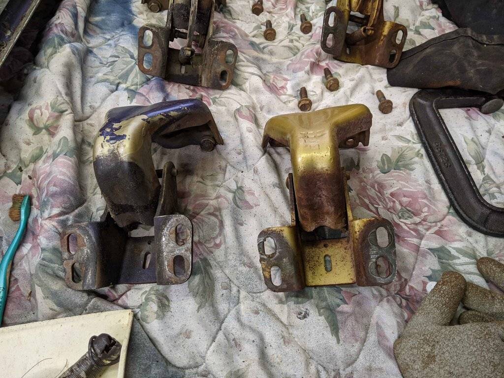

Hollander: 23 body hinges same 69-71 (and later if you're only looking for hinges)
Lower
Upper
Did not reuse 1970 hinges. Press pins were coming out of the lower, and the upper had side to side rock. 1971 Hinges were usable.

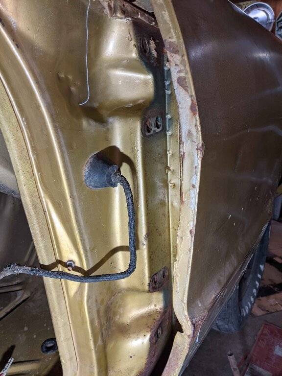

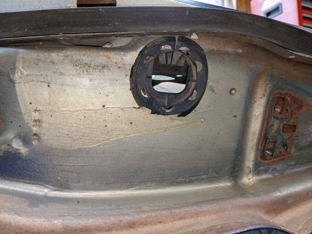

How to replicate 2 inch wire guide hole. I took measurements from the top of the lower hinge and the side of the pinch weld for the weatherstrip mount. Center point was 3.75" above lower hinge and 1.25" horizontal outside pinch weld. Drilled 1/8" holes in a 1"radius. I was going to use my jig saw with the holes as guide/turning points, but the chuck broke. Drilled 1/2" holes 1/4" inward from the circle. Trued edges with 1.375" grinding wheels that I mounted on my drill.
Grommet for wire guide
Wire guide. Screw installs thru slot on interior side of door.
Hinges: Used flat blade screw driver to scribe the top and corners of the hinges as seen in pic. Mounted 1971 hinges on 1970 door. Couldn't find a torque spec in factory shop manual. With 9/16 head, 3/8 thread bolts, 25 foot lbs is usually safe for old metal. Used 25'lbs.
Hinge mount at body. Undamaged. Thank goodness. Our hard luck car caught a break.

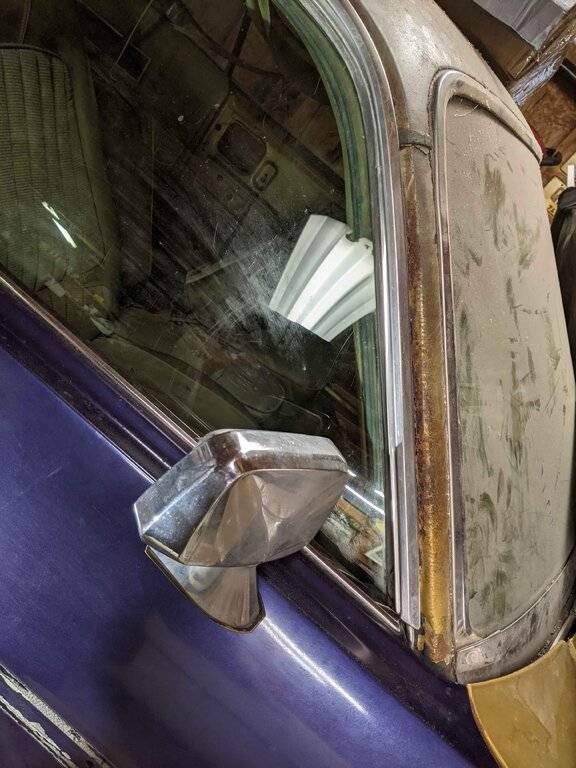

Body lines OK after adjustment to the striker pin position. Drilled holes for 71 side mirror and installed it prior to installing door or glass. Used 1970 door handle and latch. 1971 door handle: someone had ground the rear to make it fit against the door, but fit was poor. 1971 latch: I stripped 2 mounting screws trying to get it out. 1971 Door lock cylinder: transferred to 1970 door. Hope it's original so the ignition key will match when I get keys made.

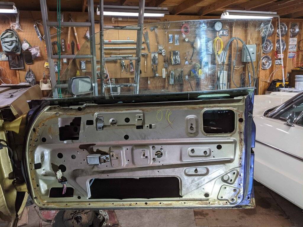

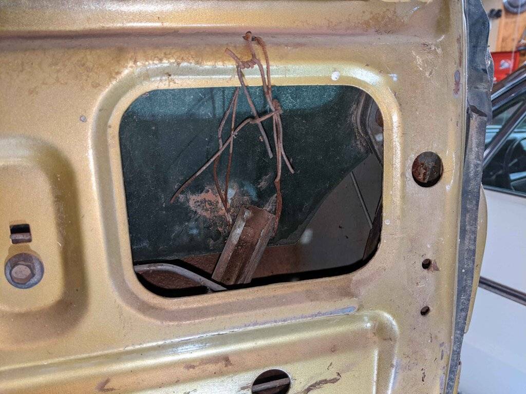

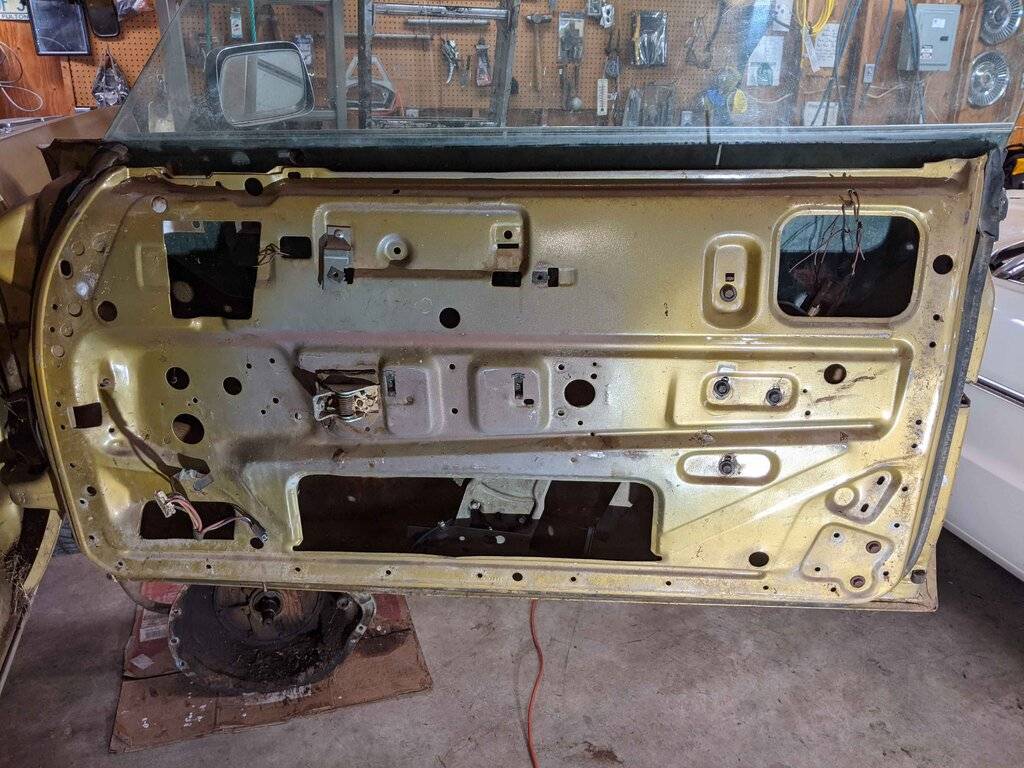

1971 RS Door Glass
1971 Door shell. Glass wired into up position. Horizontal window channel hanging from rear mount. Now we know why it didn't fit against door weatherstripping. With assistant holding glass up, cut wires front and back. Remove front channel fasteners. Removed glass and front channel.
Test fit glass against weatherstrip/door frame. 1971 23-body door glass is 1 year only per Hollander. In another stroke of luck, the glass and channels survived the accident (or were correctly replaced in a severely damaged door?)

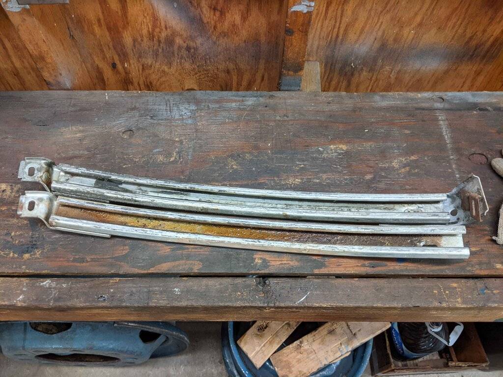

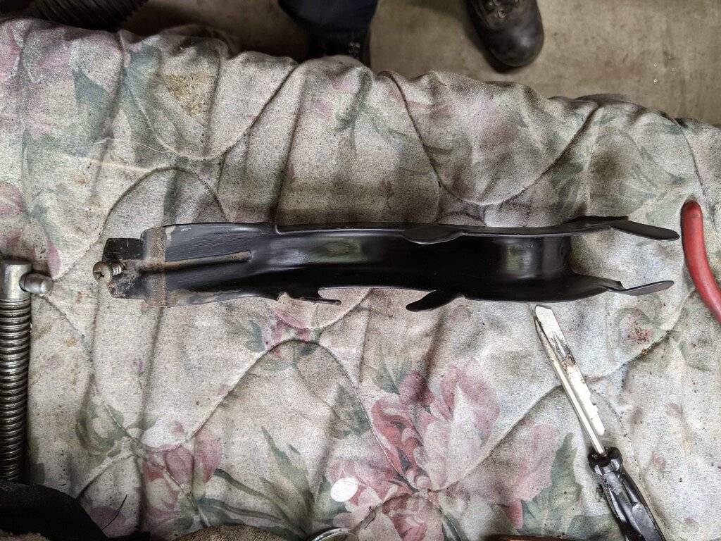

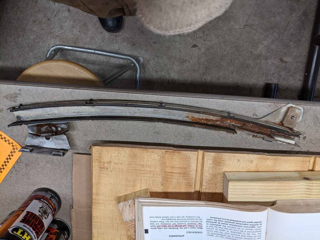

1971 door glass. Black squares are front channel slides. Hole behind them is where window channel (semi horizontal) mounts at front. Plastic fitting MIA. Got one out of 29-body glass in 1970 door. (Channel: later in stall process, window channel screws into these plastic fittings. No metal insert in the plastic, so had to be careful). Tan fitting at lower rear corner is rear window channel mount. Before install: Windex. Removed 43 years of dirt. Glass has a few scratches but OK.
1970 and 1971 window channel: same. I used 1971. Important: channel installs with electric motor and levers. Do not attach to glass before inserting glass into door.

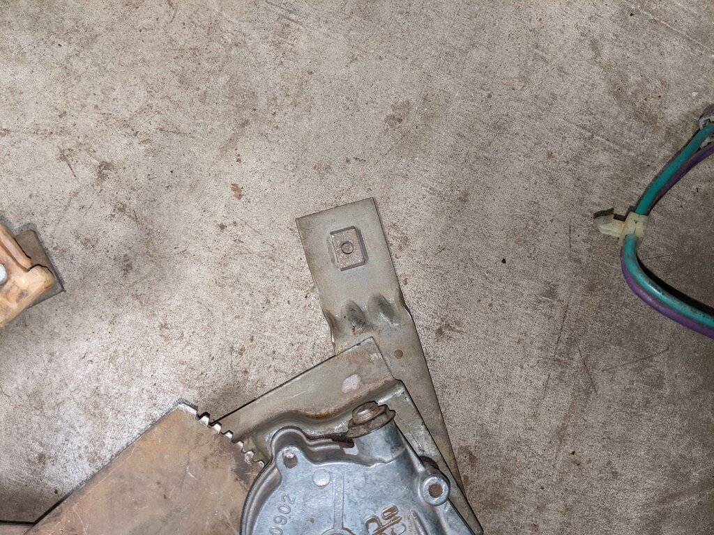

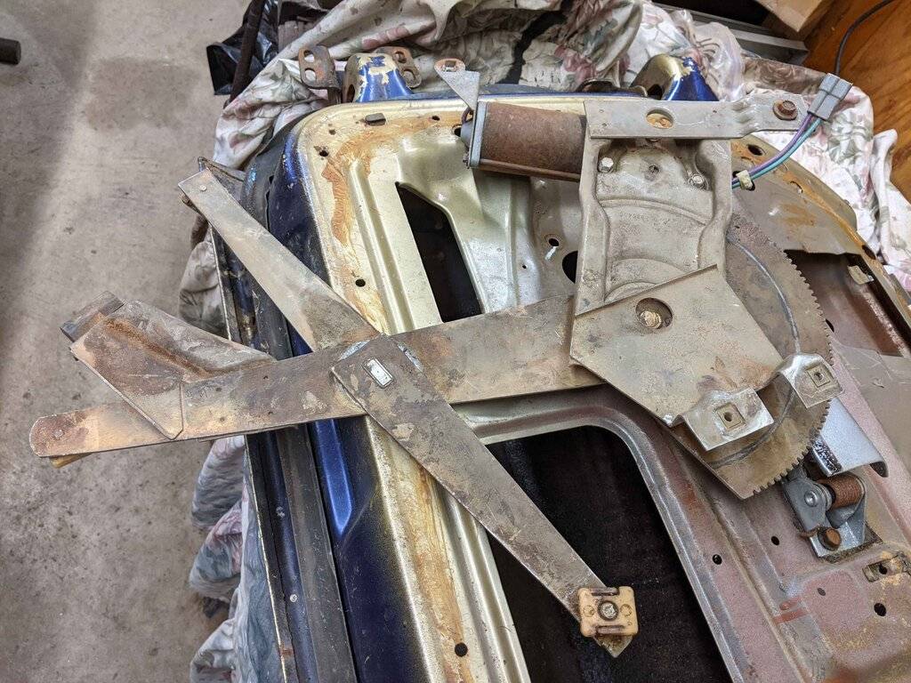

RS Door Electric motor and levers

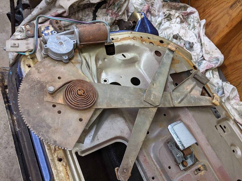

1971 motor and levers were laying in the bottom of the door. Attachment bolts missing. 1970 hand crank attaching bolts are same, so I had ready supply. In 2 pictures below, motor is not engaged with crescent gear. That's how someone left it.
Both arms are effectively spring loaded.
I clamped this upper mount in a vise and had an assistant hold the levers down while I installed the motor.
Counted teeth above the bracket on behind the motor on the driver side. Finger feel count. This is final up-position. 1 large tooth and 1 small tooth above bracket behind motor. Installed semi-horizontal window channel on the 2 upper slides in picture below. With 2 helpers holding glass in up-position, I installed window motor assembly, 4 bracket mounting bolts and then 2 screws thru window channel into plastic fittings in glass. I had to drill a hole to get a screw driver to the front fitting.

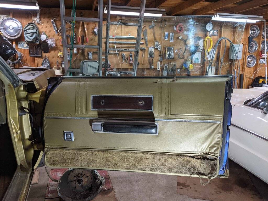

Door Panels
43 years of dirt
Right side
Left side
Right side after vinyl cleaner. This was a beautiful interior in the USA showrooms.
I added the black armrest, because there was no armrest on the door. Door panels are eventually going to some place like Legendary for reproduction. I'll buy a correct armrest then.
