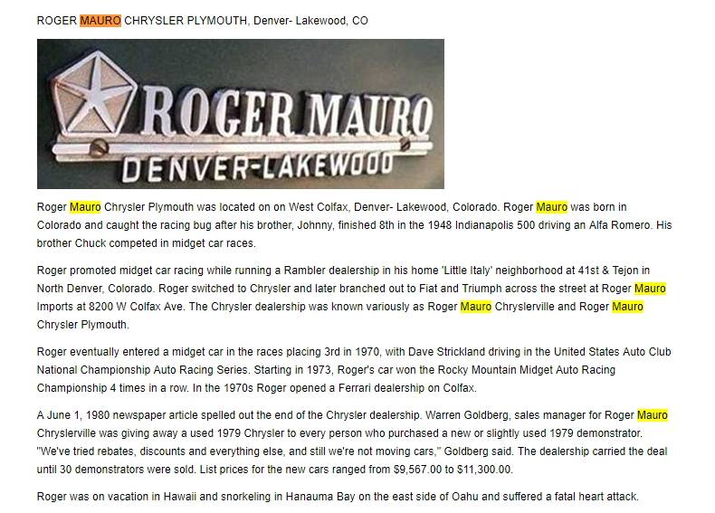

Clues: Roger Mauro Chrysler Plymouth

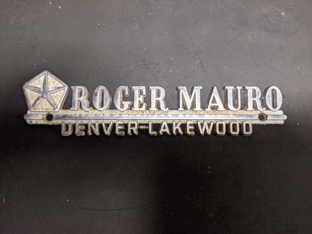

Found this dealer emblem with the parts that came with the car. Colorado origin looks true.
The dealer was in business in 1971. It went out of business Summer 1980. The car went off the road in 1978 or earlier. Mounting holes match holes in trunk lid. If this dealer has any sales records stashed somewhere, I'd sure like to know about it. Could be the new car dealer.
1971 Colorado state patrol sold by Mauro
1971 colorado state patrol 2 door e85 fury 1
1972 Colorado Fury pursuit sold by Mauro
Yes yours apparently came From Roger Mauro Chrysler Plymouth on 7200 W. Colfax Ave. Lakewood. CO. That dealer was relatively new at the time taking over the Chrysler Plymouth Dealer duties that went away from the previous dealer on the same street that my Fury is from.

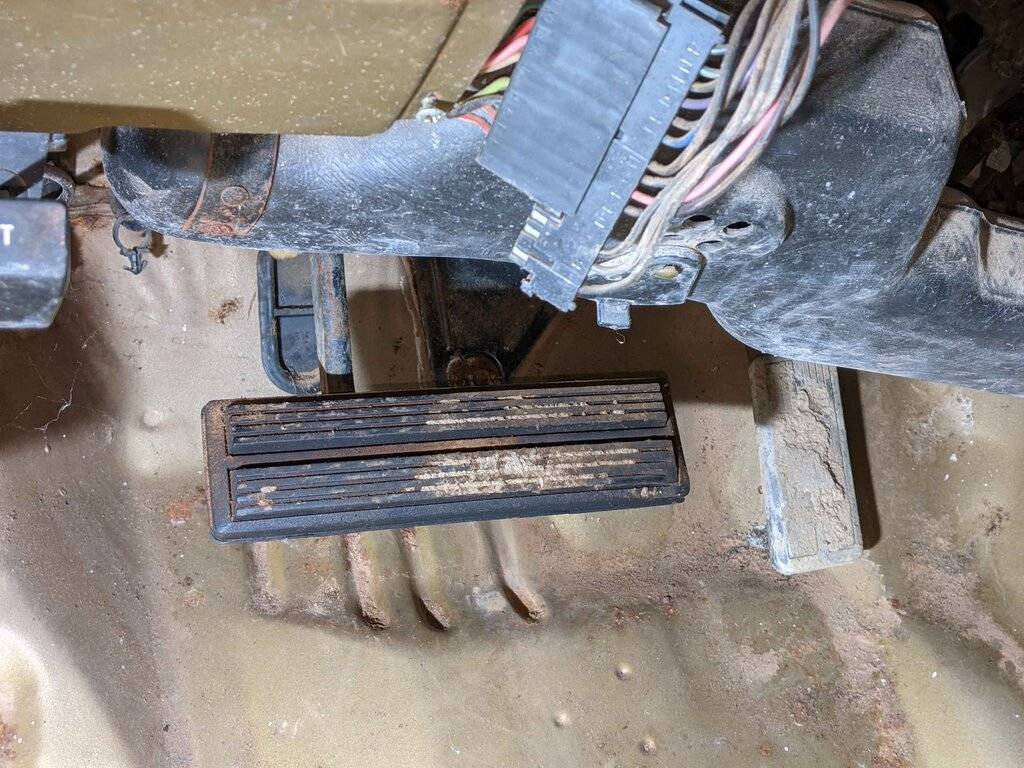

Accelerator pedal

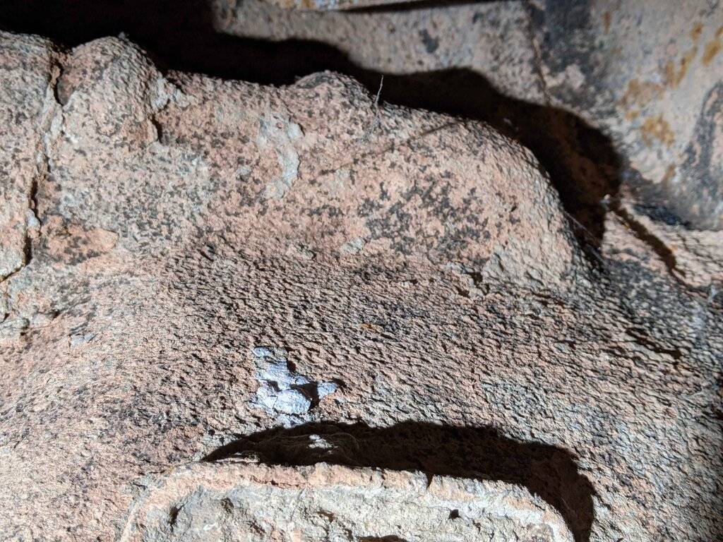

Red soil on bottom of body. Parts of American southwest are known for red soil.

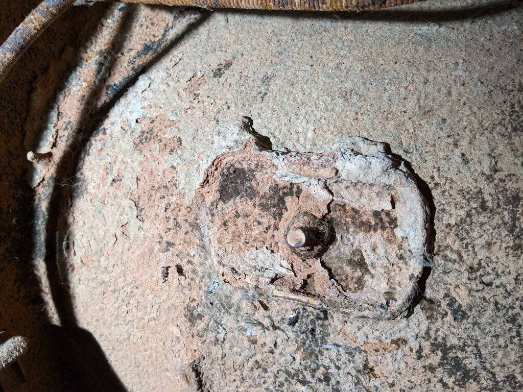

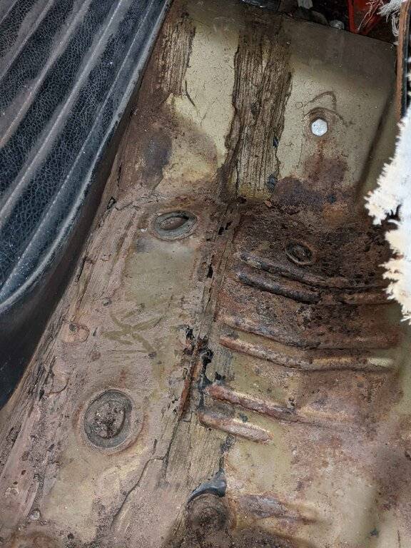

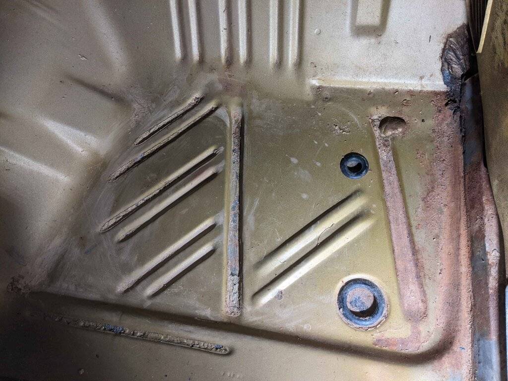

Floor Pans: cleared out passenger compartment. Thought I'd take some pics.
Left front
Right Front
Left Rear

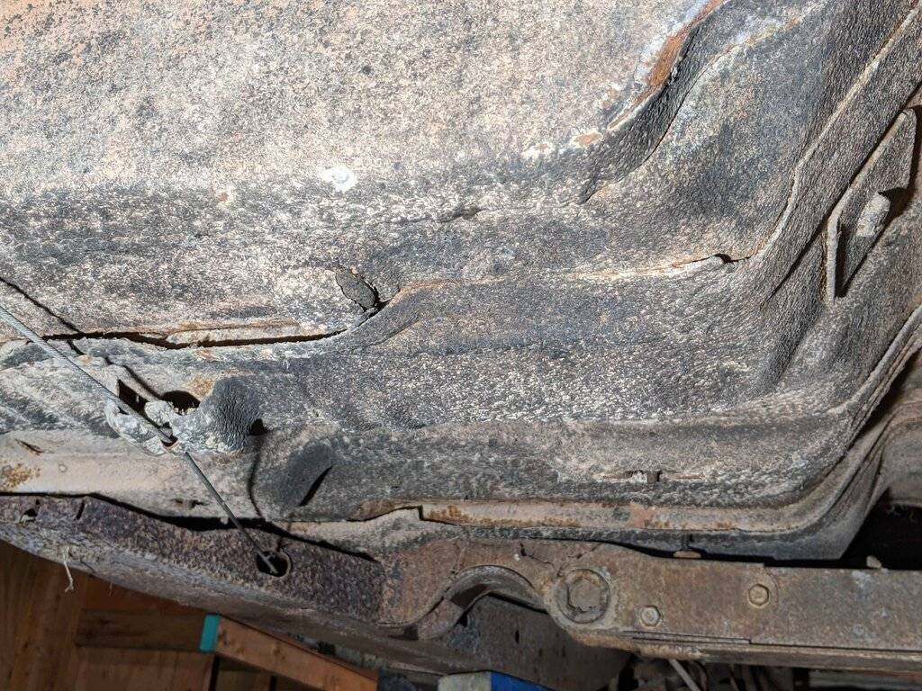

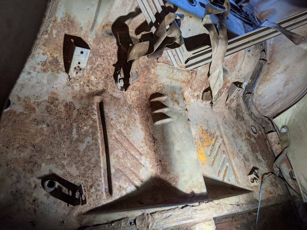

Right Rear: New Mexico farms require irrigation and farmers have to deal with rocky terrain. I think the farmer bottomed out on a rock.
Right rear from below
Left rear for comparison
Rear Subframe looks OK. I'll post more pics tomorrow.

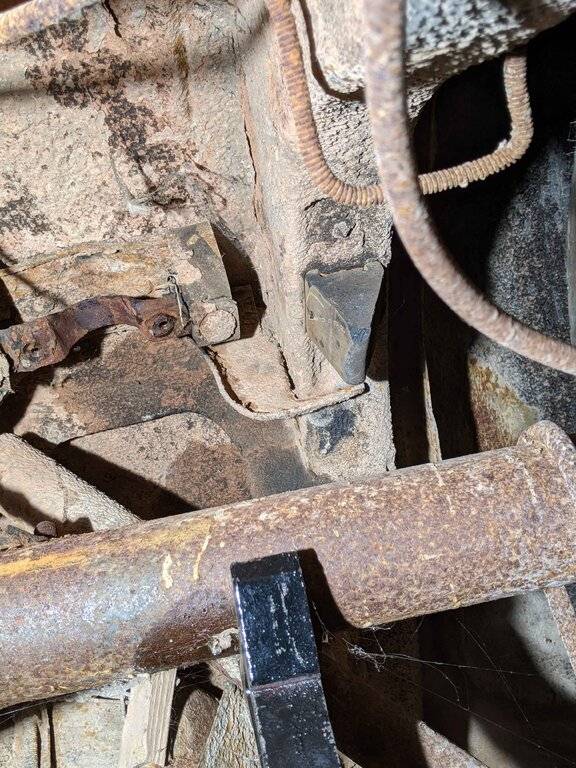

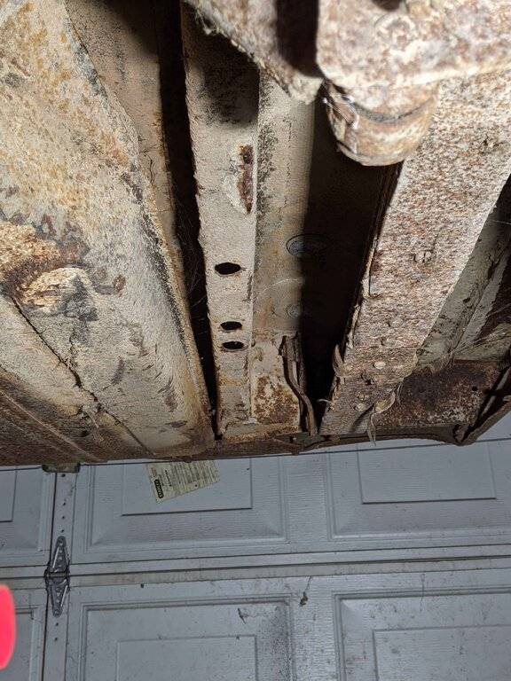

Rear frame rails: straight
Left side
over axle
rear
Right side also excellent
front
over axle
rear. The rock that hit the right rear floor pan and under seat area hit the gas tank, but missed the frame rail. Not having to take the car to a frame shop is a piece of good luck.
In the 1986 Dealer Directory the dealership is listed as
63829 Lakewood Chrysler-Plymouth, Inc., 7200 W. Colfax, Lakewood, CO 80215, orig. date 09-64; principal William W. Dwyer.
Some corporate history:
17 August 1966 incorporated as Lakewood Chrysler Plymouth, Inc.
3 November 1966 trade name Roger Mauro Chrysler Plymouth Co.
5 November 1970 trade name Roger Mauro Chryslerville, USA, Co.
7 January 1998 trade name Medved Chrysler Plymouth Jeep, Inc.
14 January 1998 withdrawal of the trade names Roger Mauro Chryslerville, USA, Co., and Roger Mauro Chrysler Plymouth Co.
John Medved of Medved Autoplex acquired Lakewood Chrysler Plymouth, Inc. in 1998, but was later hit by the 2009 dealership onslaught. As they had kept the same dealership account number 63829 through all these years, it is likely that paperwork from the Roger Mauro period was preserved.
Medved litigated against the 2009 closure, was eventually forced to close down Lakewood in 2010, but succeeded in keeping open his dealership in Castle Rock. So maybe that's the place to turn to.
