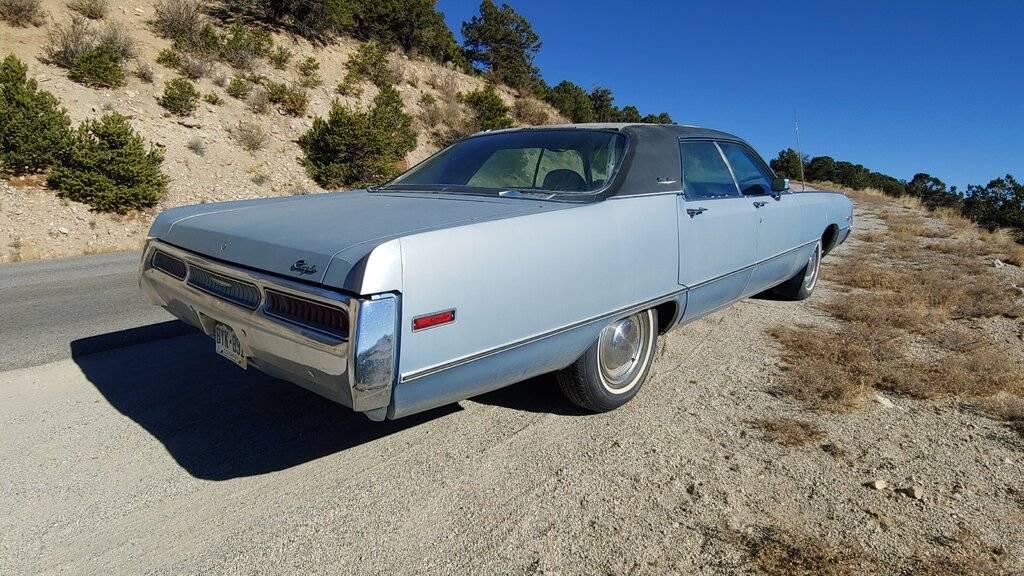

I took him out for his maiden journey yesterday. Drove him to work and back in the rain.
He died as I said when I got to the jobsite but I have a charger and a spare battery on site so it was no big deal. I'm pretty sure my old battery is a bad battery.
This car runs like a top at 80 mph. Smooth as smooth can be.
It's a LOUD car. Hence it's name that I dubbed it, jabberjaw. It's like it's always talking.

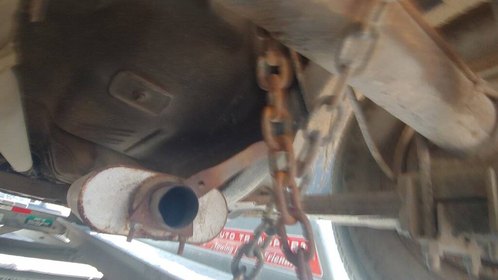

Someone before me removed the resonator at the rear of the car. The muffler is still attached but someone just cut off everything after the axle.
I believe this is one of the next things I am going to do to the car. Fix the loudness of it. I love the loud drone and cackling of my barracuda's, but on my old grandpa car I really don't want it to alert everyone when I am coming down the street.
So, I'm looking for a resonator (I think that's what it's called).
So your exhaust "tip" is at the rear axle, underneath the car? In that case the loudness you're experiencing while driving is probably because of that and extending the exhaust to the rear of the car beyond the bumper could make all the difference you want
Yep that'll do it for ya. Add some pipe to the rear and it should be good. Buddy of mine used to have a car without mufflers or cats so just a straight pipe from manifolds to bumper. Incredibly loud and terrible to drive behind but inside of the car was barely any noise. Most of the sounds exits at the tip and if it's clear of the bumper there is no way for it to reverberate between the road and the floorpans.

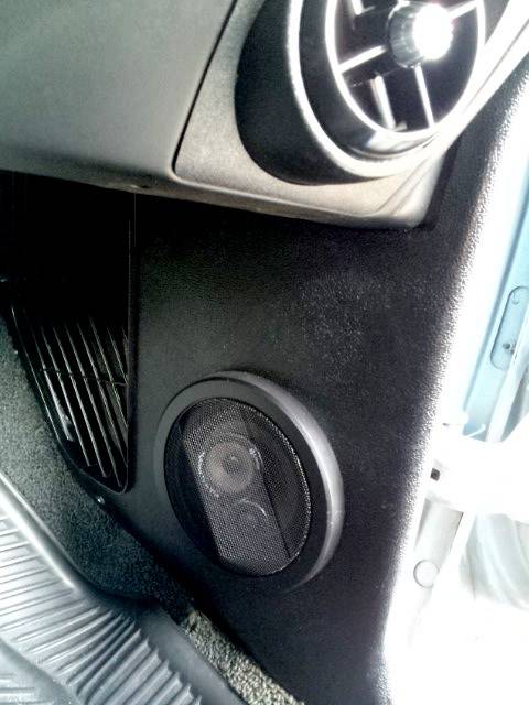

@cuda hunter That used to be my car man. I have lots of photos. I installed those speakers in the kick panels.
Cool! @rds
