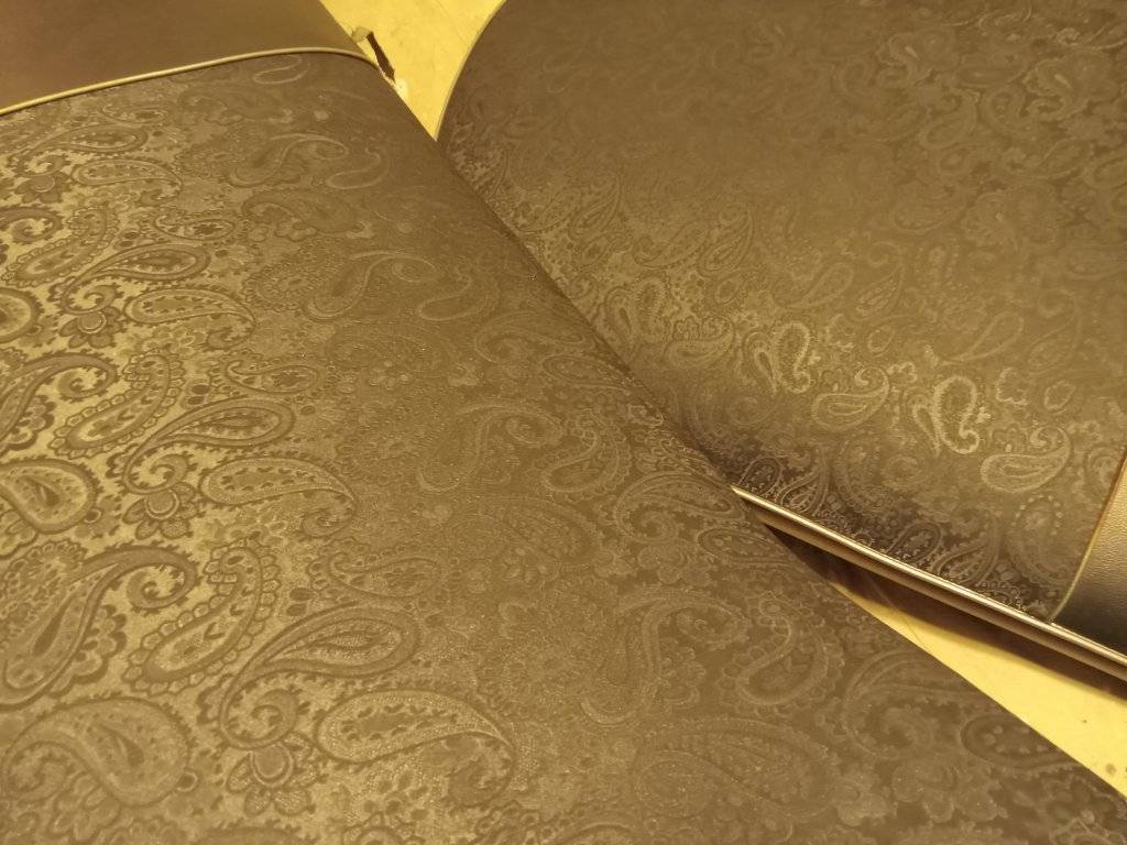

@The Rum Cove -- what I find especially interesting in your tag is the interior code. I see D2XA. XA means charcoal interior, which is clearly what I see here. But D2 is not an interior code that I see in the Plymouth sales brochures, and the paisley fabric that I see in your photos was not listed in the regular offerings:
The 1970 Hamtramck Registry - 1971 Plymouth Color & Trim Book - Fury
Perhaps this is a specific code for a different/specific interior that was part of the A97 Special Package (discussed here; the same two codes (A97 and D2XA), but very very few other codes, are seen on PE21G1D235430 back in 2015 here)? Perhaps @69CoronetRT can chime in?

Do you have the link, and the code? I do not see that interior either in the Color & Trim Book as seen on the Hamtramck Registry or in the brochure as seen on Fuselage.de (and, for that matter, I don't see a "Custom" model listed in either).
The pattern on yours matches the front bench of the Fury ii:
But the code for the Fury ii cloth-and-vinyl bench would be L1XA -- yet the only XA code for a 1971 Fury ii was L2XA all-vinyl with a different pattern. That is why I am puzzled/interested in the D2XA / A97 question.
The Custom was a mid year economy special based on the Fury 1 and all had the paisley interior. All production figures are lumped in with the Fury 1 so I estimate around 3k sold. You can see the sales lit at www.fuselage.de
