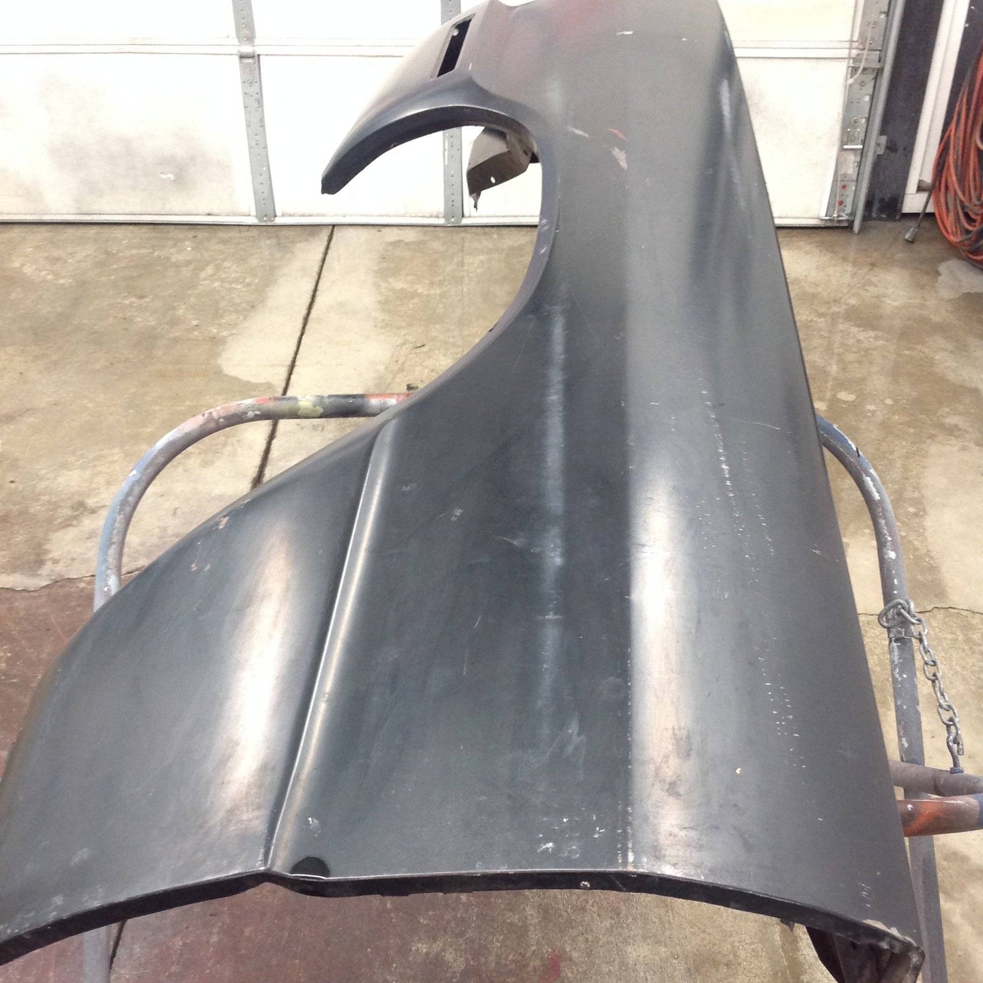

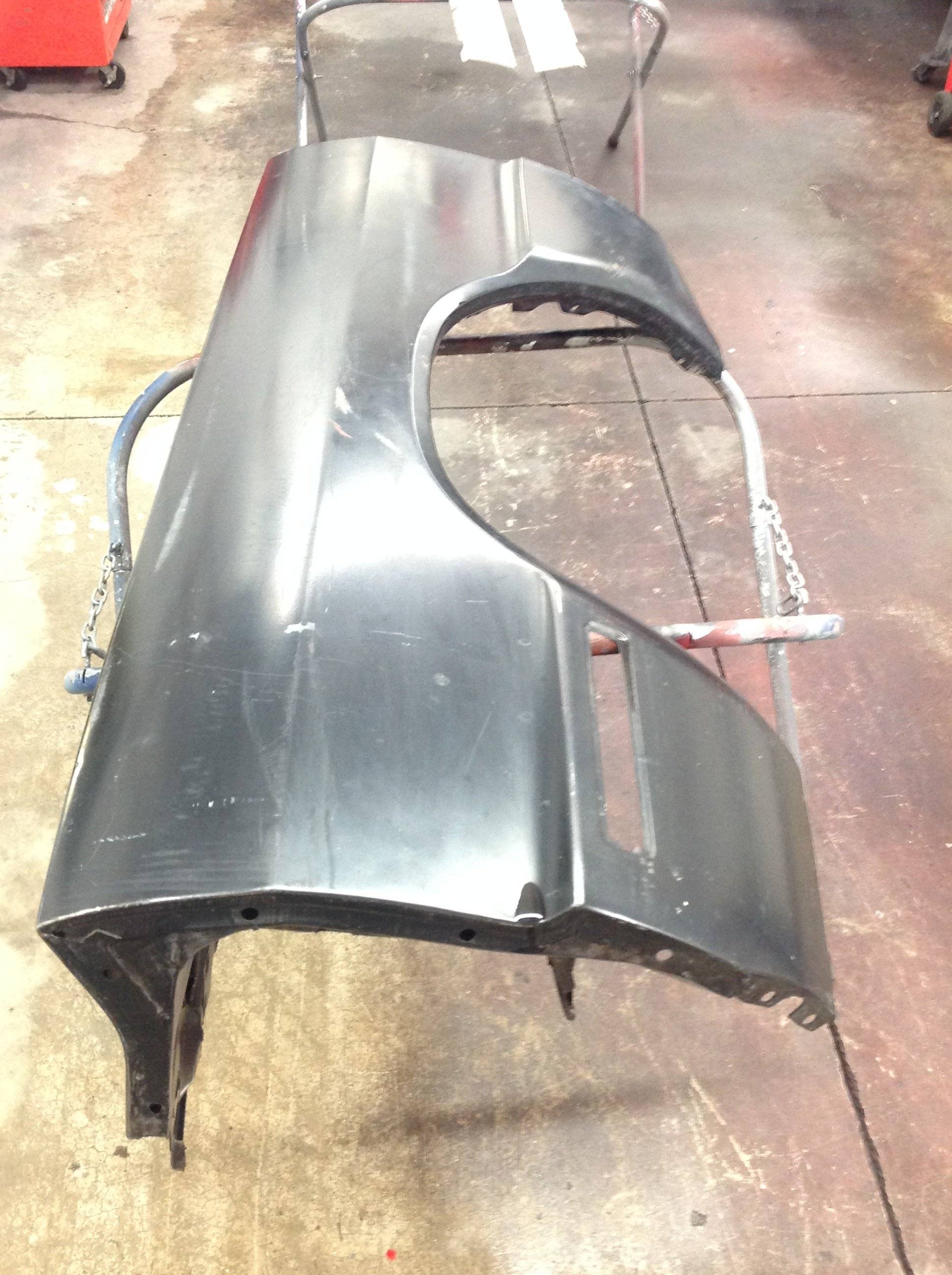

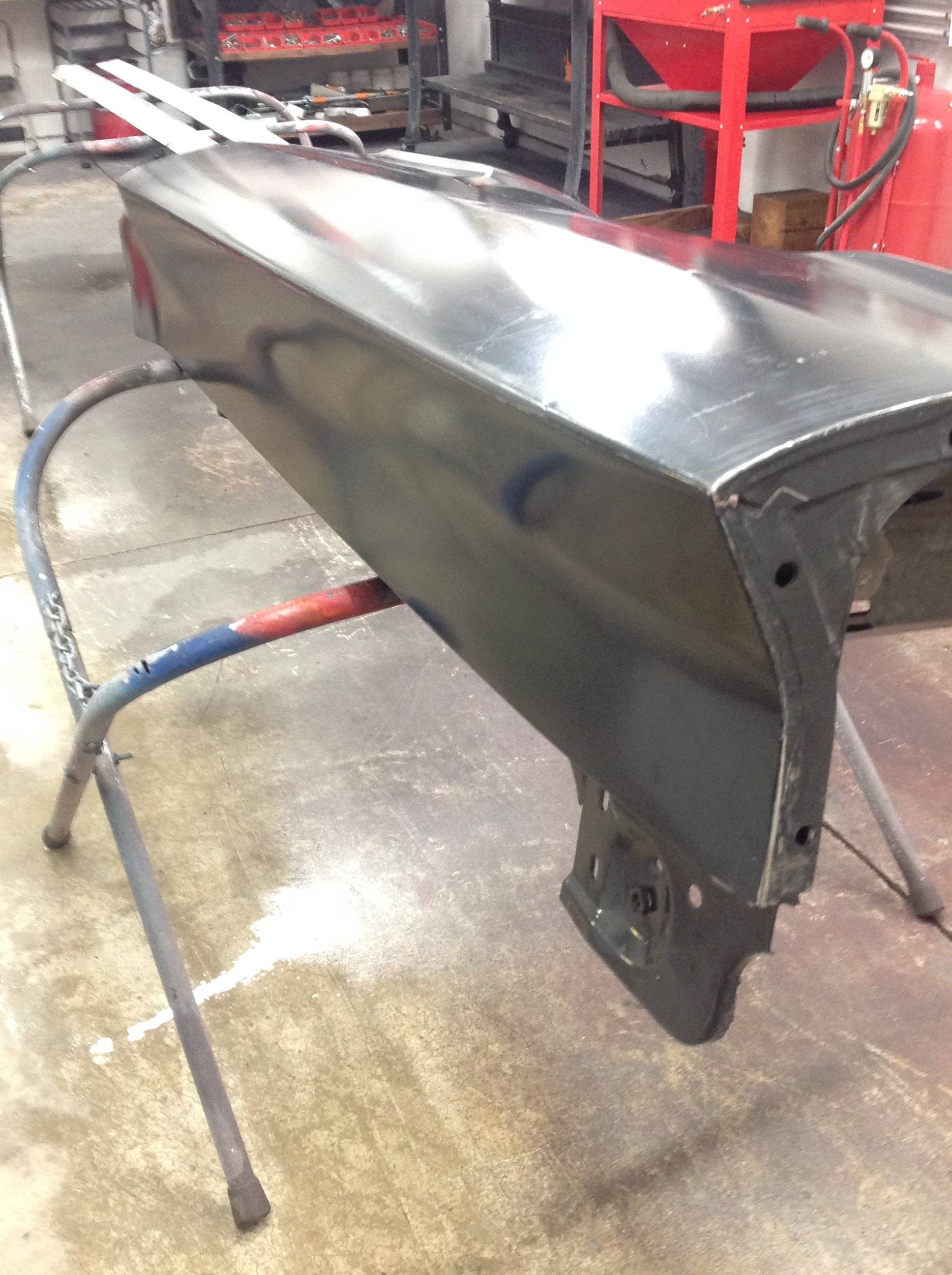

for Trev....can anyone id this fender as 70 or 71 and wether its a basic fury or sport fury fender....know there was a way to id it by signal light but have forgotten and its been so long since l bought them

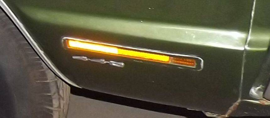

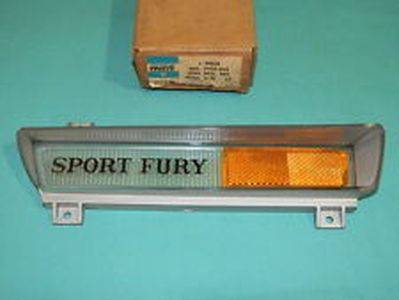

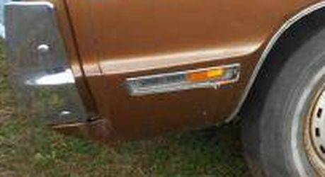

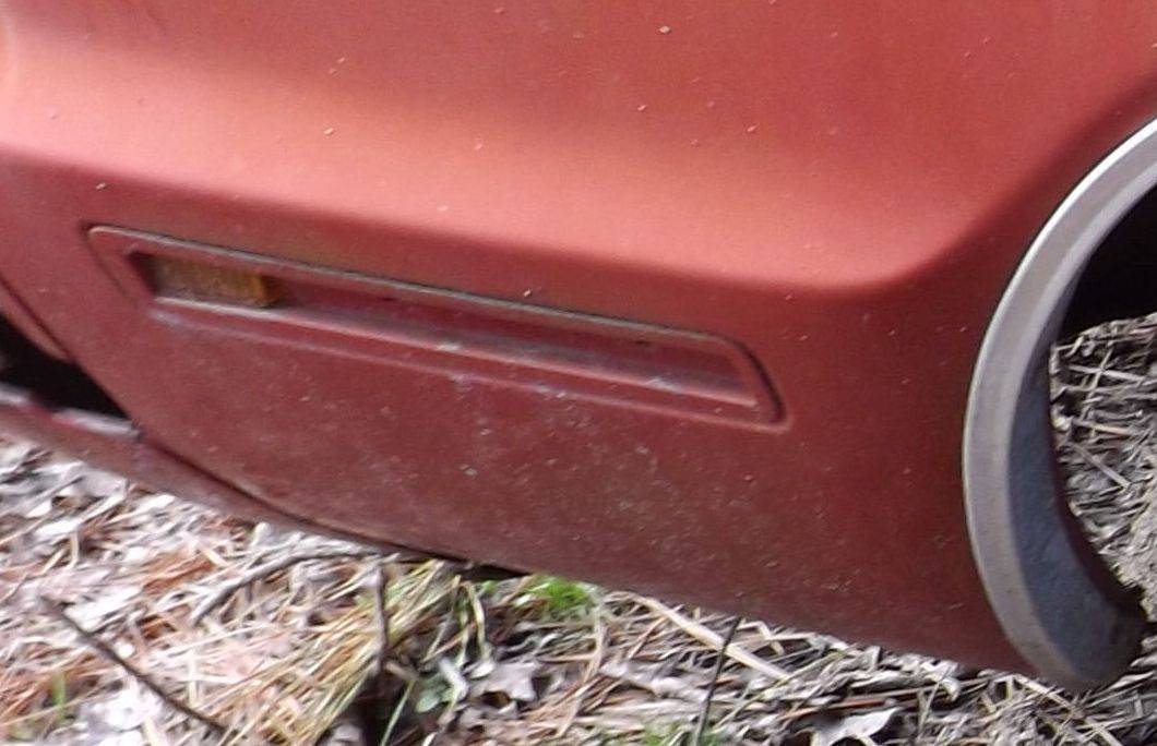

A square on pic of the turn signal housing hole will be the most telling. The Sport Fury hole is wider and has an angled edge at the front while the Fury III has a narrow slot and is rectangular front to back.
I just had a look at some pics of 70 fury III and a 71 sport fury GT(mine) and I stand myself corrected, they are the same.

k so the 70 sport fury has a larger signal light area than the 71...otherwise fenders are the same right?

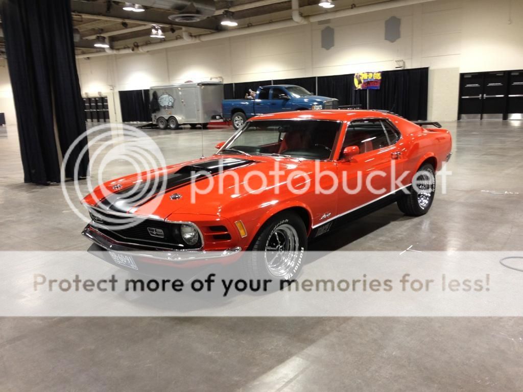

this is a pic of another of Pauls Calgary builds..this is Robs Car..this car was done prior to my car by Paul...have seen it close up and its absolutely stunning!
This is Rob getting ready for this weekends World of Wheels here in Calgary as they accepted the car to be shown
