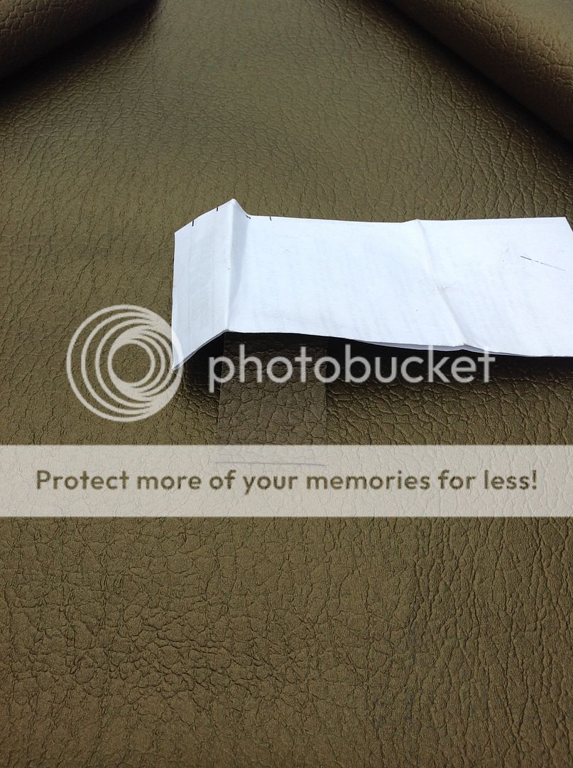

l absolutely love this color vynal...is what finally drew me in...
aw man that vynals givein me a grin l cant git rid of.....
