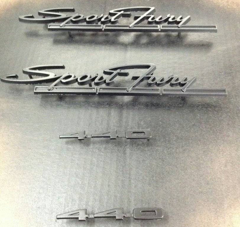

What is he using on the shiny bits and pcs? That "chrome" spray I see YouTube videos of?
naw...he wouldn't use that stuff on this sorta stuff...can see applications else where re radio knobs that sorta stuff...basically hes just back shading the lettering ect then clean off what he doesn't want...original chrome was in good shape....basicly spray and wipe similar to what we would do for a gear cap sorta deal

naw...he wouldn't use that stuff on this sorta stuff...can see applications else where re radio knobs that sorta stuff...basically hes just back shading the lettering ect then clean off what he doesn't want...similar to what we would do for a gear cap sorta deal
I think what Stan wants to know is what did he paint the Badges with? The pics clearly show they have been repainted with some sort of chrome product, I am curious to know too.

duplicolor engine enamel with ceramic
PN DE 1615
says he likes it because it gives him the satany silver alum color hes after and is durable
