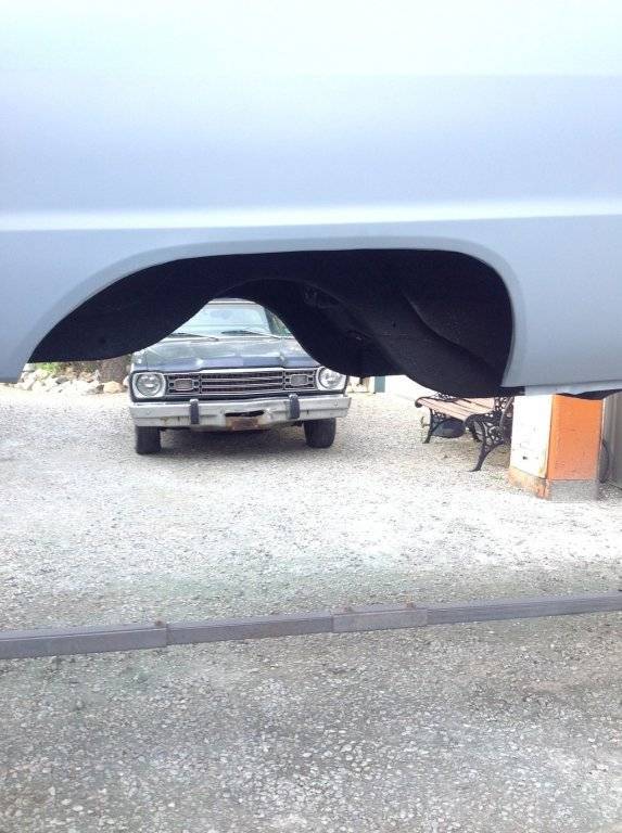

Not to be "That Guy" Mr. Critter but that is either a Duster Or Scamp. 73, 74...have any more pics?
think l said dart?....well is 6cyl duster..73 l think....belive Garry shot up to Edmonton to grab the 4 speed shifter and linkage for this car...np..will ask Paul for more pics next time lm chattin with him and get proper particulars...
