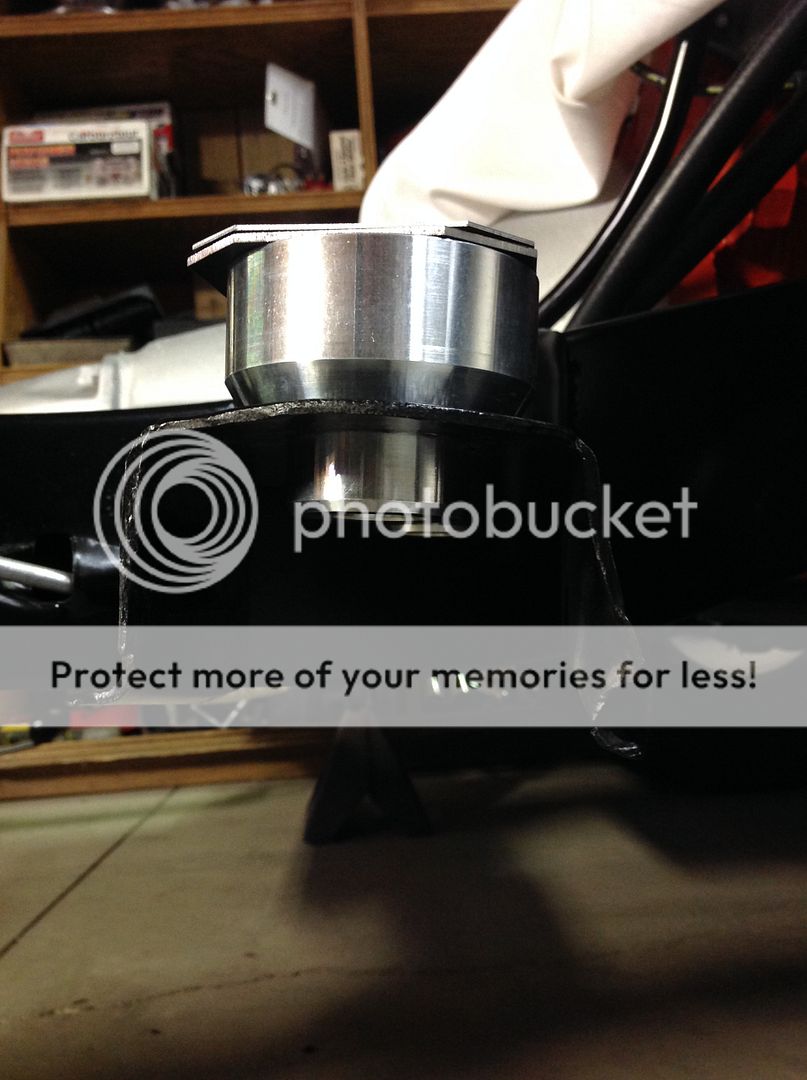

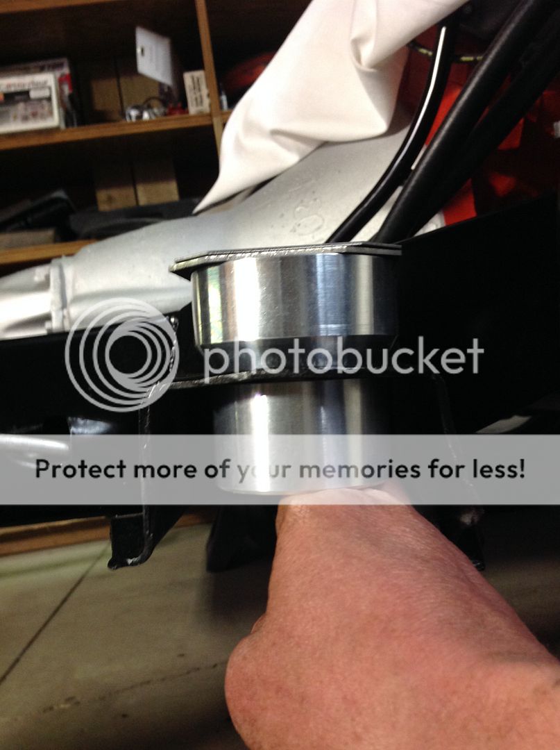

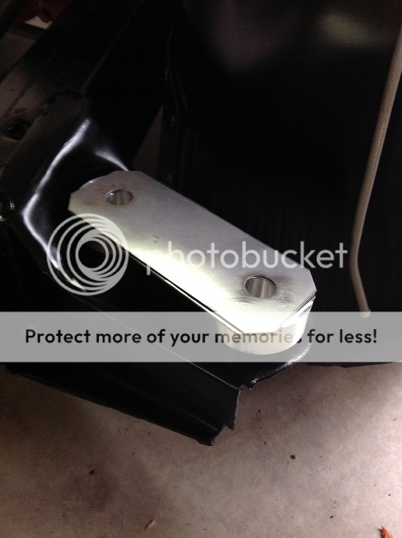

k....for our bushing issues have had these made up by one of Pauls "Guys" on cnc and should work nicely

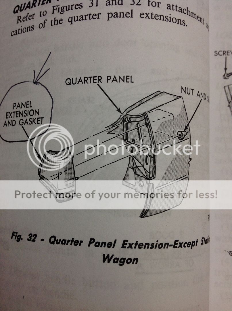

then there was the issue of gaskets....Directly from FSM
any metal to metal contact will flex and chip or crack paint

I was hoping you would find a source for those rubber bushings to retain the torsion quiet ride so demanded by the Brougham package. But what you lose in quiet will likely be offset by more rigidity and slightly better handling.
Regarding the gasket for the quarter extension, all I can say is that on my 70-71 C bodies, all my endcaps have a form of seam sealer on them rather than a formed gasket. Maybe an assembly plant running change?

Your aluminium bushings, being aluminium will crush over time and will expand/shrink with temp. As such they will loosen with use and probably start to make funny noises like urethane bushings. Might be worth adding a rubber gasket or two to control any lateral movement and noise.
