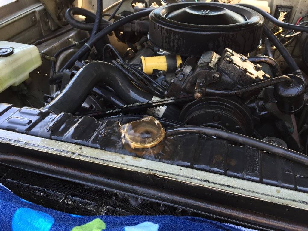

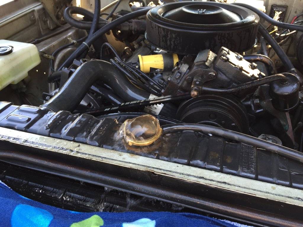

New water pump? I am sure you got this. But you might try this. Remove thermostat, a fill with phosphoric acid and water mix, CLR was just that mix, not sure if it still has phosphoric acid in it. Up here in Ontario it was removed.
I buy jug of concentrated phosphoric acid for my derusting tank, a little goes along way.
You might have had lots of air trapped in block and with the sediment causing your violent boil over.
Run it just long enough with the mix to circulate through block, leave it 6 hours or overnight like 10 hrs max. start engine and flush, I garden hose connection flowing into block will help.
Keep running and sitting till clear water.
This might lead to frost plugs being pulled and block cleaned that way.

The car was running for 20 minutes and it had a constant flow of cool fresh water through it. It boiled over after the engine was shut off. The thermostat was fully open.

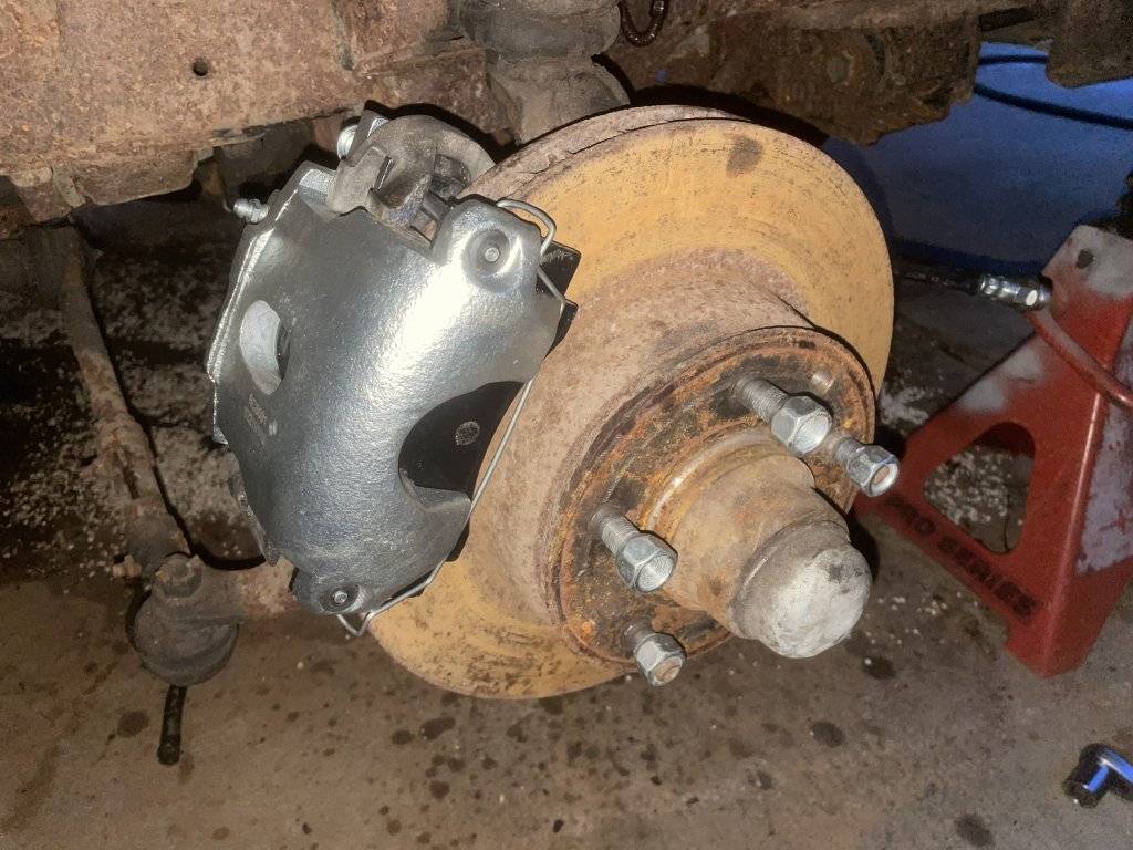

Now awaiting for the left caliper in the mail. I ordered new spring clips from MegaParts and I will get copper washers tomorrow. That will wrap up the front brakes.
Rear brakes will need a full rebuild as well and the hard line on the body needs a splice with a union to reattach the hose to the axle. I will eventually order brake line and armor to make my own line.
Right side done. So the calipers are the same for Chargers, Coronets, Satellites, Challengers, Barracudas and D100s. Apparently when you order a left side for a Charger it is a right for an Imperial so I have to order a right for a Charger.
