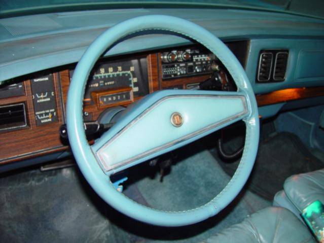

I can't speak for the earlier wheels. Does it look like the wheels on the Formals?
NO aftermarket steering wheel will fit, nor can any be used with any available adapters to fit the Formal T&T wheel. AUsHWeK, right Bob?.
The center is unique.
I saved the center from an old wheel. My plan was to use it on a modern OEM wheel like the Caddy wheel below. Would look good and not out of place. But it's a moot point now since I found a NOS wheel.

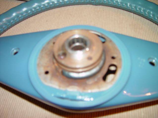

I just took another look at my column. The wheel is rougher than I thought it was. I wouldn't waste any time on it.
I could gut the center and adapt another wheel.... I might have a line on a repairable woodgrain wheel. I'll have to measure the depth of the dish and give it some thought. Hmmmmm.....
The center hub is the same. A non-telescoping wheel has to have a 1/2" of the rear of the hub machined off with a lathe. I did this on a 1977 Charger wheel.
