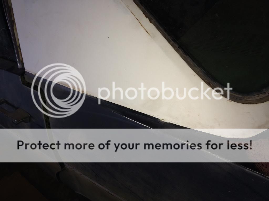

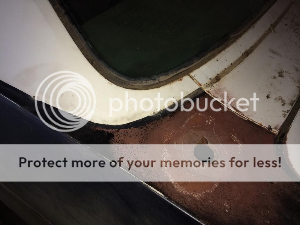

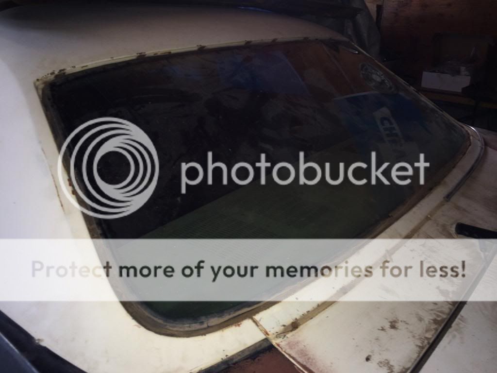

Got the rear window and deck de-trimmed. Thankfully didn't find any rust , but I will have to remove and reseal the rear window. Will also replace the trim clips around the glass at this time.
