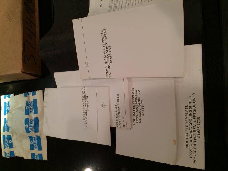

I have a paper somewhere that is an instruction to install these at Dealer level I think for ADDITIONAL COOLING vehicles as soon as I find it it will try to post it, like a field modificationin the ARMY Good Job Guys
http://www.hamtramck-historical.com/images/TSBs/1972/24-08-72d p18.jpg
this is the link for the TSB 24-08-72d modification there was also one for Monaco and Charger I hope I got the address right
73satwagon and CBODY67, you guys are awesome! I was able to yield parts numbers for all of the cooling-related oddities on my car from this TSB.
Baffle Kit, TIC Valve, and the extra A/C relay with wiring - all of which were on my car, and none of which were in the Service Manual or Parts book (that I could find, anyway)
I am still waiting to pick up my car from blasting and priming - in the mean time I did order the above items, NOS.

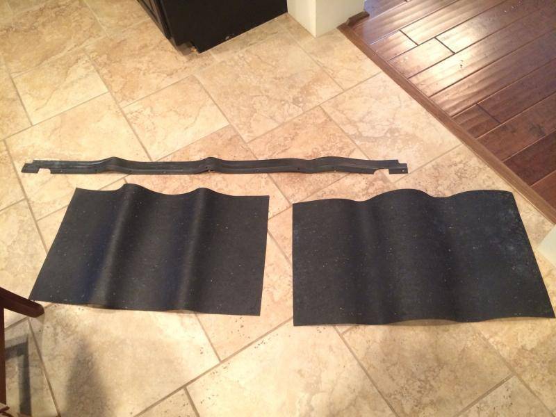

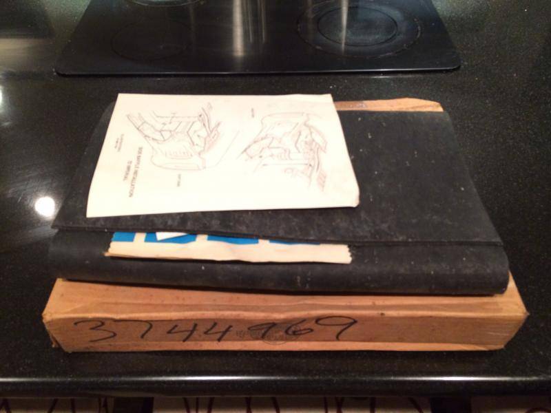

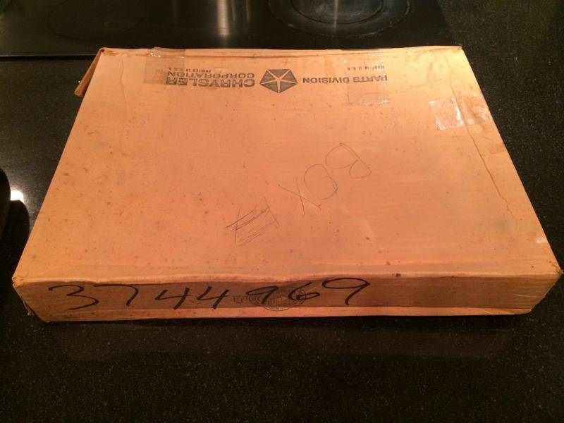

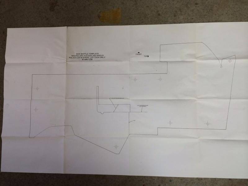

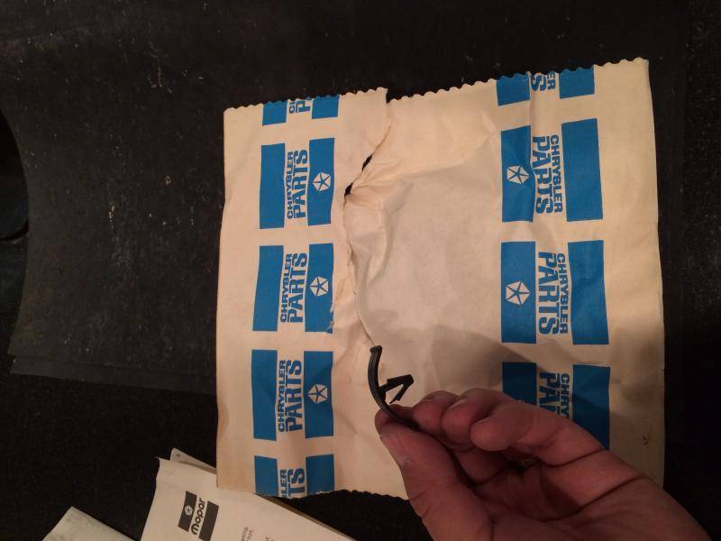

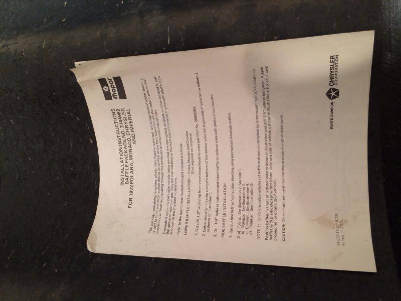

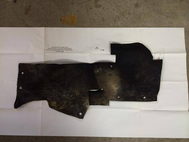

The Baffle Kit arrived today. For those interested, here are unboxing photos of its contents. I also included a picture of one of my existing baffles (super brittle) compared to the pattern that came with the kit. Only a few corners were rotted of of mine, otherwise it was complete.
Kit came with new masticated rubber sheets, plastic holding clips, patterns and instructions.

Hope you'll be able to post those templates. Every cop car restorer is going to benefit greatly from that info. Or, better yet, source yourself some of that .090" mastic and start selling your own kits!

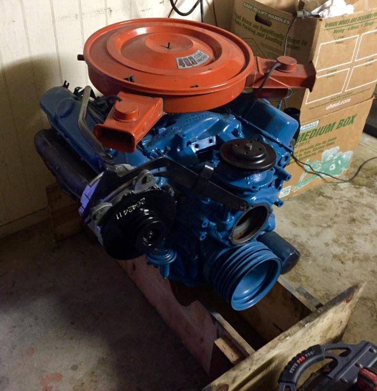

Long overdue update...Here's some shots from last weekend. Hit some snags along the way - I'm just going to quit projecting a completion date...Then maybe it'll actually get done!

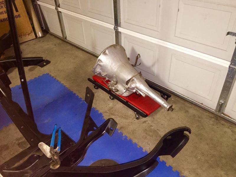

Frame and firewall stripped, painted and front suspension waiting for re-assembly. Also currently rebuilding the a/c evaporator and heater core box with the kit from Detroit Muscle Tech. Holdup on that is searching for a good replacement evaporator. Unfortunately while I was taking the suction line hose off during the disassembly process, all the threads stripped off of it - and due to the general condition I'd prefer to find a nice replacement in lieu of having a new threaded end brazed on.

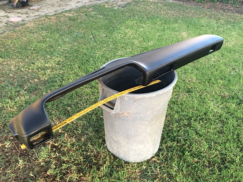

Waiting on my dash from Just Dashes. waiting on the upholstery guy to get to my seats. Sourced an NOS engine wiring harness (for engines w/ leece neville alternator, etc...) in excellent, pliable condition - picked up a few extra L/N voltage regulators as well.

I also considered just dashes
Can you post your dash when completed from them (after the 90 days it apparently takes them to complete
Are you happy with the outcome Alan?
Happy is a relative term.
I am happy I have a dash pad I can use. How's that for a non committal answer.
There are a couple small wrinkles, the area that bumps up by the defroster vents are not as sharp.
I haven't mounted it to the dash frame or fitted the AC vents yet.
I'd give it an 8.5-9
The problem is they are basically the only show in town and that is a big town. I check for others but they wouldn't do the stitching.
I thought I had a option but that didn't pan out.
