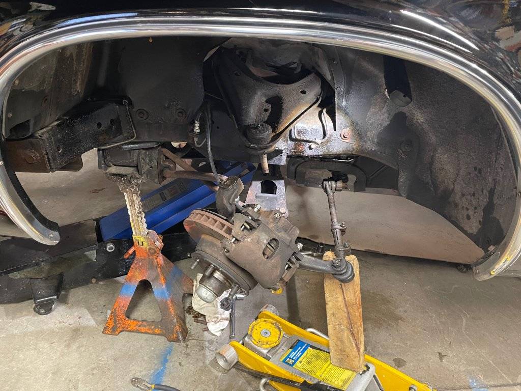

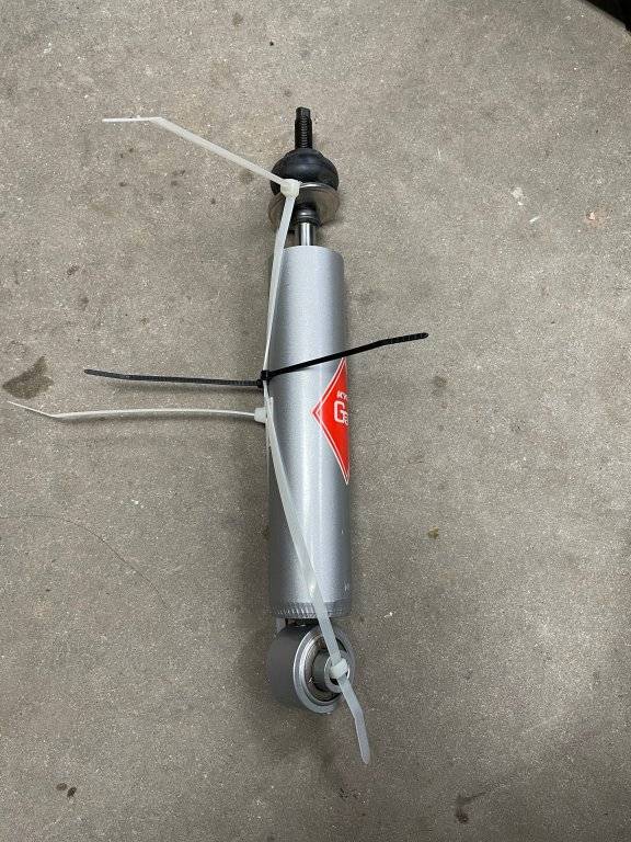

Let me know how those KG5413's work. I ordered a pair of those, as well as a pair of KG5512's to see which ones would be better for my '68 Imperial.I just did a test fit of the KG5412 shocks on my Imperial. They don't allow enough drop for wheel to be reinstalled.
I will wait to see what the KG5413 give me for clearance.
The Online Imperial club has a listing from KYB of KG5423. I thought it to be a bit too long, here is a link. Year Specific Shock Absorber Information For Your (Chrysler) Imperial
Zipped right on, like they should. I will have the wheels on tomorrow.Let me know how those KG5413's work. I ordered a pair of those, as well as a pair of KG5512's to see which ones would be better for my '68 Imperial.
Did the kg5413 work on the Imperial?I just did a test fit of the KG5412 shocks on my Imperial. They don't allow enough drop for wheel to be reinstalled.
See post 25 above.Did the kg5413 work on the Imperial?
I can also concur that the kg5413 works just fine on my '68 Imperial. I have been riding with them since this spring.Did the kg5413 work on the Imperial?
