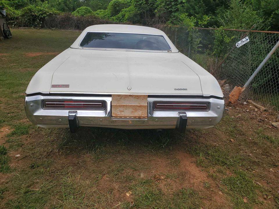

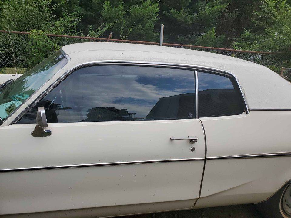

If you look at the 1st 2 pictures you can see that the previous owner of my car put aftermarket tint on the side and rear glass. There are 2 problems with this tint.
  • The 1st is that it was so dark that I couldn’t see out the rear window at night, using the rear view mirror.
  • The 2nd is aesthetically I just hate it. Classic cars should look like classic cars. I love the look of the green window tint in the air conditioned Chrysler fuselage cars.
Yesterday, I removed the tint with a razor blade paint scraper, peeling sections of it out by hand until it was all gone.

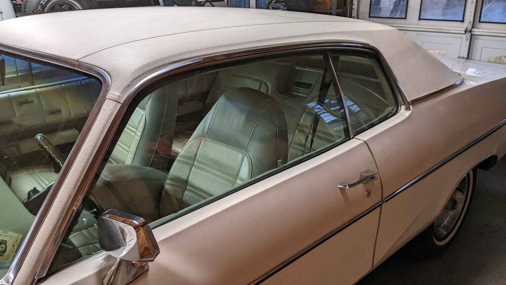

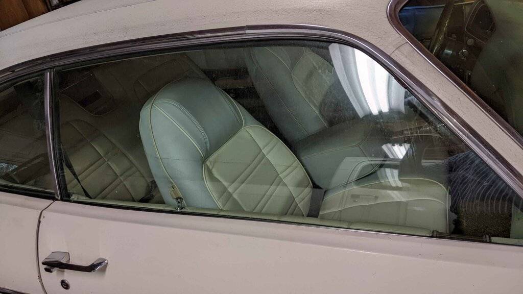

My problem is that the tint left some very strong glue on the inside of the windows. The glue is so strong in fact that it catches on the rubber channel weatherstripping in the door so that the electric windows have trouble going up and down and make a lot of noise doing it. I spent over an hour today trying different chemicals to get this glue off. I ended up using Bleach White Tire Cleaner on a rag to soften it and then a razor blade paint scraper and a rag to slowly remove it. It took me over an hour to do the drivers side door. I can only imagine how long it would take to do the rear window, which is much more awkward to reach. You can see the glue in the passenger side door photo if you look closely right beside the reflection of the fluorescent ceiling light.
Driver side: clean
Passenger side
