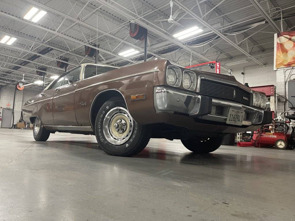

1973 Plymouth Fury

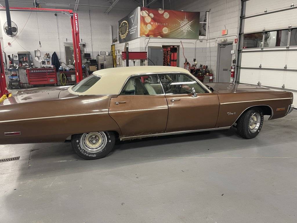

I replaced the 20 year old 215/60R15 Uniroyal Tiger Paws with Firestone Destination LE3s in a more correct 215/75R15. The car is instantly better.
A new set of lug nuts are on the way from Mega Parts, and much more from RockAuto including new rotors and drums.
Raised white letter tires, very nice.

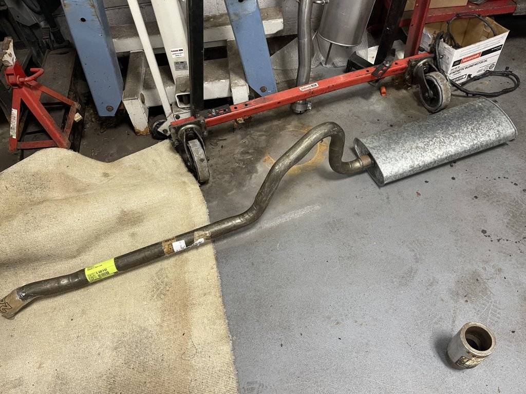

NOS tailpipe made it from AMS Obselete.

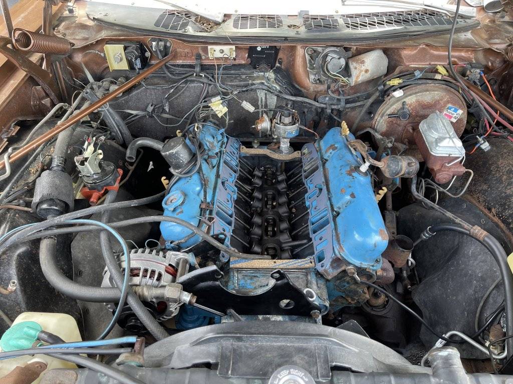

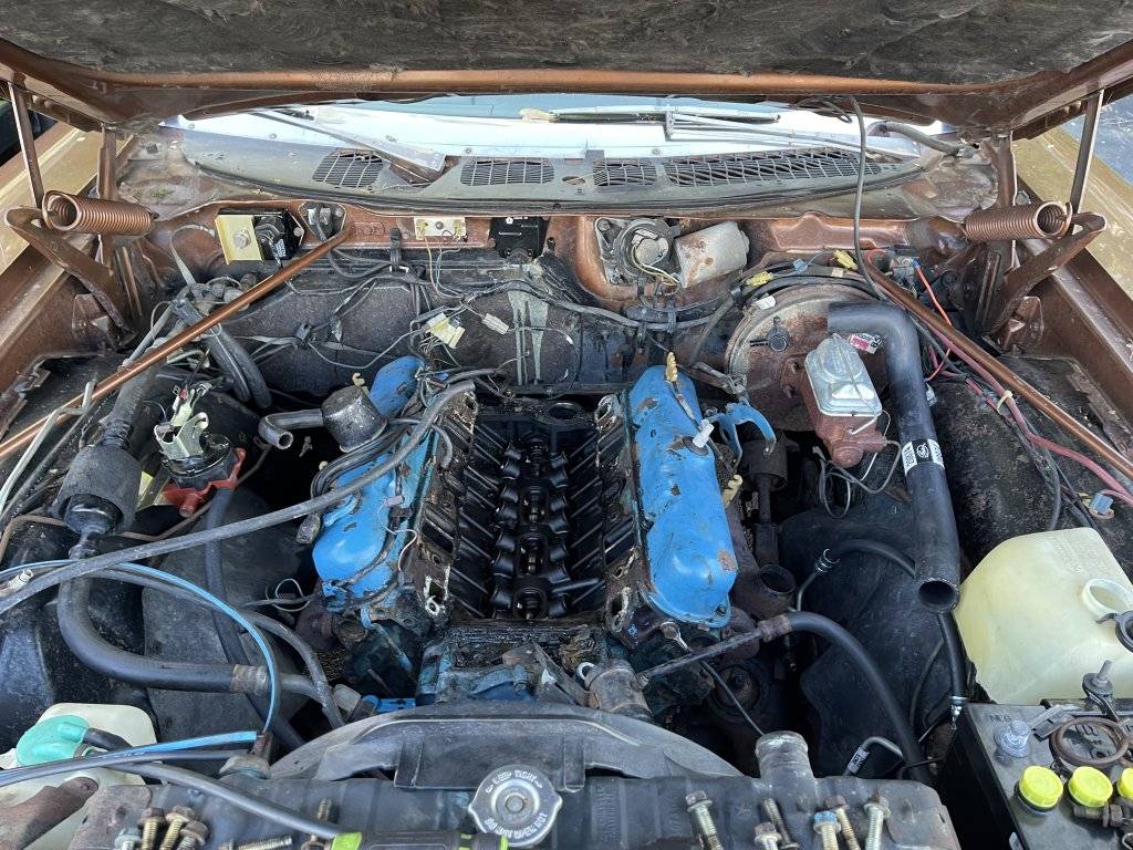

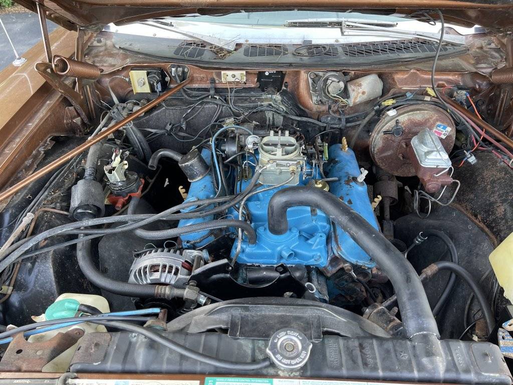

Working on getting the 360 back together. The valley needs a cleaning then I can reseal the intake. I will not be using the cork gaskets for the front and back.
I still need to work on the accessories and belts, vacuum hoses and a few odds and ends. Then fill fluids and anything else I can think of. I’m contemplating repainting the air cleaner to match the rest of the work.
