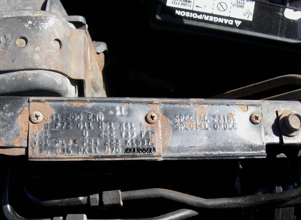

Just so I'm sure it is a U code where on build sheet do I look? In the vehicle delivery and handling in the upper right corner? The vin is;
CS41T 4C182 547
And it was sold in Newport Vermont at Natole Motor Co Inc. I'm have a hard time loading anything.
I can't recall an E86 in any 1974 Chrysler. The cops had 400/350's (P code).
Yes a "T", good or not as good?

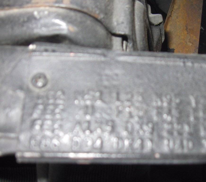

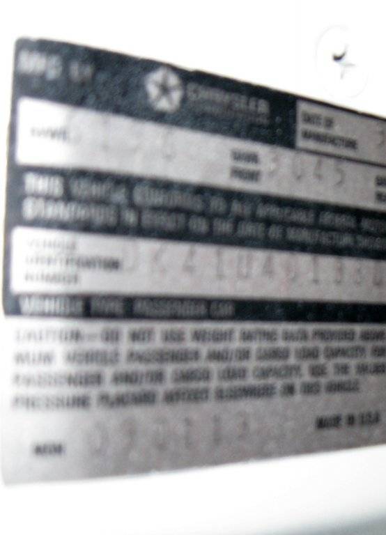

And now I have seen one. Thanks.here's my former 1974 Monaco ... DK41U4, and E86.
And now I have seen one. Thanks.![]()

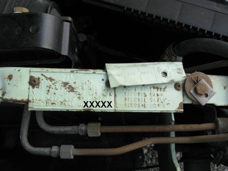

Can't make them all out but here's some info
E85 not a U code car
CS41:
Chrysler
Special
4 Door Sedan
T4C: Unknown
1974
Jefferson Avenue, MI, USA
182547: Sequence number
E85: 440 cid 4 barrel V8 350hp
D34: Light Duty Automatic Transmission
TX9: Black Exterior Color
H7B6: Trim - High, Unknown, Blue
KB7: Unknown Int. Door Frames
402: Build Date: April 02
: Order number
V1X: Full Vinyl Top, Black
H51: Air Conditioning with Heater
R38: Unknown
L31: Hood/Fender Mounted Turn Signals
M45: Moulding I think
P31: Power Windows
P41: Power Door Locks
C63: Unknown
G25: Add Vent Windows
V7W: Accent Stripes, White
N75: Aux. Transmission Fluid Cooler
L81: Unknown
N95: Emissions Control
Y39: Special Order

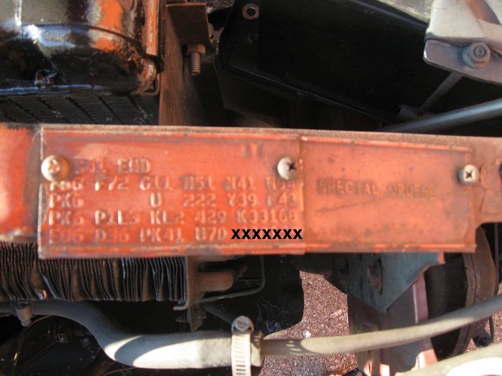

But he showed you an E86 in a Dodge, E86 would not be unheard of in a Plymouth or Dodge copcar, E86 ran thru the end of 78 for them.And now I have seen one. Thanks.![]()

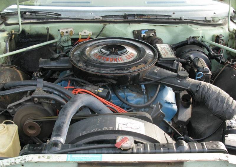

I have never personally noticed any E86 Chryslers after 71, and by the big 74 facelift I would presume they were not available. The shiny car on page 1 just looks like a repainted HP aircleaner on a T-code, unless somebody knows differently.
The E86 was available in Formals too. In 72 Chrysler transitioned to Corporate blue for all engines (although some have demonstrated that some engines were still painted orange in 72). The dual snorkels in the Formal era were orange (non-LB) or black (LB).
Below is a data plaque for a 77 and an engine pic.
View attachment 109256 View attachment 109257
