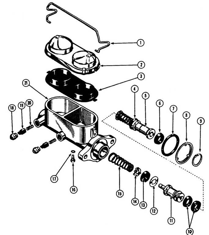

I picked up a complete 75 imperial rear end off of a local demo guy. He called me as he knows about my quest for rear disk on my Newport. Not realizing that I would need the master cylinder to make the rear disc work like factory. I was thinking of using a disk brake proportioning valve, or an adjustable stock car proportioning valve.

You'll need a 50/50 reservoir master cylinder on cars with front and rear disc brakes.
Using a proportioning valve on a std. disc brake master cylinder is making it worse.
The reservoir for the rear on a std disc brake master clinder is already too small. A proportioning valve will be useless or worse.
If you use then decide to use a proportioning valve to limit the front brakes, you are severely reducing braking power overall.

Is the master cylinder issue that there is not enough fluid in the non 50/50 master cylinder to run the system? How do these master cylinders split the braking without a proportioning valve? I imagine it's internal to the master cylinder to some extent. I was under the impression that you wanted breaking to be like 70% front and 30% in the rear. When you say 50/50 you just mean the how the fluid in the master cylinder is divided right? Not a 50% split on the breaking.
That is correct. The capacity of each of the two resevoirs of the master cylinder.
