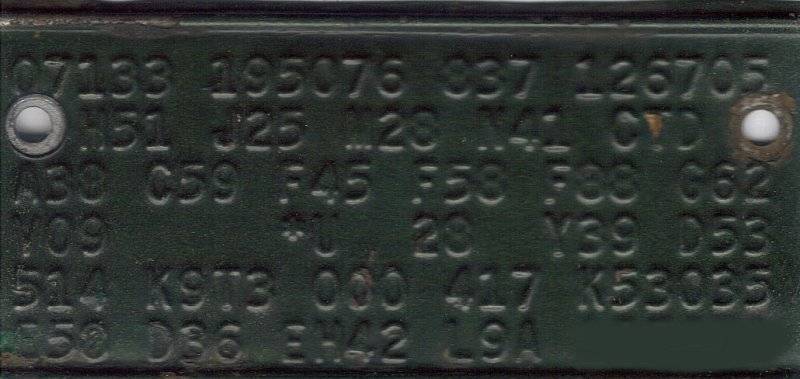

I have 7 data tags for 71-76 for Police Package cars DK & RK VINs, not one of them have the A38 on the tag.
I'm not saying that the code doesn't exist, just that absence from the tag doesn't mean it isn't a Police Package car.
In these years the K in the second position in the VIN is for Police.
Need more data.

A38 was a "package" and rarely if ever were packages listed on the fender tags. They would most certainly be listed on the Broadcast Sheet, so if you happen to find one of those for/in a police vehicle, it will tell a very complete story.
Written confirmation of the A38 package contents might be listed in the normal data books, but it's most likely contained in the Order Guides which few people seem to have. I will check to see what I have and whether A38 is listed. I do recall it's listed in 1979, but how much farther back than that, I can remember off the top of my head.

Speaking of those cop car fender tags, why don't they list the sequence portion of the VIN ?
