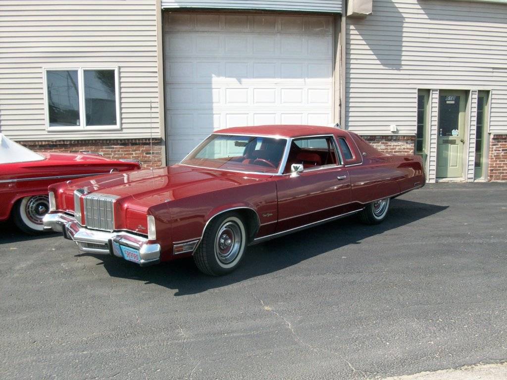

Remember if you switch to T/T column you cannot use the three spoke sport steering wheel which I actually prefer as for appearance. I would consult a trusted body shop on removal of the rub strip on both sides. That is an add on that I removed from mine as the picture below shows. For me it looks better without it.
I can't tell in the picture.....
Do you have the red decals on the mirrors?
No. a mirror was replaced before I purchased it with a new one and graphic was removed from other one to match, I have not found anyone that reproduces them yet in my color or at all.
Mr C. knows somebody in Canada that had a vendor that repopped those decals. They looked OEM and excellent. I tried to follow/locate the vendor but it wasn't clear how to contact that vendor in Canada. There is a thread here somewhere. I forgot which thread that had a picture of the decals on a sheet of 8 or 10 of them.
I wish I would of known you about 7 years ago. The mirrors I lucked out getting from the junkyard in New Mexico had perfect red decals on them. My NYB is B3 Blue so I soaked them in acetone until the decals peeled off. The mirrors were NOS quality and I would of traded that set with you.
