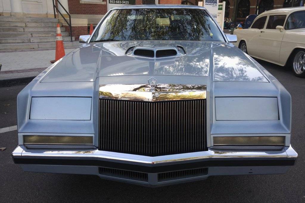

1978 NYB New Engine.....
I might have to do that or run without a hood.

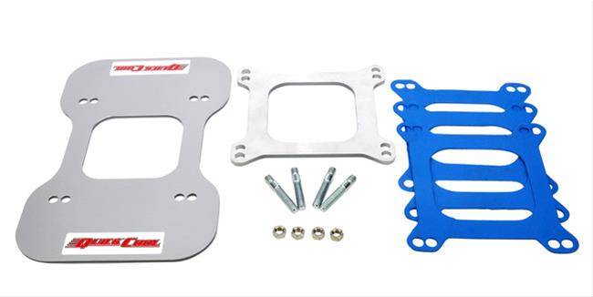

The way the engine sits right now the top of the air cleaner is making an impression in the hood insulation pad. I dont have a choice....I need to install the carb insulator kit and that is going to add another 1/2" of height to the engine.
Just some off the top of my head thinking... First, lose the insulator pad. Second, a piece of 1/8 steel (maybe stainless) cut to the shape of the air cleaner base could gain 1/4" or so.
Then there, something else... The '64 factory S/S cars had a small spacer between the K-frame and the body to raise the body (or lower the engine depending on your perspective) for clearance. What about shimming the stub frame 1/2" or so. Adjust the T bars to compensate for the raised front.
That might be fairly easy to do. Probably easier and cheaper than having a decent looking hood done (if that's possible IMHO). Loosen the bolts and jack the body off the stub enough to slip a spacer in... Or even replace the rubber insulators with a steel version, like the cop car Diplomats used.
Thanks John. I was considering removing the hood insulator pad. That's a shame....its brand new but if I can get the hood closed...it'll have to go. I believe I will need the entire carb insulator kit. The entire kit is about a half inch.
I'm not certain about the stub frame mods. I really dont want to alter that area.

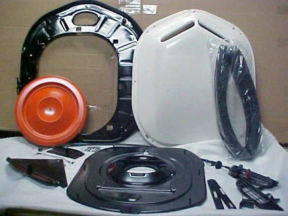

That shaker hood kit isnt cheap. $2700 for a BB 4 bbl kit.

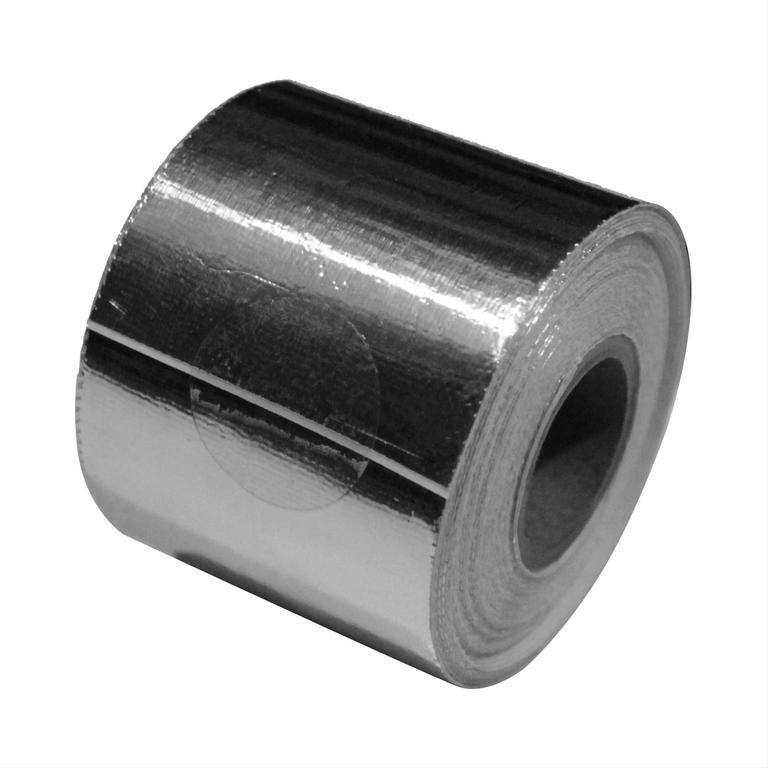

IMHO, I don't think the carb insulator is going to cure your issue. In my experience, you'll do more to isolate and insulate the fuel line. Couple that with an electric fuel pump and your problem should be solved. I'd give some consideration to removing the stock pump too.
If you go with a electric pump, think about adding an inertia or "rollover" switch just to be on the safe side.
I'm considering re-routing the fuel line away from the engine and then to the top of the engine and to the carb.
I've used the carb insulator kit and fuel line wrap with success on other Mopars. I also had a Kool Can on my Super Bee and Challenger.
