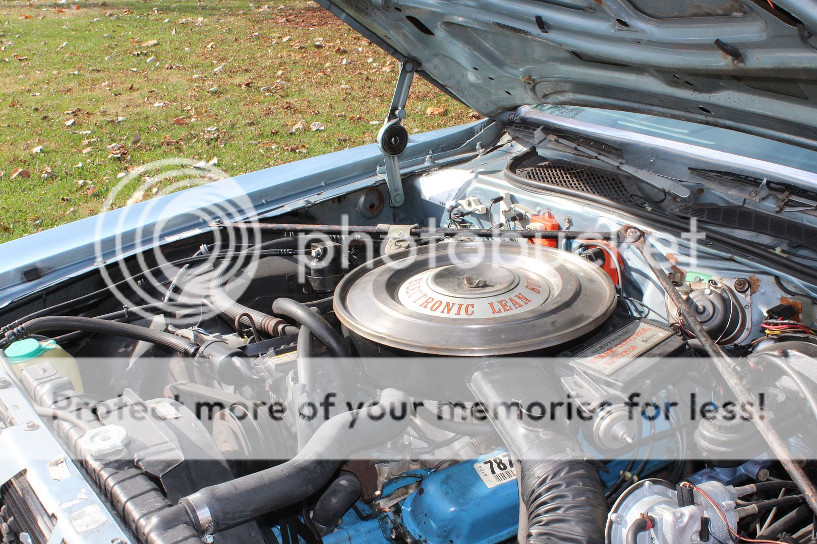

Thank you for the heads up. I'm wondering if it has Lean Burn issues or some other issues from being in storage for so long?
I don't think it would be "lean burn" issues. It appears from the engine compartment photo that this car has been converted from the lean burn to the MP electronic ignition system. The MP orange box is pretty clearly visible on the firewall of this car.
The orange box on the firewall is a EGR delay timer module as the '79 Cordoba I have has one on it. It definitely can look like an "Orange ECU" and that was my first thought too but, then I remembered my car.

Yup that's been mistaken for ECU's, VR you name it. The LB appears to be intact on this unit
Does seem to be missing battery insulator/washer resovoir though....hated those damn things

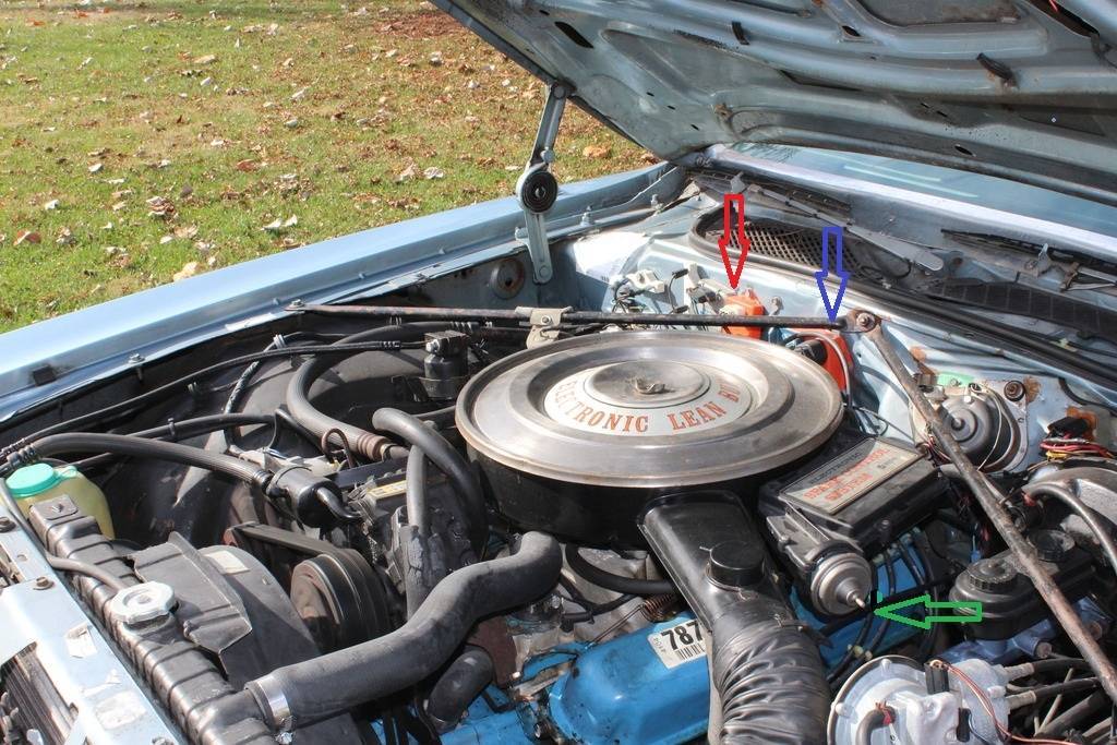

The red arrow looks like the EGR timer.
The blue arrow looks like an ECU.
The green arrow, no vacuum hose is hooked to the Lean Burn.
My car no longer has the lean burn hooked up btw. My point is I can't see an ECU on the Magnum. If you look again, when the conversion was done you'll see two ballast resistors on the above engine bay photo. :)
The pic with the arrows is Streetmachine's car, not the CL car.
I agree, I don't see an orange ECU on the CL Magnum, and the LB has a vac hose on it.
