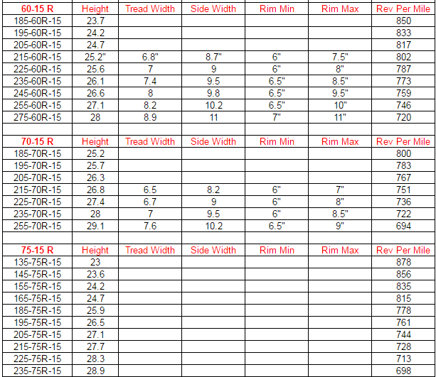

And what is a 70?Charts I'm seeing have the 245 60 with a height of only 26.57". That's on the small side.

When I changed over from 245/60 to 235/70, the ride height of the car went up nearly an inch.Charts I'm seeing have the 245 60 with a height of only 26.57". That's on the small side.
How does that happen? No sidewall flex?When I changed over from 245/60 to 235/70, the ride height of the car went up nearly an inch.
According to the charts you posted, the 235 is 1 1/2 " taller than the 245/60, so that alone is a 3/4" ride height increase (1/2 of the increased diameter).How does that happen? No sidewall flex?
Other way around.Are you responding to me? If one tire has a diameter of 26.5 and the other has one of 28, and they're both mounted to the same size rim, how did the 26.5 diameter tire raise his car an inch?
