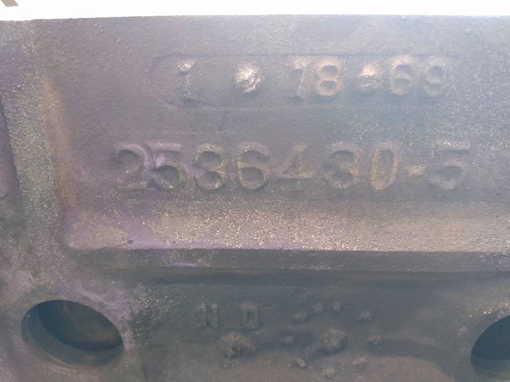

3 serial numbers on 440 block?

Yes i looked there. This block has no pad like in your picture and i scraped paint from bell housing edge, nothing..
Oh i see now what youve done on pic! I will have to go and scrape where you number is. I only scraped to the right of the oil sender hole! Not the side you have shown! Thanks
Still no luck after i scraped other side below oil sender. I think im gonna by it. The casting date is jan. 17 1968.

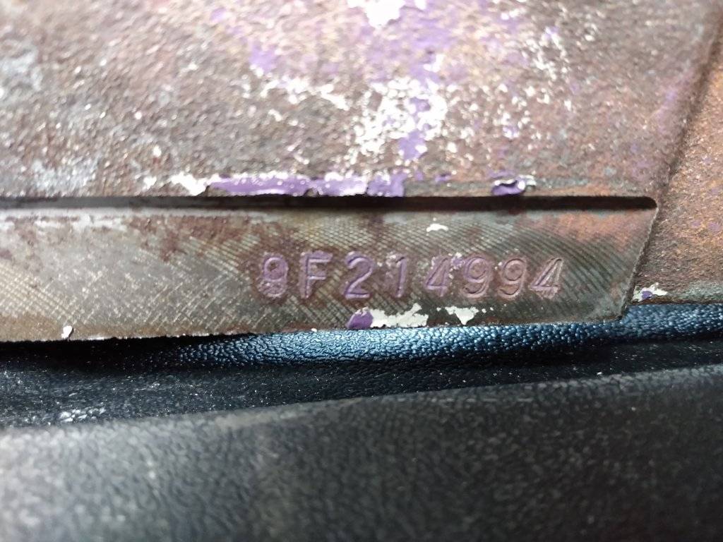

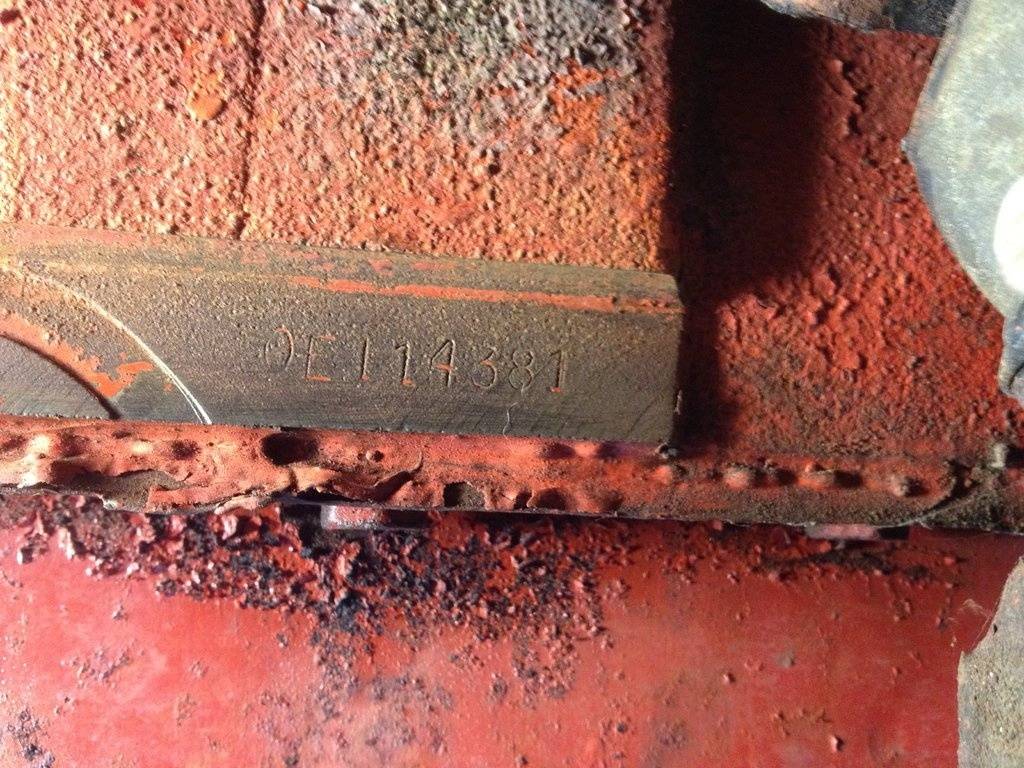

Except as noted in the previous post, most of the engines that have partial VIN numbers have them located on the pan rail on the opposite side of the engine, example VIN: PH23TOD100001,
P=Plymouth
H=Hard Top
2= 2dr
3= Price Class
T= 440, 350HP
0= Year of Production, 1970
D= Production Plant (Belvidere)
100001= Sequence number starting at 100k.
The last 8 digits will normally appear on the pan rail 0D100001. The last 8 digits should match the last 8 digits of the VIN. Sample attached.

69 engine will have complete VIN. I learned that on Graveyard cars! My only 69 engine has whole VIN.
Early cars will. You start to see plants going from all 13 characters in the VIN to 8 in about mid January. That’s one way to tell if a block has been restamped. Dummies put the full VIN on a late built car..
I agree with 69CoronetRT on this one. See the pictures from the 440 block that is going into my 1970 Fury. Note: Mopar purple is from a previous owner. Hemi orange is the plan.
