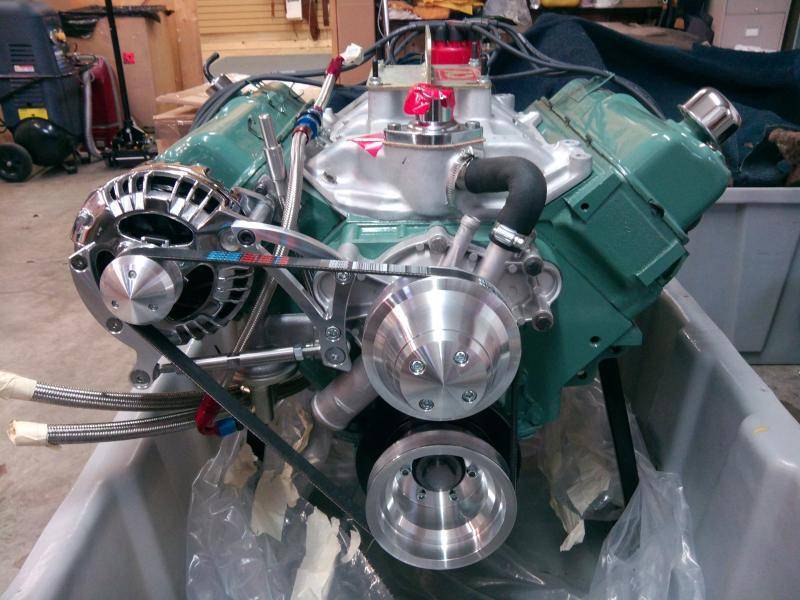

318 wide block educate me please

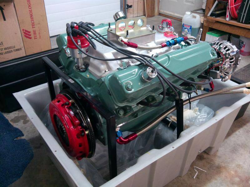

This is the poly going into my fury however its a 360 now. The wide block is a bit of a misnomer because the block is virtually the same size as the LA 318. However notice how the poly heads come off straight which gives it the wider appearance. The LA heads turn upward. I dont think you will find a more solid engine. You can buy the 4 bbl manifold from Weiand.
