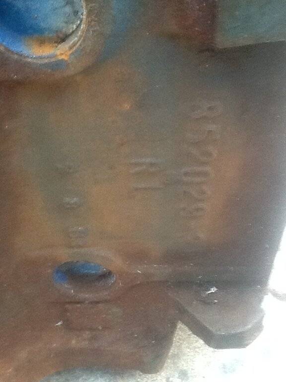

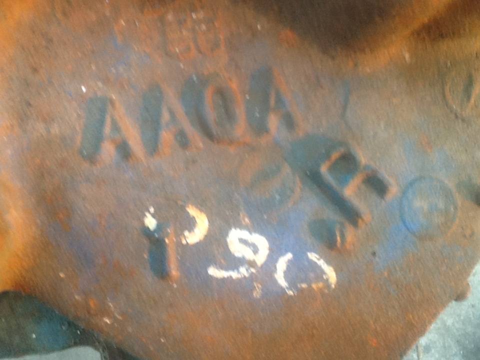

361 instead of 383? Drop in replacement?
So if the crank is a 6 bolt flange I can use the shortblock? Can I then use it with my own damper, pullies, heads etc?
And is a 361 always a BB engine? Or can it also be a RB engine like @Davea Lux said?
361 is always a BB engine. 413 engine is always an RB. Pretty much a completely different engine for purposes of your swap. 413 sits taller and wider than the 361. Neither industrial engine is really appropriate for an automotive swap.

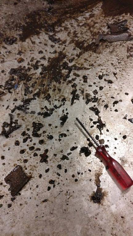

Current engine issues:
- Removed the oil pan, found 1/4" of sludge, metal fragments and a lot of bearing material
- Oil pickup was full of debris
- Crankshaft main bearings are shot, has big grooves and is 4 thou underside just by wear
- Crankshaft big end bearings are damaged
- Oilpump has big wearmarks on the rotor and cam and is not reusable
- Cylinders have 8-10thou taper with a big ring ridge (simply rering job is not possible anymore, wear is too big)
- Camshaft bearings are damaged
- Some camshaft lobes are worn.
- Lifters have seen better days

ONLY 100K miles? My '66 Newport (and my other Chrysler 383s) have well over 100K miles and they are still together and running fine. Only issue might be a bit more oil use than they used to. But they also needed a valve job by 80K miles (on #7 cyl) and have received new timing changs along the way, too. Still, no issues with the short block.
I understand your concerns about what was in the oil pan, BUT other than the sludge, there is no indication about where they came from or when they got there. Could have been there from its initial build, especially if where they came from was not evident upon tear down. At the point you removed the oil pan, if there were no noises in the engine, you could have just cleaned things up, including the oil pickup, put on a new gasket, then put it back together.
On the issue of the shot bearings. You see wear and grooves. The real issue should be "How much bearing clearance, via plastigage?" Those grooves might mean "less flat bearing interface surface", but if they match grooves in the bearing shells, then that's more load-bearing surface, just not flat, plus additional oil capacity.
Other wear areas mentioned, just because they look worn doesn't mean the engine will not run reasonably well for a while longer. End result, what you're terming "shot" is really just normal wear. Certainly, it might have been a bit less if it had had more oil and filter changes, but if it was still running quietly, or even with a little piston noise upon initial start-up, but no bearing-related knocks, with "some" oil pressure, it was still useable as it was.
Cylinder wall taper, that is normal too.
Now, I fully understand your perceived "alarm" at what you found. A normal reaction. Plus the desire to make it all "right and better" again. All normal reactions. But as long as the oil pump can pump some oil (even if the pressure is low), no unusual noises, and the fuel and electrical systems on the engine still work reliably, you might be surprised at how "out of spec" an engine might be and still work well enough to maintain vehicle useability.

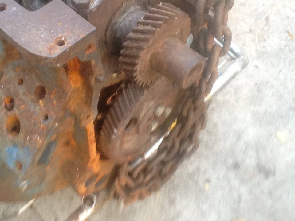

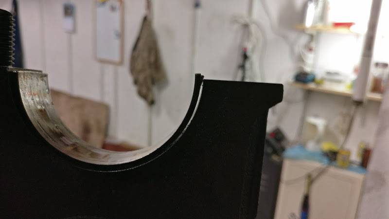

I've included some pictures on the bottom of this post to show the damage.
I think that the engine was just shy of spun bearings... The front cam bearing was missing chunks of bearing material. And more.
I fear that I would have destructed the engine beyond repair if I continued using it.

The bearing is all warped. It sits so loose in the cap that you can look through it.
uq6_qp2lyegskrqx18lrn1jbbphesyfqviwk5aw8-5w__tarx7ge4pha_nx3arlhvuju-w800-h450-no-authuser-0-jpg.jpg
This was all residing in the pickup. All chunks of metal.
loodfbiwppr2x_oz010dnpbe6_5zq3kjmqtgqjnuibir4ehsnonr3ha0-x_01u5o-sgq-w549-h976-no-authuser-0-jpg.jpg

@Davea Lux sharp eye.

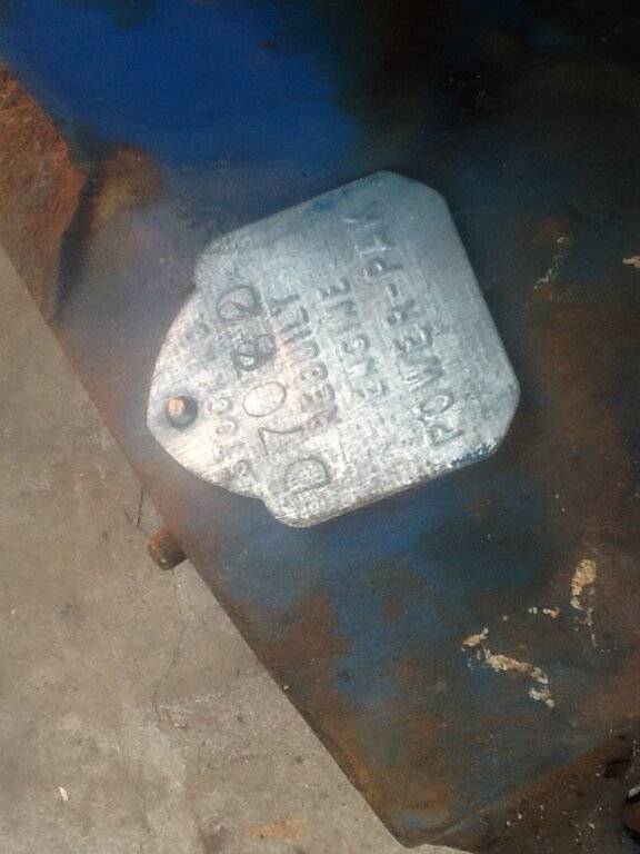

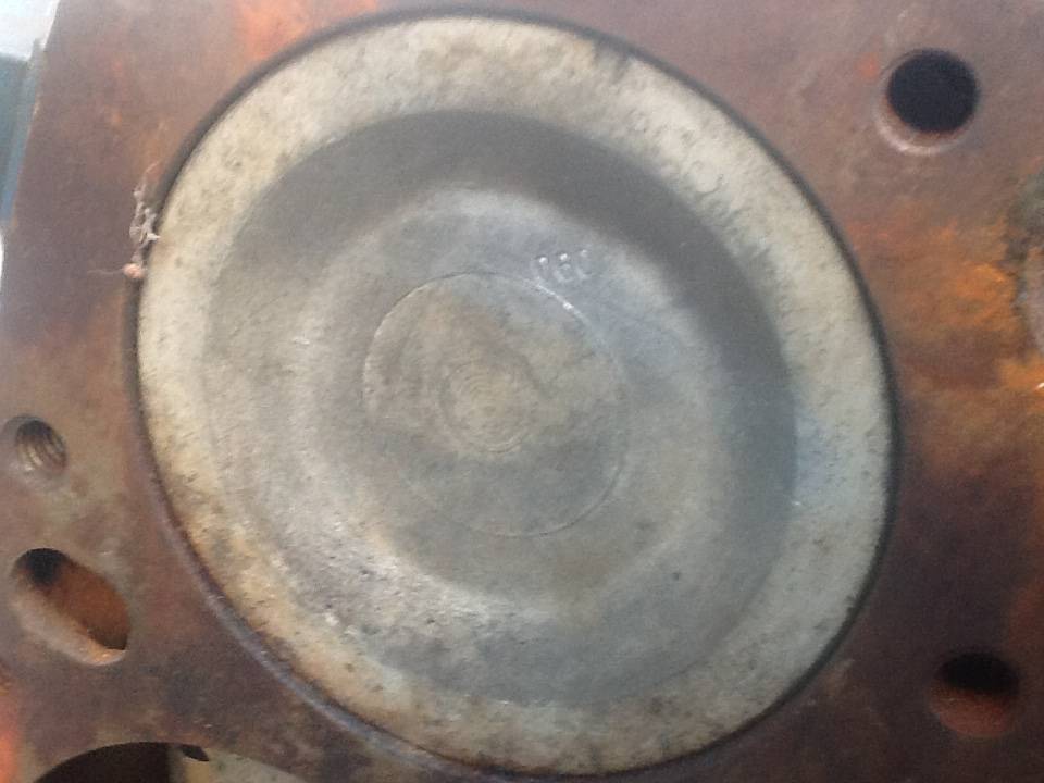

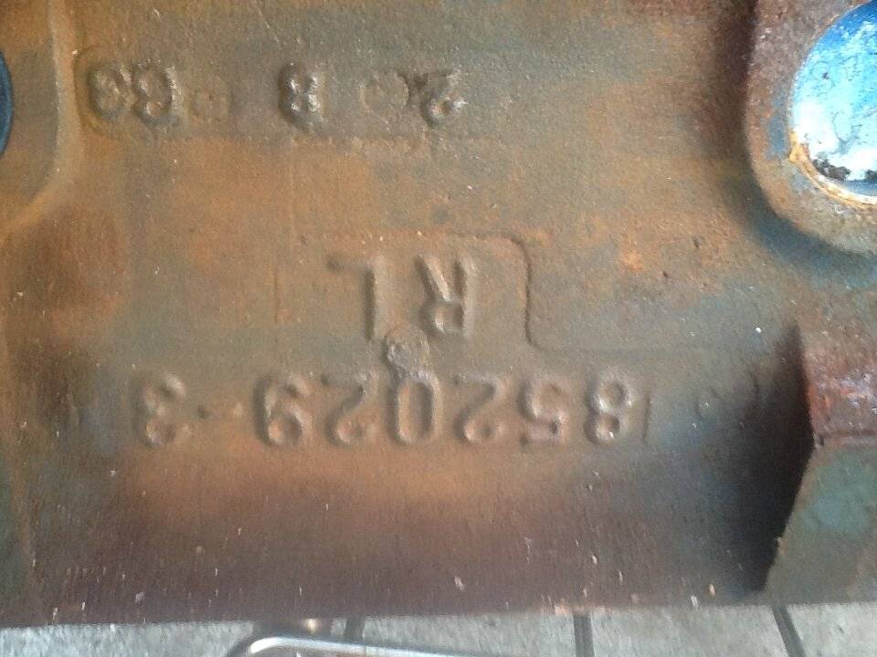

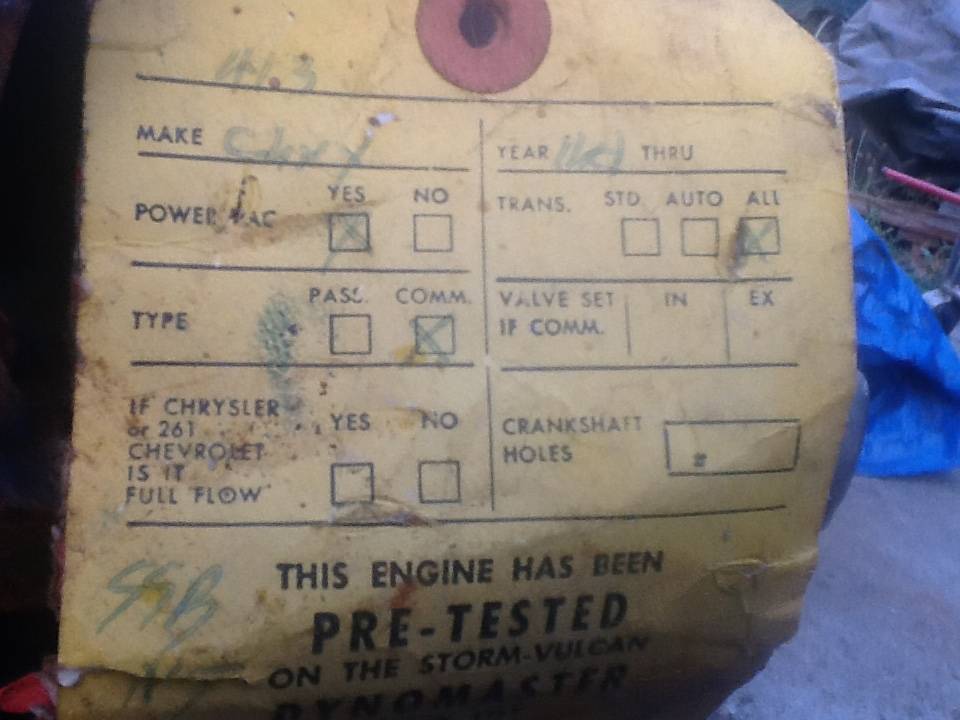

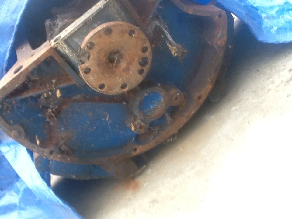

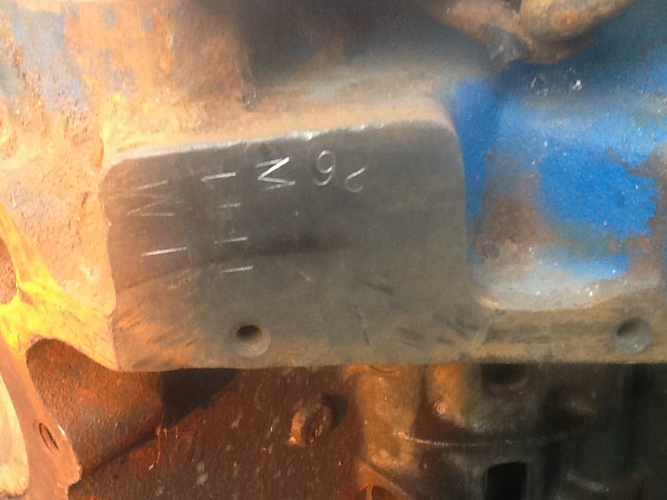

I was curious and got in contact with the owner of the industrial engine since you've noticed the RB stamping pad.
Turns out its a 1963 RB 413CI engine.
I informed the owner so he knows and can edit the listing.
I recently acquired this rebuilt short block 63 413 cheap. Was very happy til I noticed the gear drive? Did a little research and turned out its a industrial motor! 60 over,low compression,8 bolt crank. Not exactly sure what if anything I can actually use from this motor?
View attachment 406832 View attachment 406833 View attachment 406834 View attachment 406835 View attachment 406836 View attachment 406837 View attachment 406838 View attachment 406839 View attachment 406840 I recently acquired this rebuilt short block 63 413 cheap. Was very happy til I noticed the gear drive? Did a little research and turned out its a industrial motor! 60 over,low compression,8 bolt crank. Not exactly sure what if anything I can actually use from this motor?
The block.
The crank in addition to being 8 bolt which isn't a deal breaker, is I believe, longer than a passenger car crank.
Kevin
