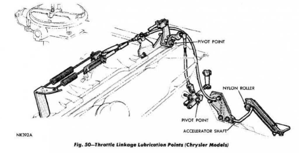

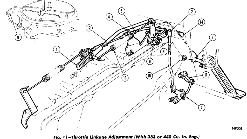

The red spring is attached exactly as per the FSM for the 1968 Chrysler Newport. I doubled the throttle return springs, one inside the other to insure that if one broke, the other would still return the throttle to idle. I HATE having to turn the damned engine off suddenly when a throttle return spring breaks or otherwise comes loose. Not good for the engine at ALL either.
I guess both versions accomplish the same thing.

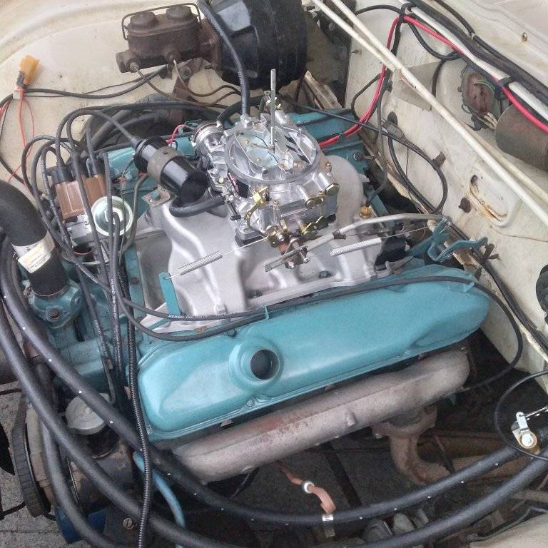

Update: alright, much like the block's heater hose inlets and outlets, I finally got off my lazy *** and decided to get around to doing this...and it actually went quite well, albeit with a few hiccups. It's still a work in progress, but right now, I can confirm that even with the stock air filter (3.5 inch), it juuuust clears the hood and that's with a 1/2 inch phenolic spacer too! You'll need the following parts however:
- phenolic spacer (apparently these carbs suffer from heat soak and these spacers reportedly help a lot with this)
- if the spacer doesn't come with a stud kit, get a 2 inch stud kit
- 350 mm/14 inch air cleaner base plate, recessed is not necessary
- 280 mm/11 inch ID Air filter, either 3.5 inch or 2.75 inch. Fram CA127 or CA305 respectively for cross referencing. Not sure if the lower flow rate of the 2.75 inch will be noticeable.
- Air cleaner cover stud of at least 6 inches when using a 2.75 inch filter, else go 6.75-7 inches with the 3.5 inch filter. The stud that came with the AVS2 was 5.5 inches and just a bit too short.
- fuel hose or steel fuel line to connect the fuel filter to the carby.
Again, this is still a work in progress, so there may be other parts you may or may not need; I haven't gotten around to testing out the throttle cable and kickdown linkages with the brackets yet.
This square bore, 4-hole spacer I found was from a local shop for a VERY reasonable price compared to what Edelbrock and other retailers are asking. Just 20 AUD, fortunately for me, he was in the same city as me so I just went and picked it up, saving the shipping fee. The stud kit it came with was a bit short, overall length is 45mm; you might be able to get away by partially threading the intake side threads, but I didn't feel too sure about that so I'm going to get a 2 inch overall length stud kit from Rocket Industries, it's only $9.60. The 45mm stud kit was just shy under the top surface of the spacer, you'd need at a bare minimum of a 50mm to thread nuts on it...which just so happens to be the 2 inch kit.
As for the air cleaner base, for those who wish to use the stock air filters, I took a gamble, and it paid off: Aeroflow AF2851-1400 - fairly cheap, the stock filter fits perfectly on this base plate. The great thing is it also has a 5/8" hole on the inner side of the filter if you want to hook up a PCV hose to the oil/breather cap. This can also be bought from Rocket Industries. Using the factory pie tin with this, there is now about an inch-wide gap all around the circumference between the base and the cover, but it's really only visible if you look down the air horn, or from underneath. The main concern is ensuring an airtight seal between the cover and the base, which this setup still definitely does.
The air cleaner cover stud that came with the AVS2 was 5.5 inches - fully threaded into the carby, it was too short when used in conjunction with the 3.5 inch filter. With the 2.75 inch filter, only partially threading the stud will give just enough thread to tighten the wingnut down, there's still plenty of engagement in the carby, but if it still irks you, get a 1/4-20 threaded rod and cut it to 170 mm or 6.75 inches. This will enable usage of both 3.5 and 2.75 inch tall filters.
Now I don't know about the genuine Weiand 8008 intakes, but this knockoff...well, you get what you pay for. While I got mine for half the price (a result of helping out the seller with his own cars and some computer/tech support stuff) of a real 8008 from a local retailer, the casting isn't completely perfect - the kickdown pivot point bracket that you can see in Cartel's image...it didn't fit on this intake. The casting is too wide, so I'll have to grind off a decent chunk to get it to fit. The throttle return spring bracket I also had to grind a bit as the casting was too big on that side too. I suspect that the OG 8008 intakes won't suffer from these problems and you probably won't have to go through this.
For us RHD people, there's enough slack in the throttle cable to not require modifying it, but the clamp itself may sit rather short so you might need to stick it in a vise or use pliers and bend it.
Another problem I encountered was the 3/8" vacuum port on the intake that has a little auxiliary 1/8" barb coming out of it, this sucker is absolutely stuck on the old intake, I'm just going to buy one 1/8" barb-3/8" NPT fitting, and one 3/8" barb-1/4" NPT fitting in order to take advantage of the vacuum port on the carby, as well as the port on the intake. The 1/8" barb is for the vacuum-operated vent controls. I'm using separate fittings for these because reproductions are insanely expensive.
I got a 5/16 inch coated steel fuel line, and bent it partially following the original fuel line, up to the carby fuel inlet barb. A pipe bending tool will help a lot for this, but isn't absolutely essential, you can do this by hand if you're not bothered by the messy look. The stock carby inlet is 3/8 inch while the line is 5/16, but as others have mentioned previously, you can use a single flare on the line to allow it to accommodate a 3/8 inch fuel hose as needed.
Before:
After:

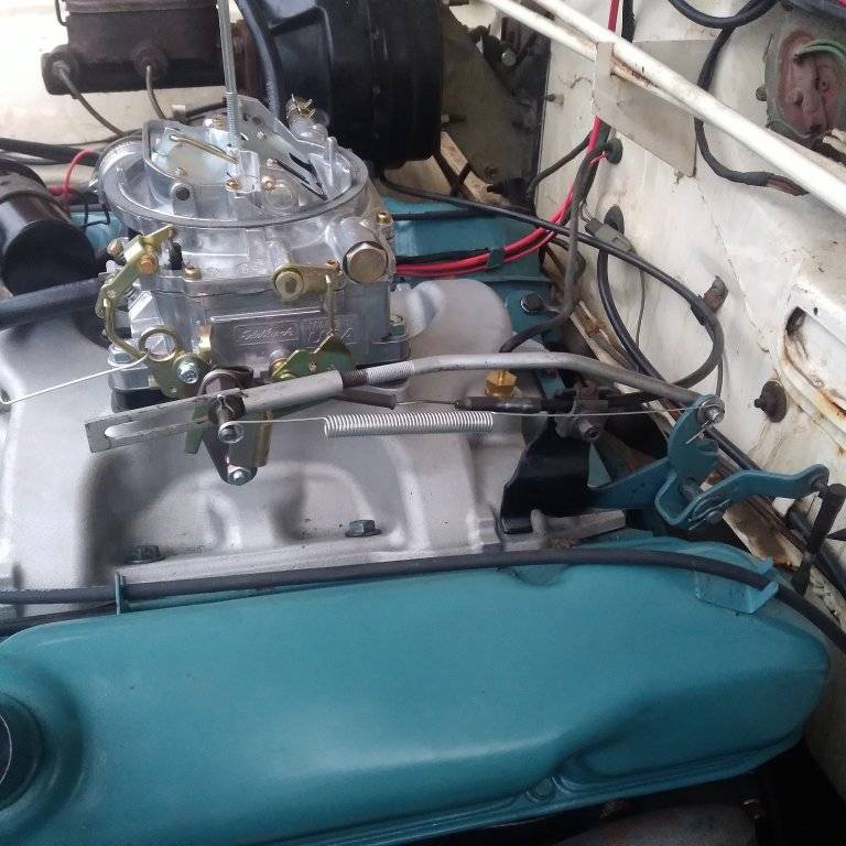

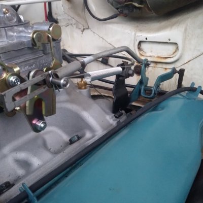

The throttle linkage bracket will need some modification, specifically, where the throttle cable gets clamped to the bracket, will need to be raised by about 10-20mm or until the cable comfortably reaches the throttle lever pin. You may need a metal bender for this, as it's pretty thick steel. Might be doable with two pliers but I didn't bother trying. Alternatively, if you've got some extra cash, you can buy a throttle cable bracket from Mancini Racing or Rick Ehrenberg, Mancini part numbers MREAR036 for the 383 bracket, and MREAR018 for the 440 bracket. The brackets are intended for an Edelbrock Performer RPM manifold, but should also work with other similar dual-plane intakes.
Dammit, forgot about the 10000 minute time limit to edit posts.

The reason I put the throttle rod extension in my list is that when I did the upgrade to the Torker 383 and 9801TQuad, the stock 4bbl throttle rod only had about 2 threads of engagement with the slotted end of the stock 4bbl rods mechanism, so I got it for good insurance, and it worked well. I ended up filing the soft metal of the rear section a bit shorter, for good measure, though. Then I got another rear rod from the salvage yard. I still kept the extension in the mix when I put a Holley 4160 in place of the TQuad.
Good to see that there is enough slack in the 2bbl accel cable, too.

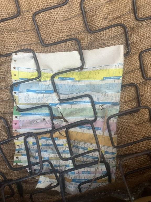

Here’s some pics of a couple of things- I found the broadcast sheet, fixed speedo clip and cable, and I pulled off the rear bumper and mounts and cleaned it all up and repainted and rewired. The valance was very rusty as you can see, just undercoat here.

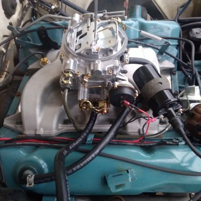

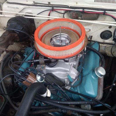

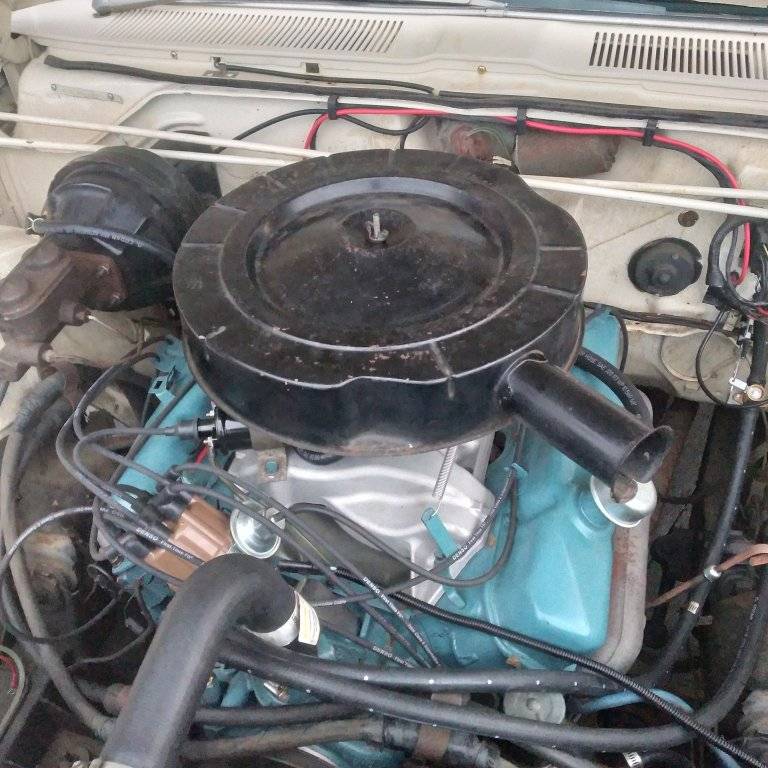

Wahoo, everything is installed!
20250117_195639.jpg20250117_195654.jpg20250117_195712.jpg20250117_195731.jpg20250117_195758.jpg20250117_195845.jpg20250117_195923.jpg
Was very nervous because I had to crank it for about 30 secs before fuel started going into the carby, but it roared to life. Adjusted timing to 8° BTDC as per the instructions that came with Rick's electronic distributor, still ran like ***, so I tweaked the carby screws, idles much better now. Electric choke works flawlessly - I poked a hole in the grommet for the vacuum climate controls, and hooked up a ring terminal to the back of the ammeter pod, where the 12v feed goes into the voltage limiter, nice and easy. If you have an IVR3 limiter like I do, you could probably just crimp on an insulated female ring terminal onto the choke feed wire, then stick that on the extra positive post on the limiter.
I've driven a buddy's car before with the AVS2 and like that car, this one feels just like a car with factory EFI. Starts up more or less like a fuel injected car, maybe even quicker (mind you, it's overcast here), and you push the pedal and it just goes. I did try flooring it, but it didn't seem to kick down so not sure if I got it right.
Unfortunately, two other problems reared their heads: the temp gauge barely moves but the fuel gauge seems to work fine, and the speedo doesn't work lol. The needle moves freely, so it's something with the cable, or the gearbox.

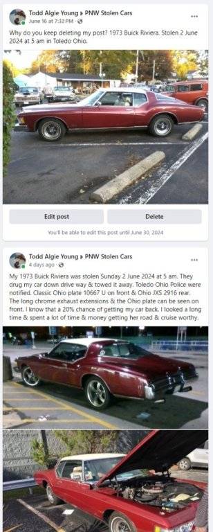

Not sure what you mean by Canuc. I have tried to find any parts in my quest to personalize my 1966 Dodge Polara. Complete exhausts are none available & a couple over priced long time to bend pipes. I will just go with what I have originally what MOPAR placed on the car. It has plenty of power & great fuel economy. To pay over $3000 plus installation? I will keep my eyes & ears open. I found this Dodge while searching the internet & other places to find my stolen 1973 Buick Riviera. I wanted a 73 Riviera from my first ride in one at my cousins wedding in 1973. It took a while to find one that was not a basket case. It was from the start a pain is performance & pocket book. Drive home of 50 miles. It burned a gas tank full 25 gallons, a gallon of antifreeze leaked from heater core & water pump & a couple quarts of oil. I had to put it up on blocks to repair all the broken & or leaking assemblies. I got my insurance settlement of $25,000 after I proved that I did not sell or hide the Riviera. Thanks for the sometimes confusing tips & information. Waiting to hear from Walton Exhaust. Deciding if I want to spend my bonus from SSI for being a first responder on SSI
