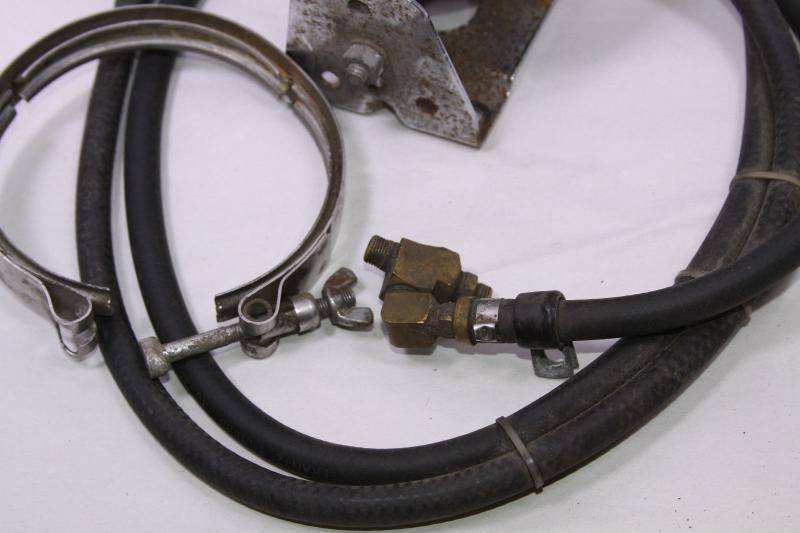

Thanks again for helping me figure this out. I'm still of the opinion that it came from the factory this way, but who knows. I'll get it taken off someday and get a photo of the intake bolt thingy. For now here's a better shot of the bolt and clamp.

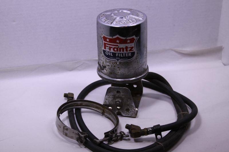

Little update. I asked if anyone on the FBBO site knew what I might have here and someone suggested a previous owner had installed one of those Frantz toilet paper filters. One guy even showed a photo of the Frantz filter on his Charger I believe it was. So, mystery solved. I pulled the fitting and rubber line off the back of my engine block so I could plumb in an oil pressure gauge but the intake fitting is still in place. I'll get to that one some day...

Glad you figured it out. Years ago I dailied an 87 Diplomat cop car. It had all the cop stuff with a very gutless Lean Burn 318LA engine. On one of the fender supports was a cooler. Fed by the oil pressure switch then dumped into the front fuel pump mounting bolt. Yup, hollow.
