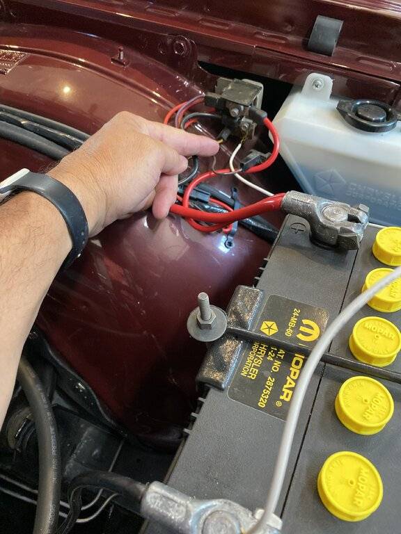

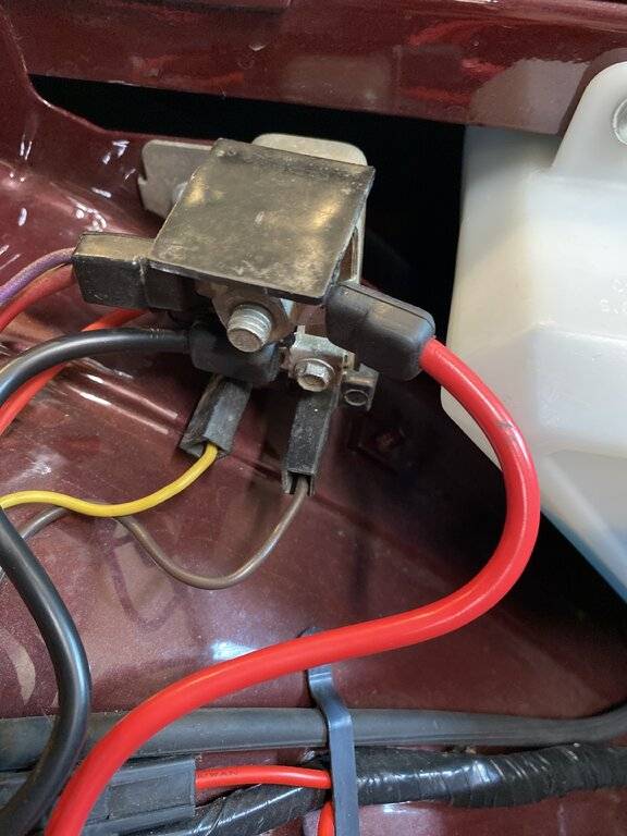

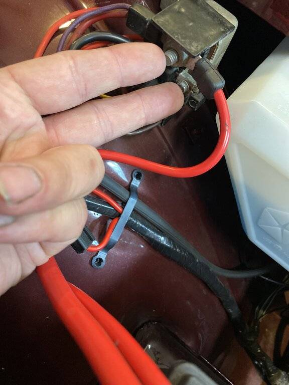

Make sure you are in neutral or park. Maybe put E -brake on as well. Contact these two terminals with a screw driver or heavy 10 gauge jumper. Your remote start tool is likely to have to small gauge of wire. In this case you are totally bypassing the ignition switch (will crank with switch off), starter relay, and NSS.
View attachment 467551 View attachment 467552
If it cranks it is not the solenoid. If it doesn’t crank it could be loose starter terminals or bad starter solenoid. If it does crank It could be the relay, NSS or ignition switch.
Had this happen about 30 years ago. I was able to tug on the main power feed from the battery to the starter while jumping the relay. Don't pull hard or you will yank the terminal off the end of the wire. I was able to start the car for months this way. The good old broke college student days...
Eventually I pulled the starter and took the solenoid apart. The copper terminal shown in one of the above photos had a large semicircle worn out of it where the solenoid made contact when you turned the key to start. If you can find a solenoid rebuild kit it's a simple thing to rebuild. I bought another starter due to time constraints.
