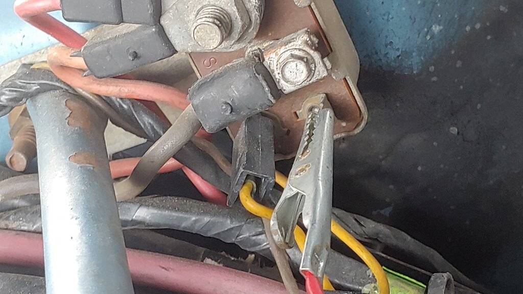

Yea but he said "It starts fine several times around town." and "One time, I managed to crawl under the car and screwdriver the starter selenoid and then I turned the ignition key and the car started and continued to start for another 12 starts or so."While that is the usual problem with the starters, and I have changed them, since he "jumped" the contacts on the starter, which engages the solenoid that drives the drive gear into the ring gear AND makes the contact that turns the starter (with the contact above), he actually proved that was OK and working properly.
If he jumped the contacts on the starter and it DIDN'T work, yep, that's probably the culprit.
