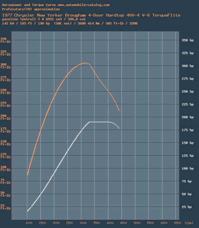

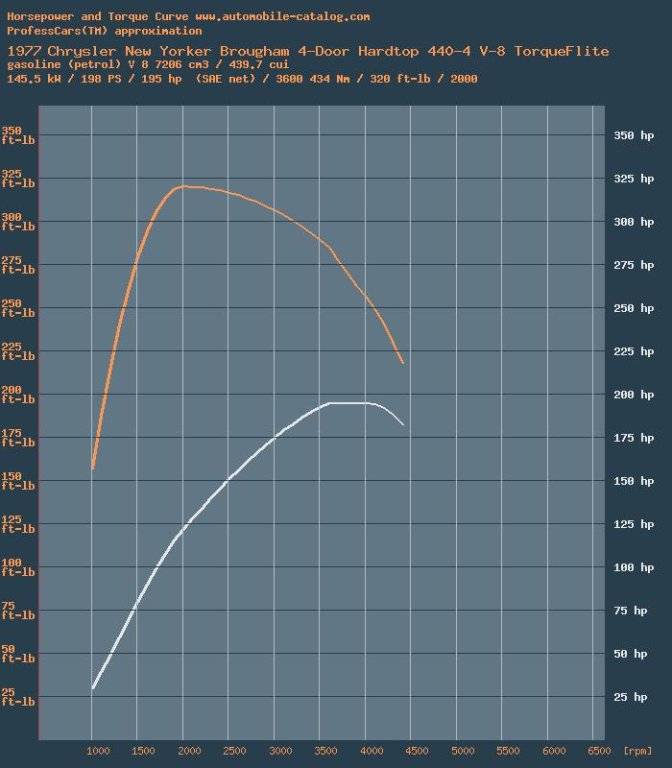

Here's the horsepower/torque curves for a '77 NYB with either a 440 or 400 (courtesy of automobile-catalog.com). As seen here, the 440 would have more low end torque, but the 400 seems to catch up after around 3,000RPM.
The factory power specs are tuned for emissions compliance, with lazy timing, overly lean carburetors, and a variety of vacuum actuated emissions junk. You could actually get much better performance just by tuning them right and getting rid of the emissions stuff.

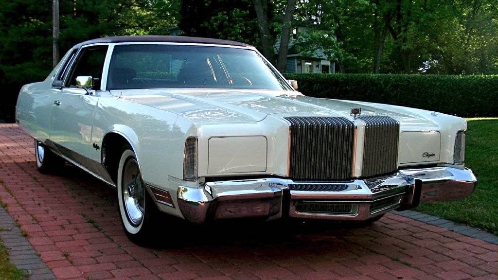

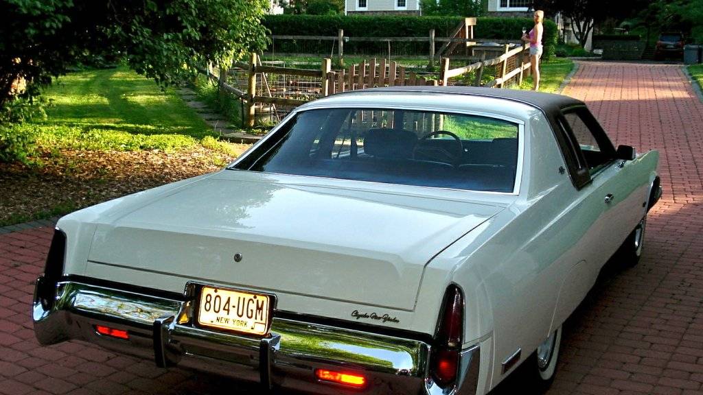

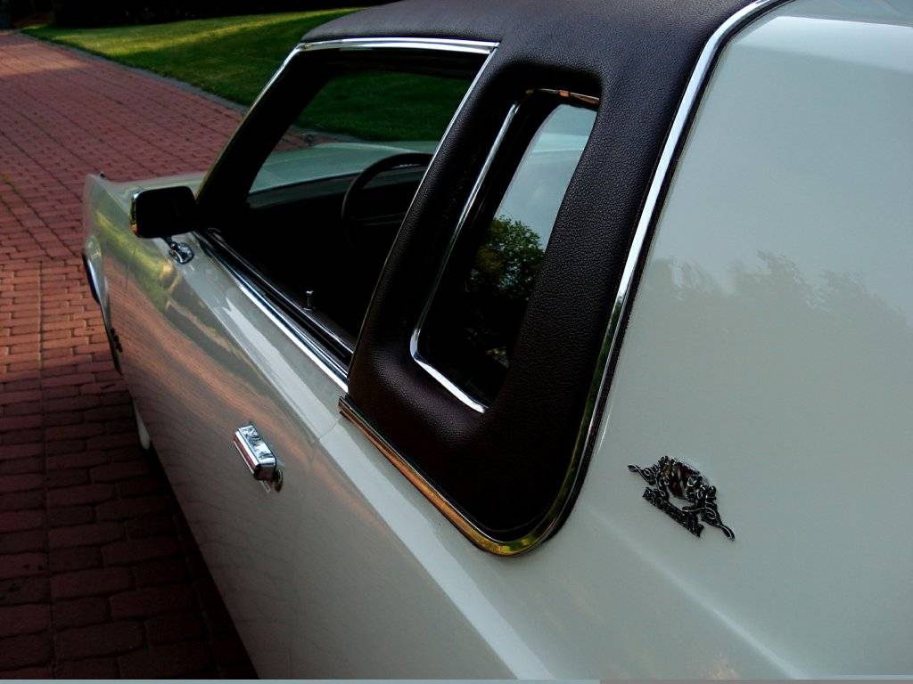

Here is what she looks like, I did other minor mods, message me if you need more info on the mods.
