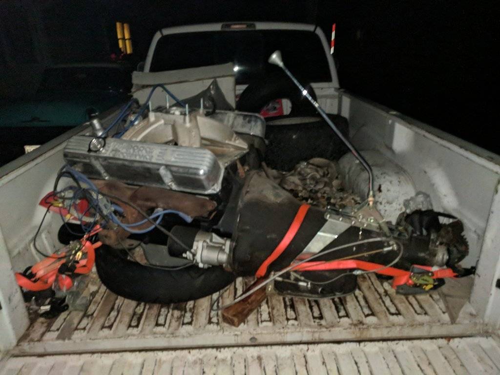

Well, I just got back from picking up the engine. I took the approach that the engine was a core, and the seller was cool with that. I paid $850 for the engine and trans (think it came out of an RV, it's got a short tailshaft, but not like I've seen) and an extra $100 for a 3 core aluminum radiator. He threw in a couple extra alternators and a bunch of misc parts. I'll take the intake off, probably seap to a set of 452's I have laying around, and if the cam is toast, I have one waiting to go in. Considering the cheapest running 440 i came across was $1000 and an hour and a half away, in an RV that the driveability was in question, and the hassle of removing it and getting rid of the hulk of an RV, I think I did ok. Turns over, nice and firm. Might get the Dart mobil this year yet.
The shifter might actually find it's way into my 72 W200, maybe.
Well bought.
If you know what your cam is and like the grind, I'd go ahead and swap it in now. Why put it in your Dart and find you don't like it?

Agree 100%. Be a couple days before I can tear into this and see what all it has.
I think the 413 may have came from a motorhome also or at least the exhaust manifolds did.

Sitting as she is, you could do a leakdown test easily, and if you're brave... you could block up the engine and try a compression test.

I cut right to the chase and asked what he was thinking for price and I heard, "I have over 2 grand into this" and I just repeated what a coupke people said here, its going to have to be tore apart and gone through, and I'm basically buying parts. The shifter is almost $300, the intake another 300, carb almost 400, Chinese radiator 150, air cleaner 50, so I got my moneys worth. Now to see what shape it's in.
