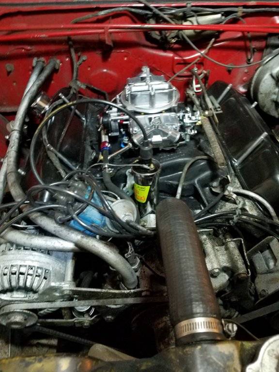

WOW!!! Information overload right here...I really thought a couple grand and bolt on and roll, I am definitely going to reconsider all this I just put on my Quick Fuel 750 on the stock intake maybe I'll just look for an upgraded intake and keep it simple, I really need it to be bulletproof reliable as I want to lug my lil camper around and be a cool old dude..lol thanks guys I really appreciate the lesson I needed a reality check for sure!!

I've heard good things about Quick Fuel. I don't know what your current gear ratio is but if you plan on dragging a trailer around and also want some pep you should look into gear in the 3:23-3:55 range. Keep your stock intake for now.
I would have to assume it is all stock right now as I haven't touched anything under there but the shocks..That is down the line I was told I'd need to upgrade or rebuild the tranny and rear end to be dead set reliable.

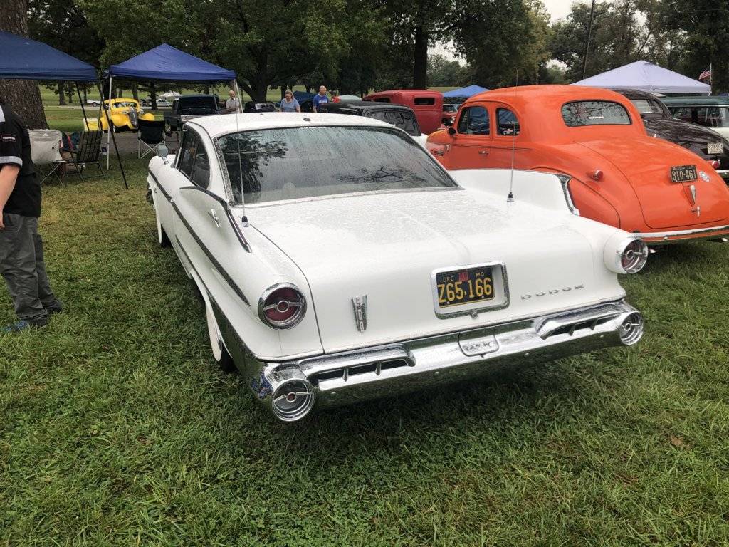

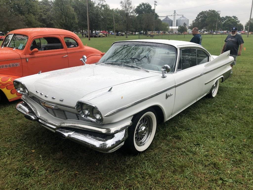

I think that would be a 361 cross ram for 1960 rated at 310 horses with the D-500 package. There was a second D-500 package offered for police use that had the 383 cross ram setup at 330 horses. Adding the FItech setup would probably have improved performance as the cross ram setup with carbs were very difficult to keep tuned and balanced.
Dave
IDK If the car was originally a 413 or not but that’s what this motor was. The owner wouldn’t tell me exactly what was done but I would consider it more than mild but not quite hot. The owner told me that it ran very very good.
