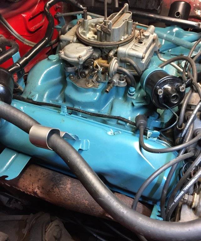

Does anyone know if Holleys were original to some of these. Nothing tells me for certain. Would it be on the build sheet?
It’s in the drivers side corner...pay no mind to the grime I have yet to clean.I think he needs a ballast resistor too....

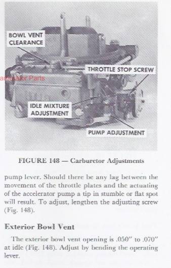

Thanks! I have the car out and have been making some adjustments the past couple days. I had to not only fix the bowl vent but also start over with the idle air-fuel mixture screw positions. I still cannot get it to idle before it stalls out. I will check further into the specifics for the carb.Your bowel vent is way off adjustment.
Check your carb # and correct manual for proper clearance.

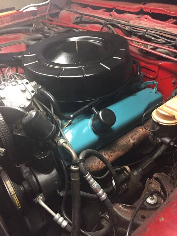

Glad you got them in good order!!!! If any other dodads needed, let me know.So I received the bolts from Newport 66 and got the valve cover installed! Connecting up the coil next
