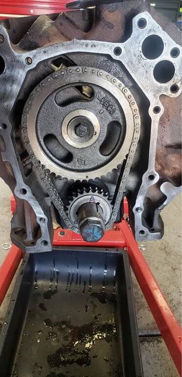

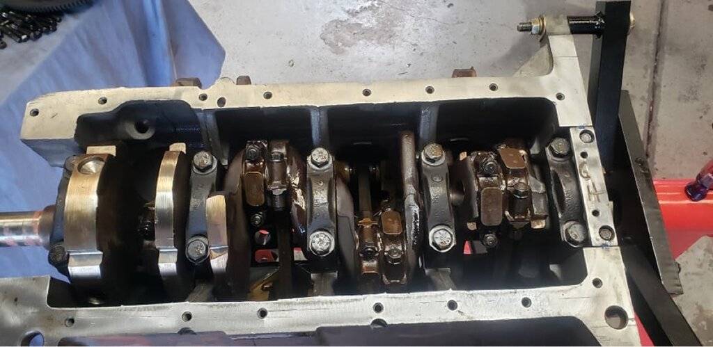

Well I now have an assembled rotating assembly. And surprise of surprises, I wound up getting a forged crank 440 and not a cast one!
Wow who torqued the **** out of the cam bolt and bent the washer, or maybe just a optical illusion.
