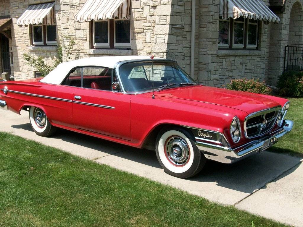

Oooo, the ever powerful Chrysler 331 - someone dropped a hemi in that car!
Seriously, I have a complete set of wheelcovers just like the ones on this car. Came off my the '62 New Yorker I owned when I switched wheels. If anyone would be interested in buying them, shoot me a note.
