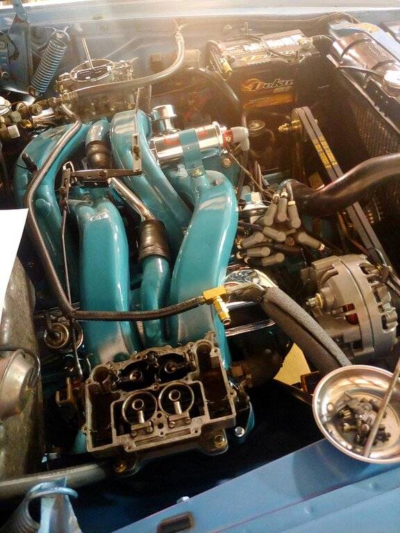

Here's the sole pic I have.
Came from a car listing I saved off ebay.
Most crossram car listings don't show this area of the car, I presume most folks don't realize it's a specific detail of the car.

If I were doing a crossram car and was lackign those parts, I think I'd consider converting it to manual brakes.
