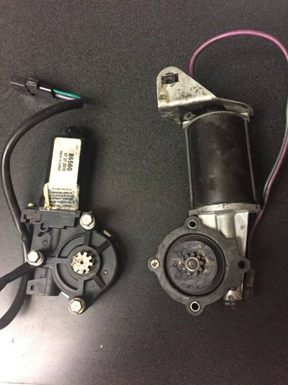

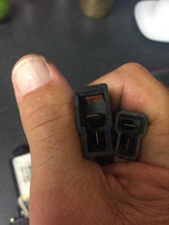

I believe the power window motors can switch side to side but wing vent motors are specific to each side. Also just FYI I have found that newer, like 80s and early 90s New Yorkers with the almost vertical back window and smaller motors will also work with the correct plugs spliced in the line..

Hi, From what I recall on the resto of my '64 Shriner Imp convertible, yes, the fronts are the same side to side. I checked the '64 parts book and the same number appears. A different part number shows in the '65 book and I didn't check the '66 book. Go here for many manuals- MyMopar - Mopar Forums & Information and you will find the site is great for free manual downloads. In the '64 book go to page 23-287 for a clearer understanding. I am not sure about the backs and fronts being alike....the best way to check is obvious...remove them. The removal of the rears in my Imp is a PITA because the seat has to come out. My rear lifts are slow, the fronts not much faster. Hope this helps a little!

There are left and right and they are not interchangeable from side to side or at least that’s how they are in my 67.
