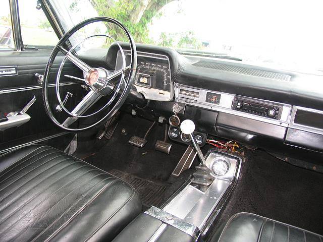

If you dont car about hacking up the dash trim the radio goes in you can do this. to put a newer radio in the car. Way cheaper than the radio conversion. It's really up to your tastes and budget. That is my 65 Sport Fury in the picture below. I however for the build of this car sourced a radio delete plate and will eventually have the ash tray removed and the dash frame modified to accept a large touch screen radio. Again all about your tastes and budget.

Kelly great looking interior.. wish ours was a bucket seat and console 4 speed car.
