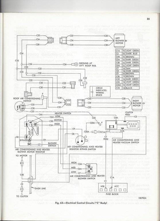

I received a 65 Monaco in boxes and am in the final stretch of things here. I am trying to get the A/C and heater controls wired up and am not having much luck. If I hook it up how the wiring is comfortable, then the blower motor runs at all times but switches speed. I have found diagrams for the wiring but only for heater only cars and the connectors and wire colors are not correct for my application. If anyone could direct me with pictures of the back of their heater & a/c controls or a good wiring diagram of the heater and a/c system that would be great. I am about to remove the controls and figure out how everything is supposed to work and make my own harness. I have three terminals on the resistor for the connector from the fan control switch along with 3 terminals below those. There is a switch near the vacuum motors that has a 2 wire connector coming off of it shaped in an L pattern. The heater a/c control head has a 3 terminal connector on the driver side of it which is for the blower motor control, then there are the vacuum lines and then 2 terminal sitting horizontal 1 on top and 1 below and then there are 3 terminals on the passenger side all of which are vertical and spaced a little out from each other. Thanks in advance for any help.
