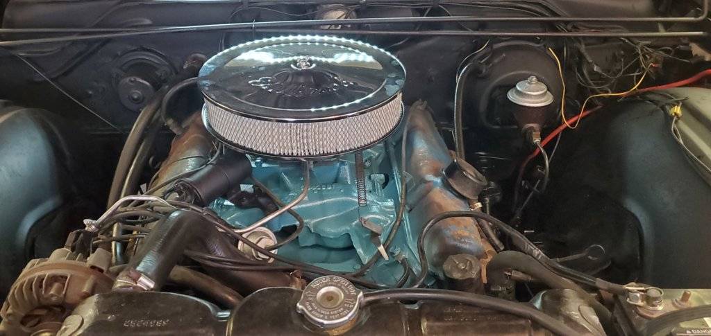

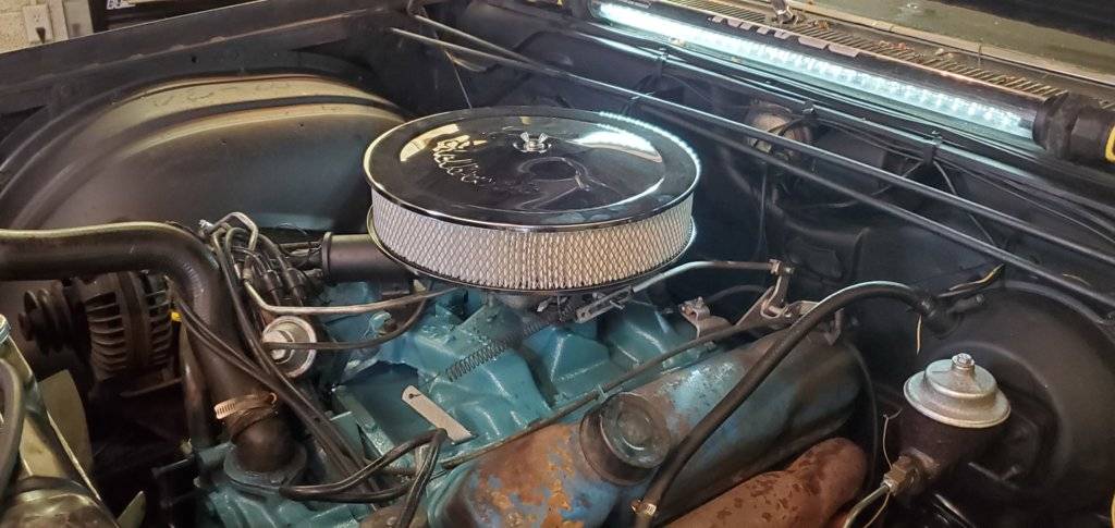

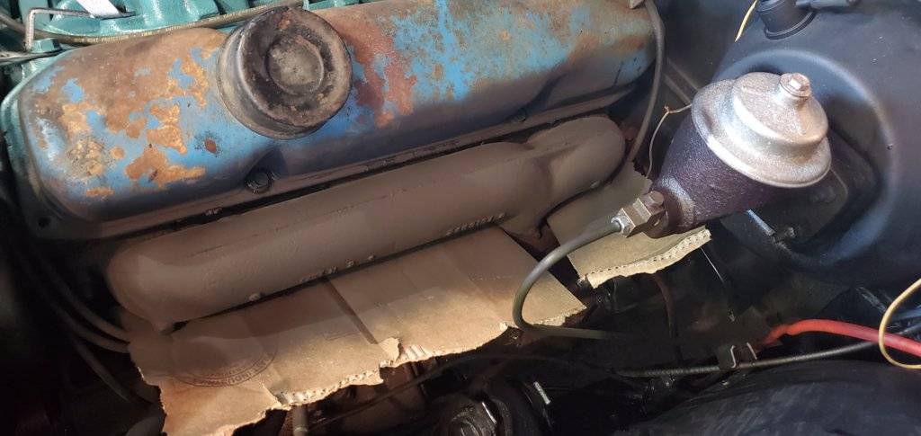

Still smoking though...not sure- exhaust manifold gaskets or burning off from sitting so long....

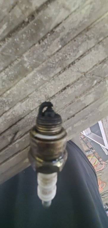

The side smoking had the worst spark plugs..again, not sure if it was from sitting...
Fwiw, shampoo the engine and replace valve cover gaskets.
Years of oil prolly leaked out and onto the engine and manifolds.
Eventually it will burn off lol
That's what I was thinking. Thx.

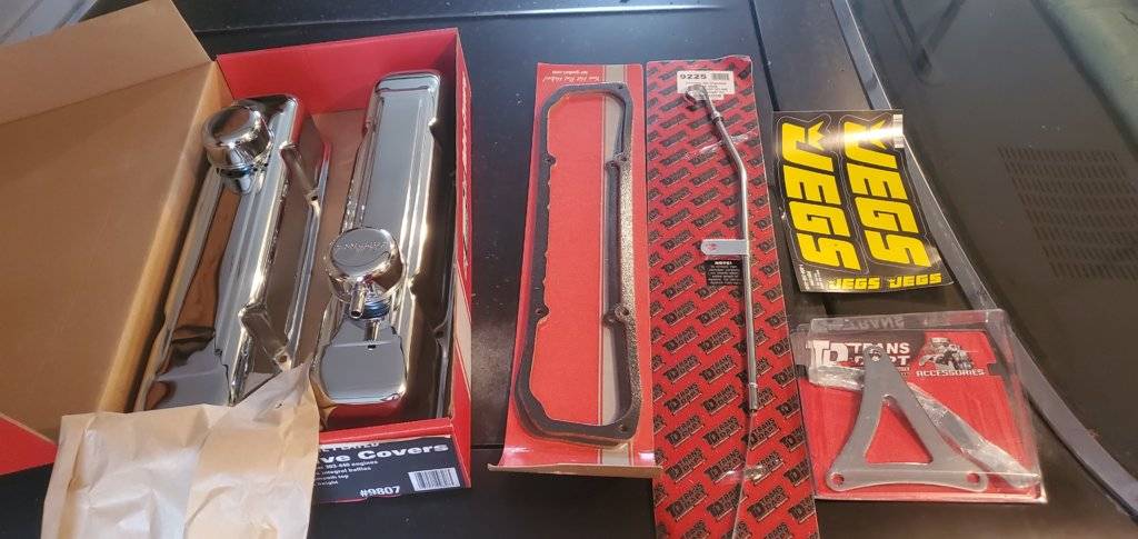

New valve covers, gaskets, hardware, ect. Ordered.
New fuel tank, sending unit, straps, ect. Ordered.
Chrome dip stick and alternator bracket ordered.

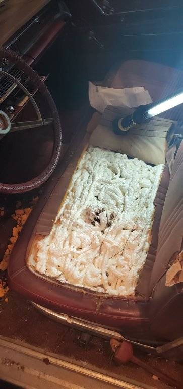

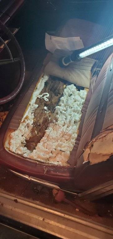

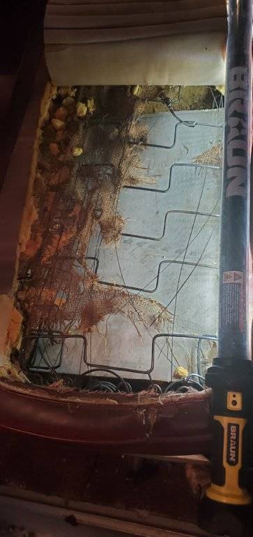

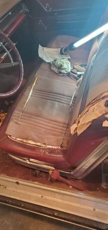

Some work on the drivers seat before installing the seat covers-
