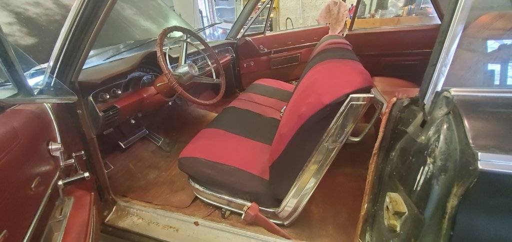

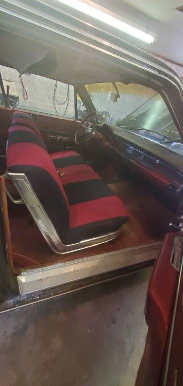

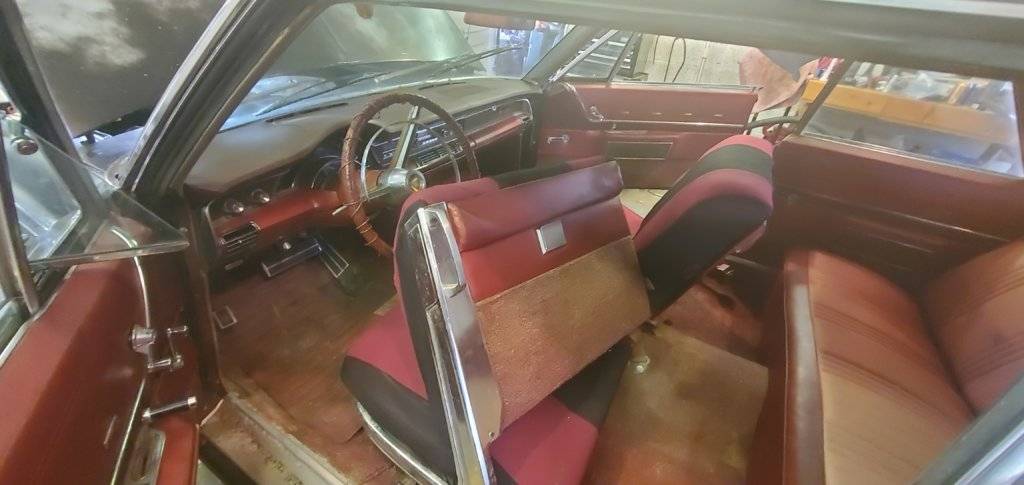

Kinda cold in the garage today...warmed up my day with installing the seat covers correct. Fits like it's supposed to be there after loosening some screws and back panel. Gonna order another for the back seat for sure. Not bad for $30 shipped-

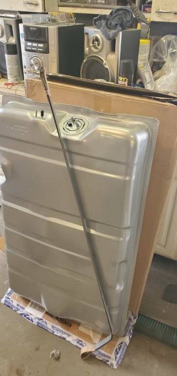

Sending unit retainer ring fit very nice.

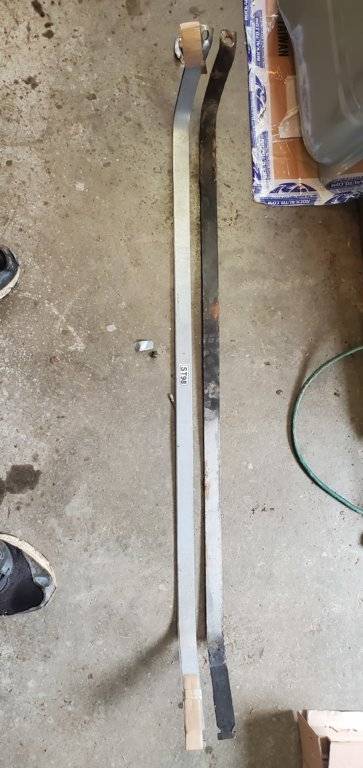

Straps, however, are not exact. Same total length, and same mounting bolt and bend at the sending unit end- but strait, missing bends at the gas filler side.
I will be removing the old tank and replacing with the new one tomorrow. I will match up the bends in the straps, and get a side by side comparison of the new and old gas tanks.

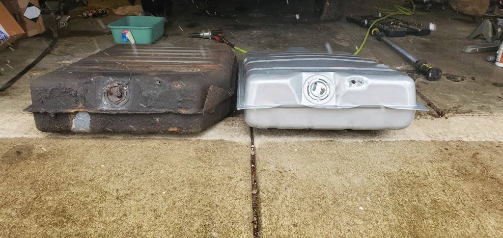

you'll know for sure once it goes in, but the right side with that angle on the original might be an issue depending what it was cut for.
If it's not... you probably picked up an additional 1/4 gallon of capacity... LOL

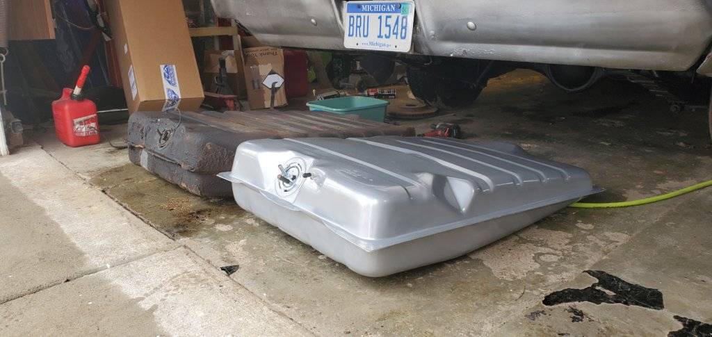

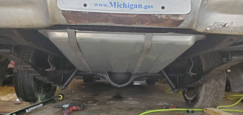

The new tank is smaller- 18 gallon.
So far measurements look good, but like you said- instillation will be the truth...

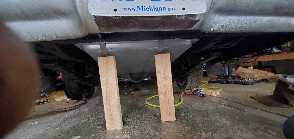

Gonna get it installed after I feed the kids lunch and start dinner. Fingers crossed.

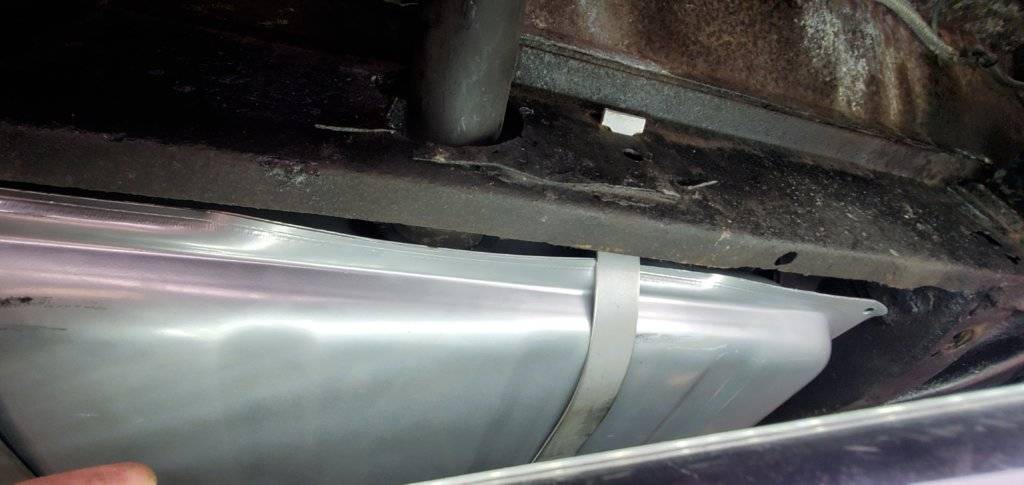

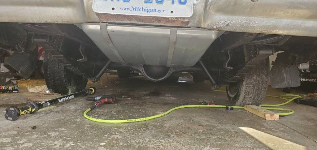

I wouldnt call this an "exact" fit, but it's a good fit. Hardest part was getting the bends right at the rear on the straps. Everything lined up "close enough" to perfect.
I will be removing the old tank and replacing with the new one tomorrow. I will match up the bends in the straps, and get a side by side comparison of the new and old gas tanks.View attachment 368447 View attachment 368448

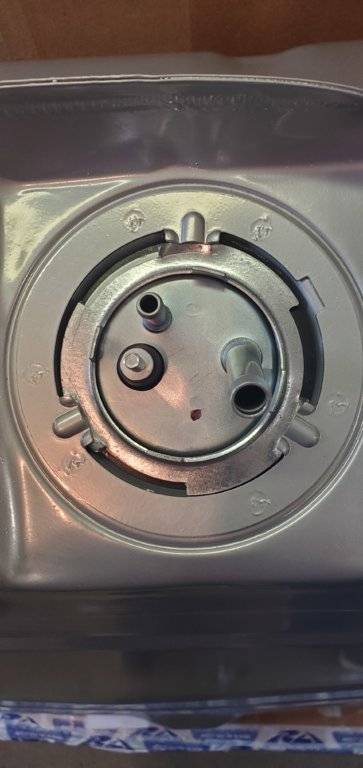

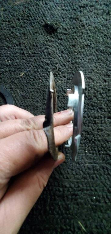

Did that ring press well on that sender? The aftermarket ones are thinner. They don't press enough on the seal
Centered with the frame perfect for adding dual exhaust.

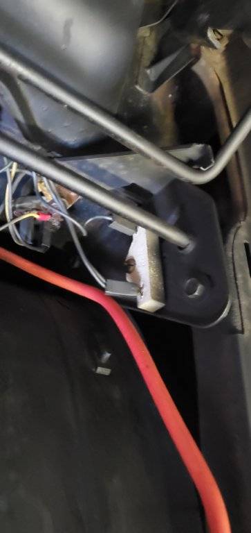

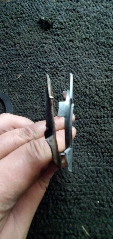

Also, to help get the bends better-
Just realized I used the one that came with the sending unit, and not to tank...
The one that came with the sending unit was super tight. Thinker than my stock one after it was cleaned for sure. The gasket was nice too.
The one with the tank looks like the metal itself is plenty think, but the raised portion is not as high as the original-
