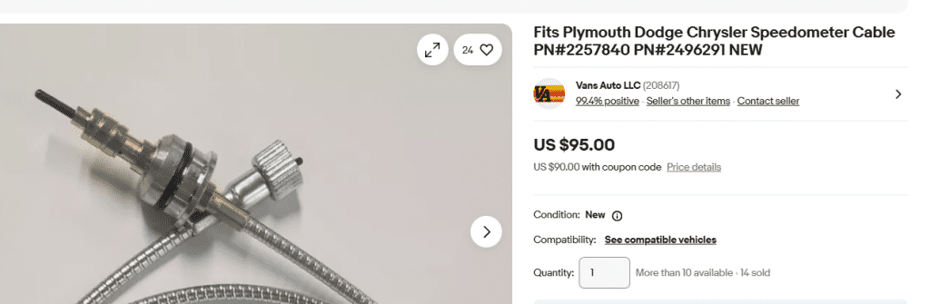

This is the correct one - note the end with the rubber o-ring.
Fits Plymouth Dodge Chrysler Speedometer Cable PN#2257840 PN#2496291 NEW | eBay

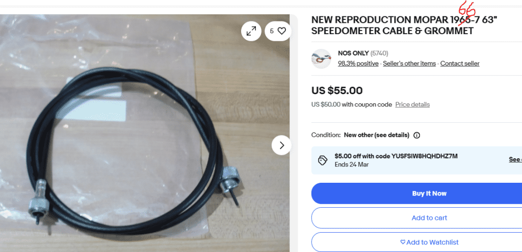

This one is INCORRECT - note the regular type end. WILL NOT WORK on a 65 transmission.
NEW REPRODUCTION MOPAR 1965-7 63" SPEEDOMETER CABLE & GROMMET | eBay

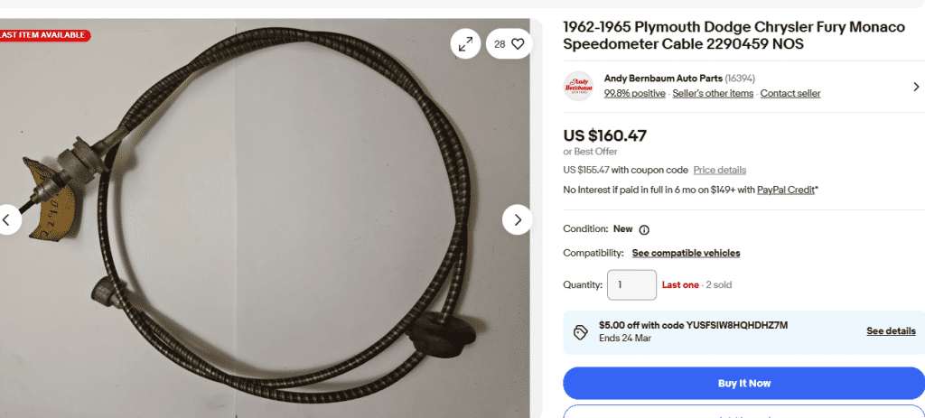

Here is an NOS 65 one - more expensive, and possibly no better than the one from VAN's in the first link, however, Bernbaum is a respected dealer in NOS Chrysler parts.
1962-1965 Plymouth Dodge Chrysler Fury Monaco Speedometer Cable 2290459 NOS | eBay

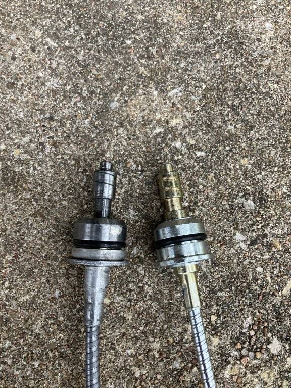

For anyone wondering why I did this:
Ebay listings disappear after a few months.
I currently have two 1965 C-bodies.
I am saving this thread for my future reference.
To anyone thinking 'those are selfish ulterior motives' - yes, that is correct.

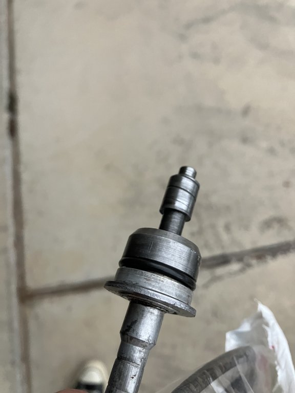

So just a follow up… the one from Vans is exactly correct for the 65 New Yorker. Looks like the original cable in every way (except shinier lol). Thanks to all of you who chimed in on this thread. I know that some of you mentioned having one made using the old ending from the original cable. I’d be happy to mail anyone that wanted it the old original end (or even the whole cable if you want) if you would just pay for the shipping.
Thanks again to every one
Kona
