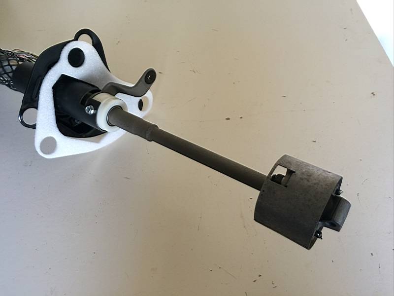

Screws? That would be easy. Mine is held on with this...
a royal pain in the *** to remove or install.
Thanks for the pics. As I look at mine, (and I'm just talking-- not going to do it), it sure looks like the lower coupler is unnecessary and could be eliminated. It certainly looks straight and it shouldn't have to telescope. Other makes sure don't have that thing, and just use a single rag joint to do it all. Why did Mopar do that? I am going to rebuild mine AND put a grease fitting on it. I'm a sucker for grease fittings...I'm thinking of putting them on my front wheel hub dust caps too.
I don't think Chrysler intended the heat shield to be removed in the car. They probably just pulled the column and serviced it out of the car.
My 69 didn't have the coupler along with the rag joint and I found it easy to take apart out of the car.
This is the type of project where I see someone fighting an hour where they could have pulled the column and done it faster.

Your heat shield is a very different design. The earlier design is fussy because there are small Philips-head screws and no easy way to get a screwdriver straight onto them. Then when reinstalling you also need to hold the heat shield itself in place.
My Windsor's engine has Edelbrock heads and used to have HP cast iron exhaust manifolds before I replaced them with headers. The only way to access #7 plug was to remove that heat shield to make room, and then climb underneath the car. NO WAY would I be ok with removing the steering column every time I needed to access #7 spark plug! Having to remove the heat shield relatively often is why I came up with the idea of notching the holes to make it easy.
I was considering eliminating heat shield, but I'll put it back on....I'm wondering, though, if it's really a heat shield or a dust cover? Unless mine was clocked wrong, it only covers the top like a hat rather that winding all the way around the side to the bottom which would protect it from all the radiant heat from exhaust. I may roll mine around if I can to make it hang on side of the column between coupler and manifold.
Definitely a heat shield to block heat from the exhaust manifold. Perhaps yours was installed incorrectly? IIRC, in addition to the 2 screws, there should be a small tab on the end which fits into a hole on the column to indicate the correct alignment.

Now I'm really wondering if mine was clocked wrong. Mine came off easy...just three screws across the top. Am I missing something? My shield is just a half-circle.
Seeing that mine is on with a Corbin clamp, I have mine clocked so the opening is at the 9 o'clock position, looking from the front.
